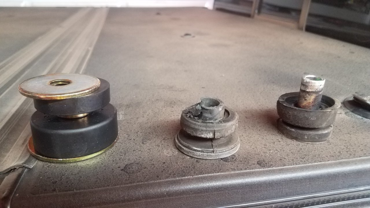

    #98
    Lord Humongous
    Lord Humongous The Ayatolah Of RockNRolla
    Jan 14, 2016
    #174960
    2,317
    AZ
    Inferno 3rd gen trd offroad 4x4
    https://www.tacomaworld.com/threads/lord-humongous-gigahorse-build.436524/
    Thanks for the info. I just installed them. Mine had a metal nipple but also had a thin layer of polyurethane and another inner metal sleeve. Front end noise is gone!!!:yay:
