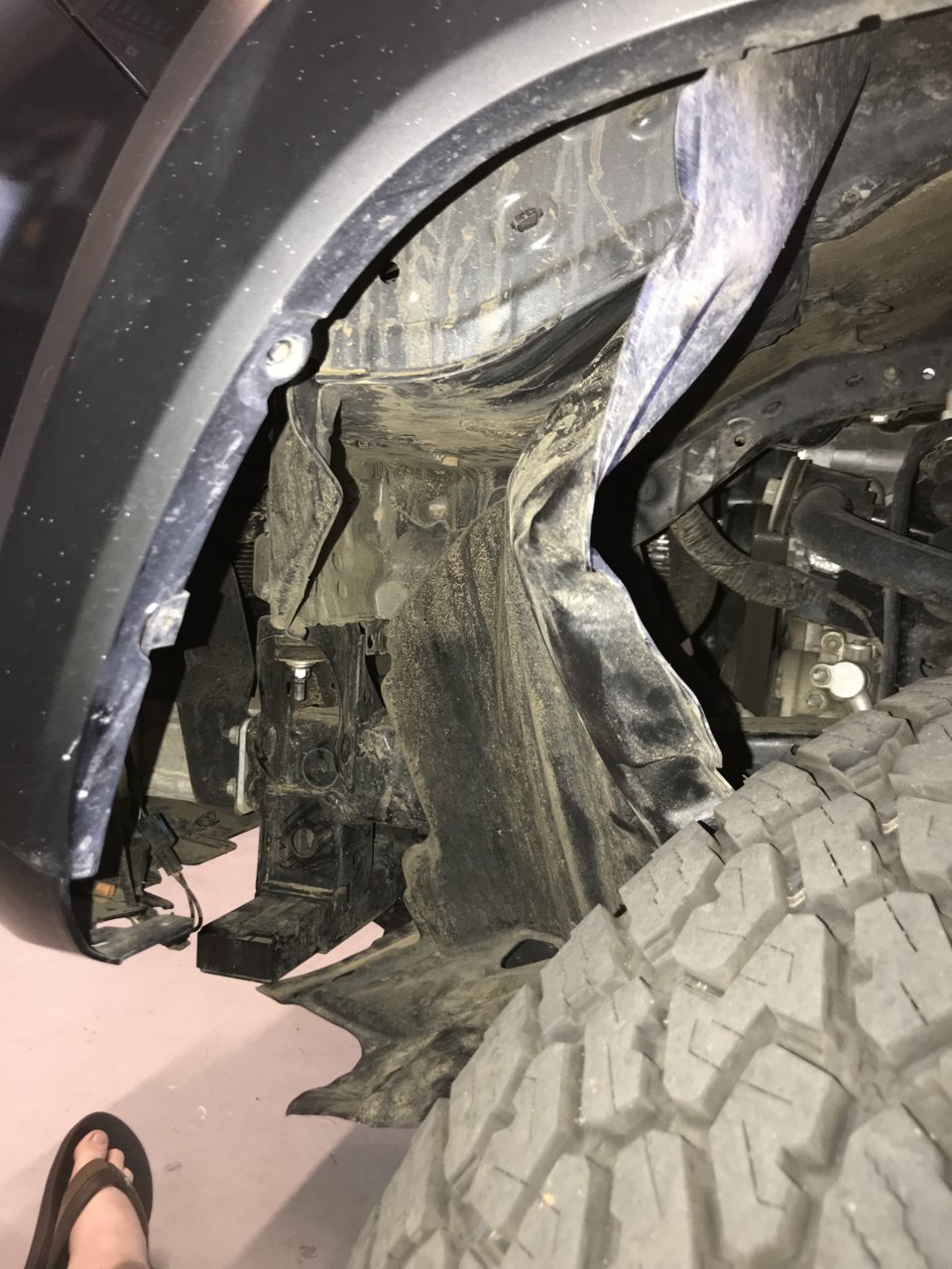

    Bushing Install:
    Fold back the fender liner skirt.

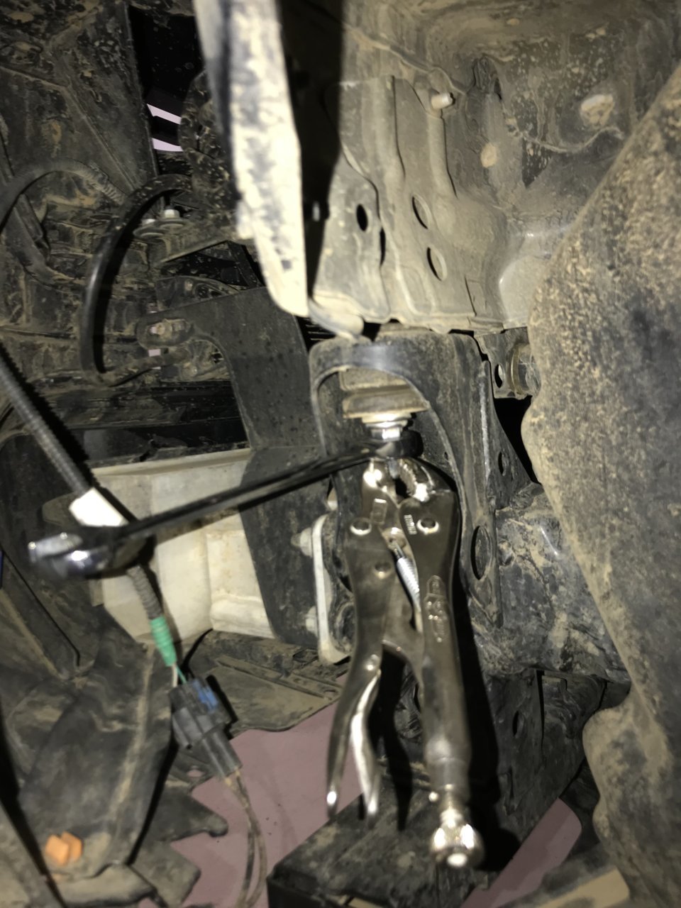

    Use a pair of vise-grips on the bolt while loosening. Ratcheting wrenches are priceless!

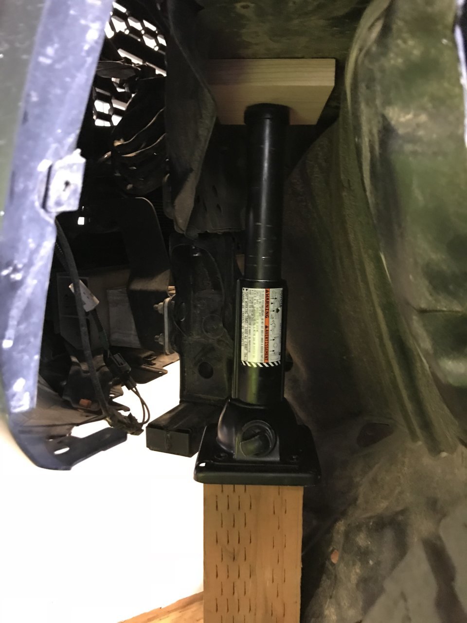

    I was able to use the factory jack ontop of a 4x4 and put a wood spacer to help distribute the force. Probably lifted about an inch.

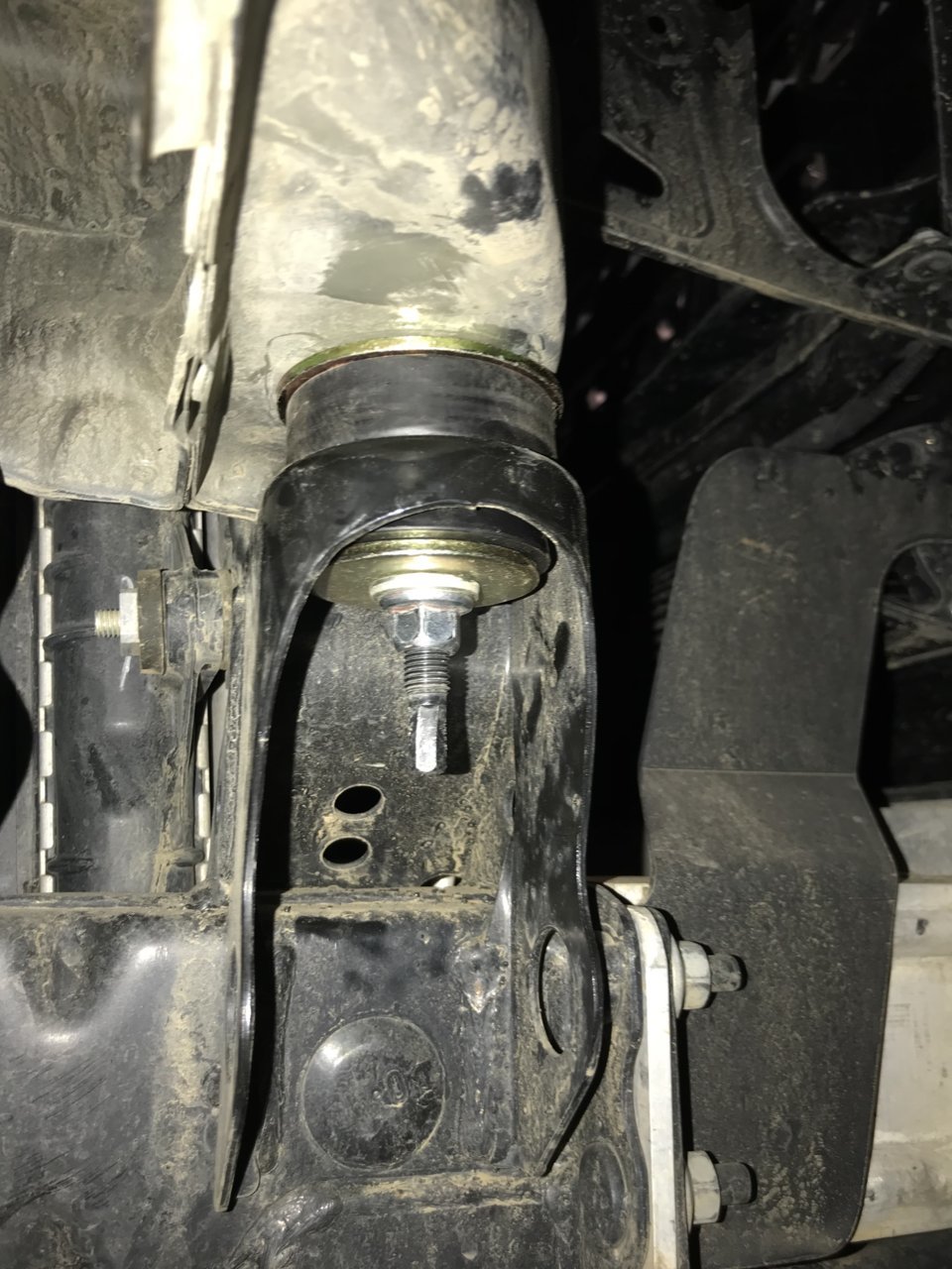

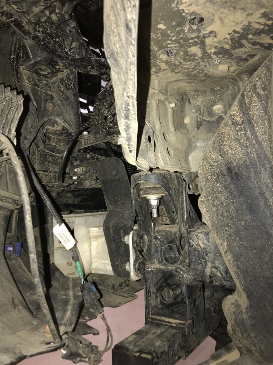

    Installed! My bigger bushing did have the metal sleeve; it can be removed and then inserted again from the bottom. Don't forget the stock washer!
    My bushing orientation:
    BODY
    Big washer
    Big puck (nipple down, with both sleeves)
    FRAME
    Small puck
    Small washer
    Stock washer
    Stock nut (torqued to 35ft/lbs)
    No more creaking and the body lift is noticeable!
