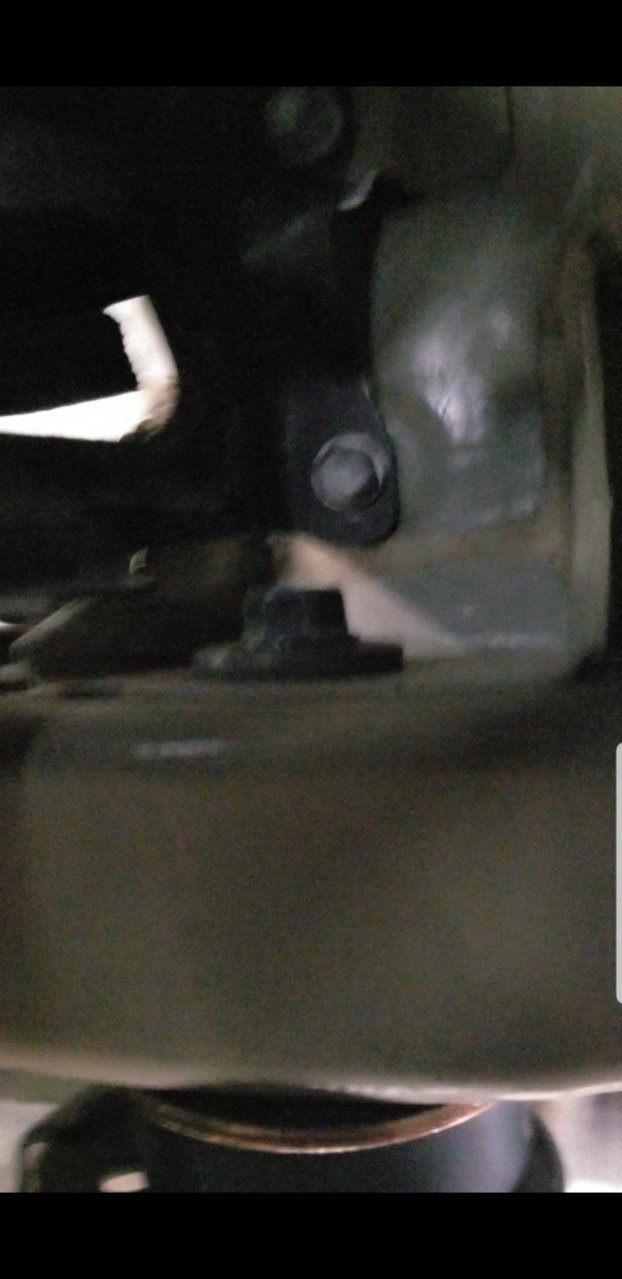

    Good news and bad news on mine. I got it done, and mine were just as bad as the others on this thread, but test drive around the block and that wasnt what was causing my clunk unfortunately.
    Ran into some snags during the process but this thread helped immensely. Driver side didnt line up properly like others have stated but a pry bar worked great. It also helped to be on a level surface. I also got a pic of the top of the body where the head of the bolt sits. This is the area we can't see while working down there and maybe being able to visualize it will help others I know it would've helped me. Screenshot_20190109-165603_Video Player.jpg

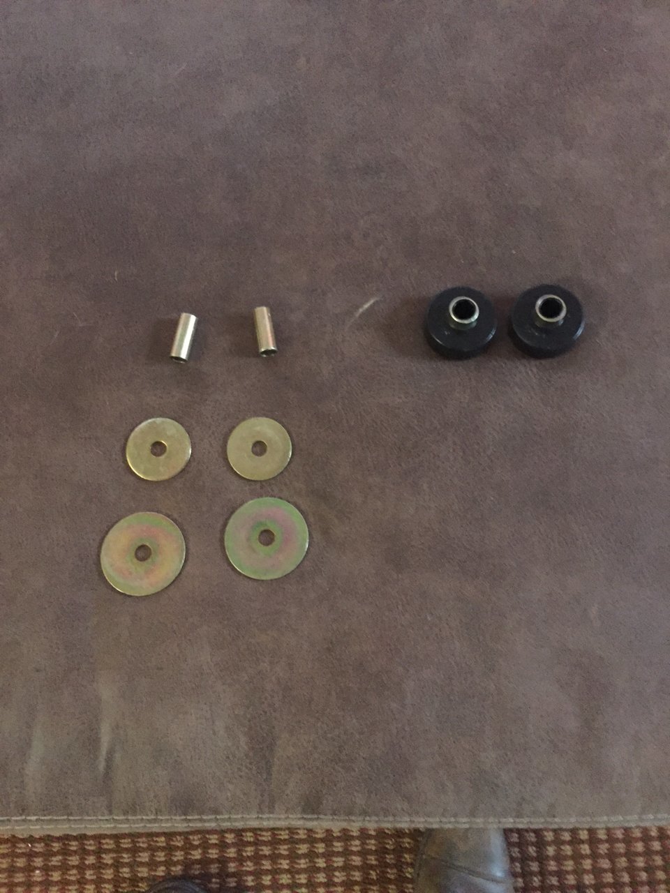

    2710EE57-CEBF-4CE9-BA80-02ECC54FBD92.jpg Hey guys went to go do this fix today on my 17 off road today.... thought i had the right kit but I believe im missing 2 bushings. Can anyone tell me? I dont have the 2 bushings with the nipples.
    SilverII likes this.
  18. Feb 17, 2019 at 1:13 PM
    #158
    Markc1024
    Markc1024 Well-Known Member
    Sep 17, 2015
    #164491
    545

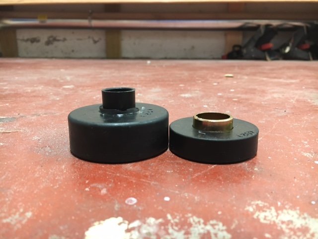

    Looks like the one you have is for the top - with the sleeves (nipples?) that extend down through the mount. I think the nipple you're referring to is just bushing material that extends into the sleeve. For mine, which I recently purchased, they are both on the top bushing. It should be the same diameter as the larger washer set. If so, you're missing the lower bushing that doesn't have an integrated sleeve.

    This is all that came in the bag. I figured I was missing something when i took the factory two bushings out and only had one to replace them.

    1BB803E0-7421-4DB8-924F-93309439F3EF.jpg Im missing the left one?
