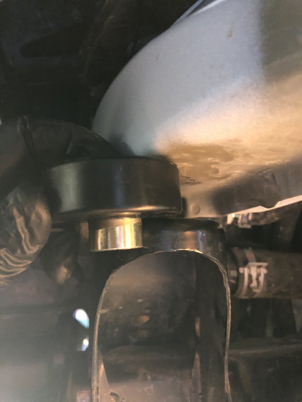

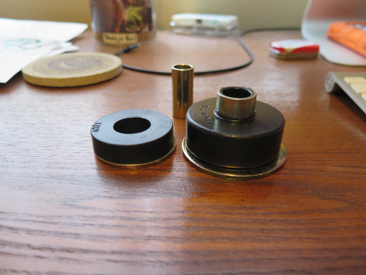

    On mine, the metal sleeve is installed over the nipple on the left (larger one). It's not so important which one as they mate together. That just leaves the smaller one without nipple or sleeve. Which one you're missing can be determined by how they match up to the washers - large one or small one?

    Hopefully this helps - I've only installed one side so far.

    I didnt get a small bushing in my kit. Just the big one with the sleeve in it ...... wtf

    You need to lift the body portion up enough to squeeze the bushing in. The sleeve will then sit within the hole in the mount.
