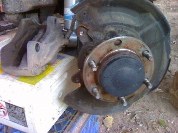

    Just thought I'd post a pic of how I supported my caliper when I was replacing one of my wheel studs.
