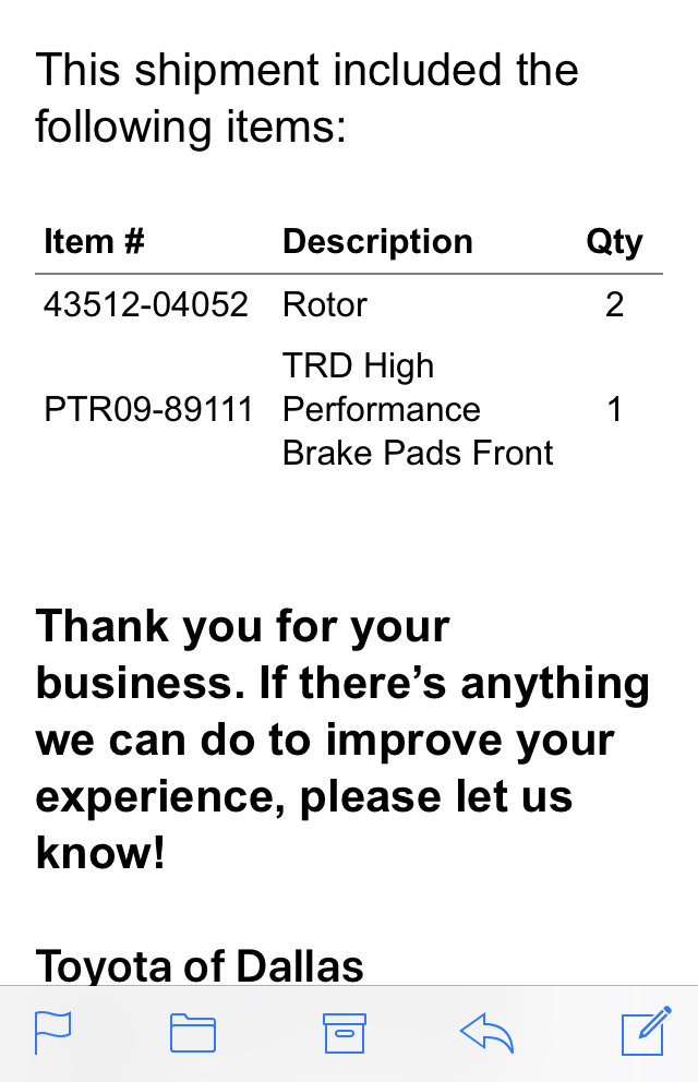

    I just put factory rotors and TRD pads on. Works great, was under $250 delivered. Here are part numbers.FF97556E-1DC4-470A-B8E2-A1067B041CCE.jpg

    wow when I called Toyota the other week they said no one in north america had those pads in stock, cock suckers.
