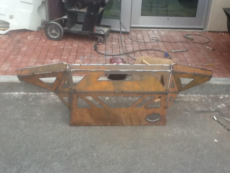

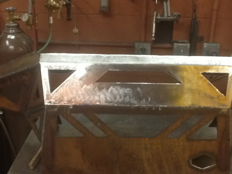

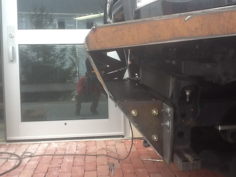

    Here are some spy pics :spy: things are coming together almost perfect. A couple things needed to be changed because I shouldn't have made templates out of cardboard. Too flexible... Oh well there's always next time! Just have to roll with it.
    ad63c7a5b2649f9c8c825bd3c0382ed7_zpsf987_93b75445df433da30f24fb896ce59f45872b918a.jpg
    d5f55d93160a766ca6fe58013a36156c_zpseeec_30c627df41e5e0eadee73a6744877d0477b8f490.jpg
    http://i81.photobucket.com/albums/j212/flyboy_co2/0c215446ffec6d0db85afd0c77e23d39_zps6118757d.jpg[/IMG
    [ATTACH=full]1785374[/ATTACH]
    [ATTACH=full]1785378[/ATTACH]
    The pace I'm going at now I might have this thing prepped and ready to paint for tomorrow. Because the tig can't be moved... I'm using a Lincoln mig to quickly tac it altogether and then I'll bring it inside to tig it all together.

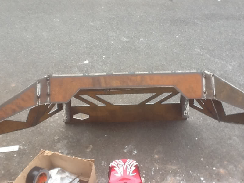

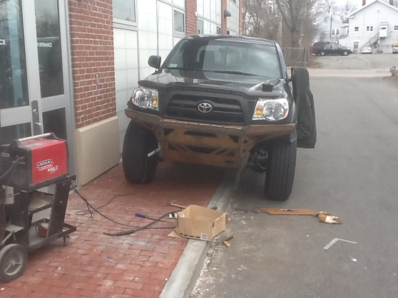

    5ab3887a1dd95b5a1bf2fa97e1206644_zpsdef0_2a9184792ad34fdfb732896f435f7f8466230633.jpg
    Finished tacking it up! Taking it off and going to finish up those welds. Then let the sanding begin...

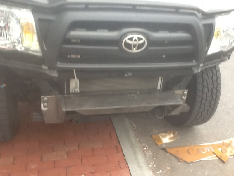

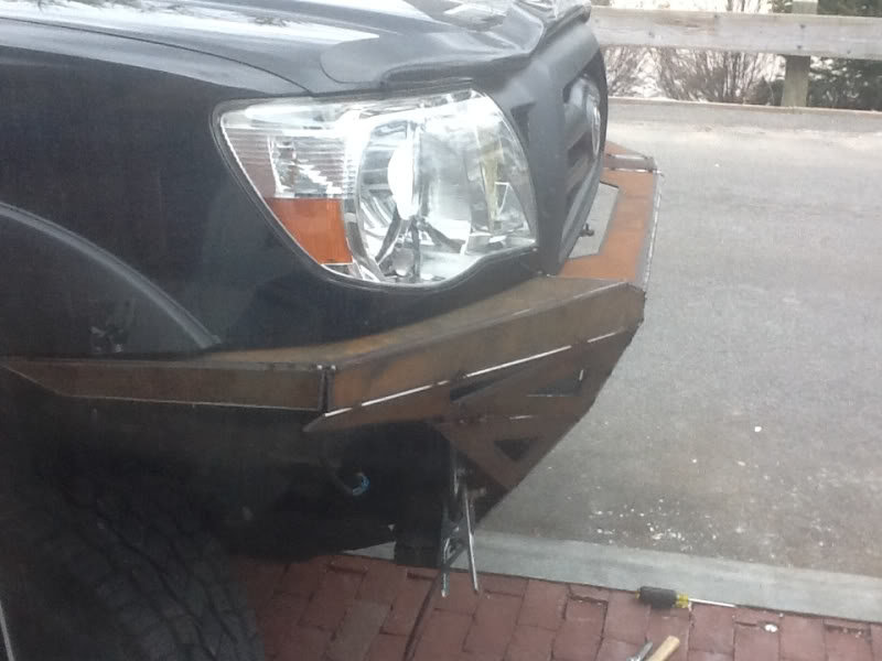

    6a7aebd5f8d052bed9212aa271c1e2d8_zpsc7f8_a71f9d6461d2a8e248f63416b95df237aedc6447.jpg
    74c2fc49ae61de5b6ade44c2f03dcfc8_zps7f2b_1c4bf2d68398278e7391cc3ef184e72ca069ca85.jpg
    7a49368d0ab0234e17a3e2fdab2c6d85_zpsb4ad_d0a479132fdaa472705a33c0c9f8fcf4f8e13961.jpg
    Luckily it weighs very little, so taking it off was no problem. I think I mis calculated the weight earlier... Oh well! I would guess the shell weighs in around 60lbs. There still are a couple things to ad to it so it will get a little heavier, but not by much.

    Cam, are those upper holes in the center hi-lift jacking points? Also, are you adding shackles and d-rings to the front?

    They can definitely be used that way! And I'll be adding some d-rings and shackles soon. Need to cut the pieces out of the 5/16" plate then weld it on. That won't happen till next week though.
