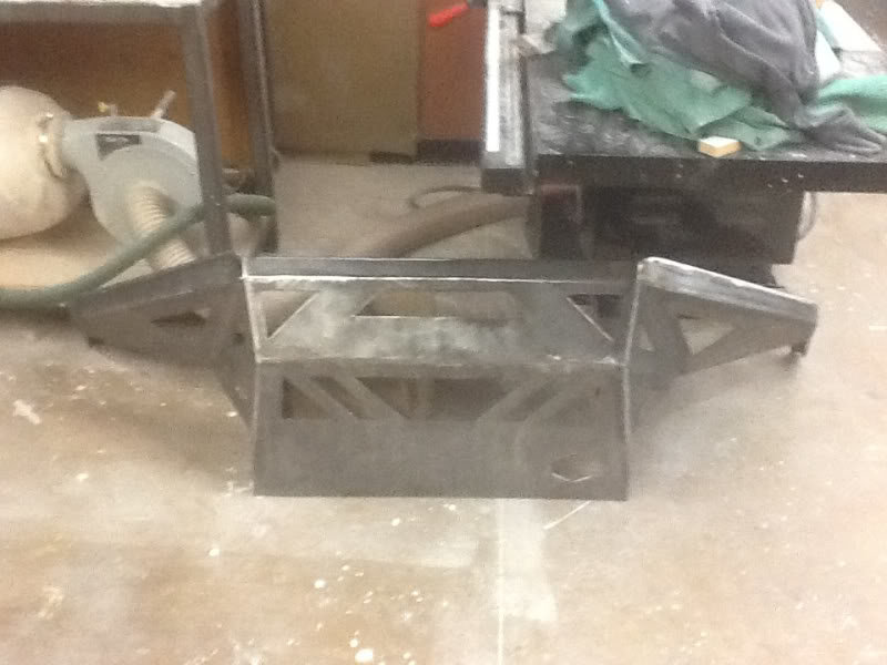

    Well got as much done as I could this weekend. Had a busy day with Easter and what not, so had a pretty late start on the bumper today. This next week is going to be nuts... So the bumper will have to be put aside until I find time to add the final touches. A few edges still need to be ground down and rounded out, and I plugged a couple deep rust holes on the surface. I'd say maybe a couple more hours of grinding the edges nice and smooth, and then it'll be ready for paint.
    Anyway this is how it sits right now, I'll pick this up later this week, sooner if I can manage.

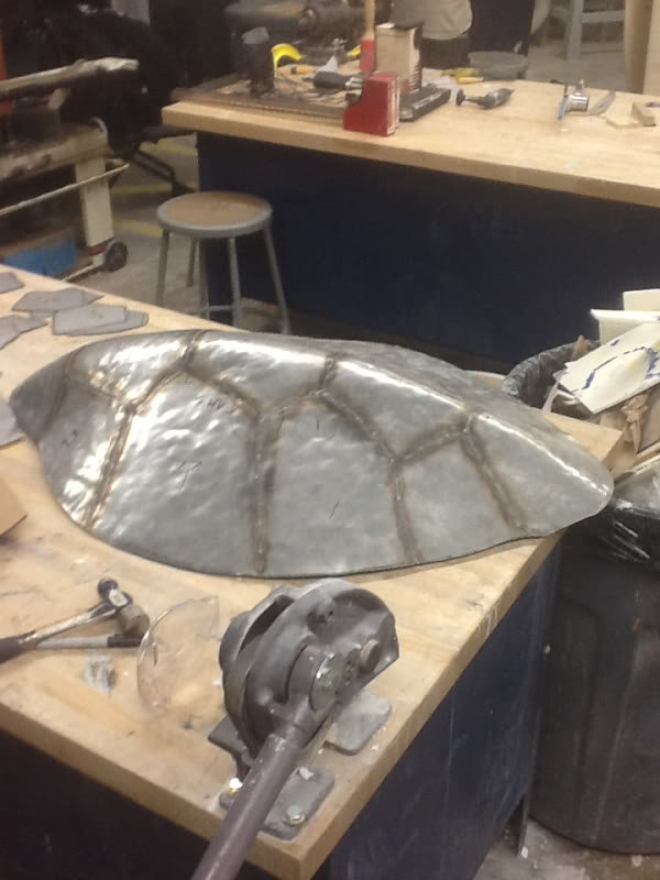

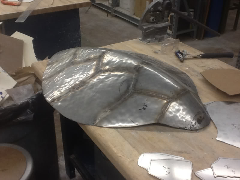

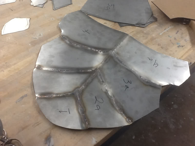

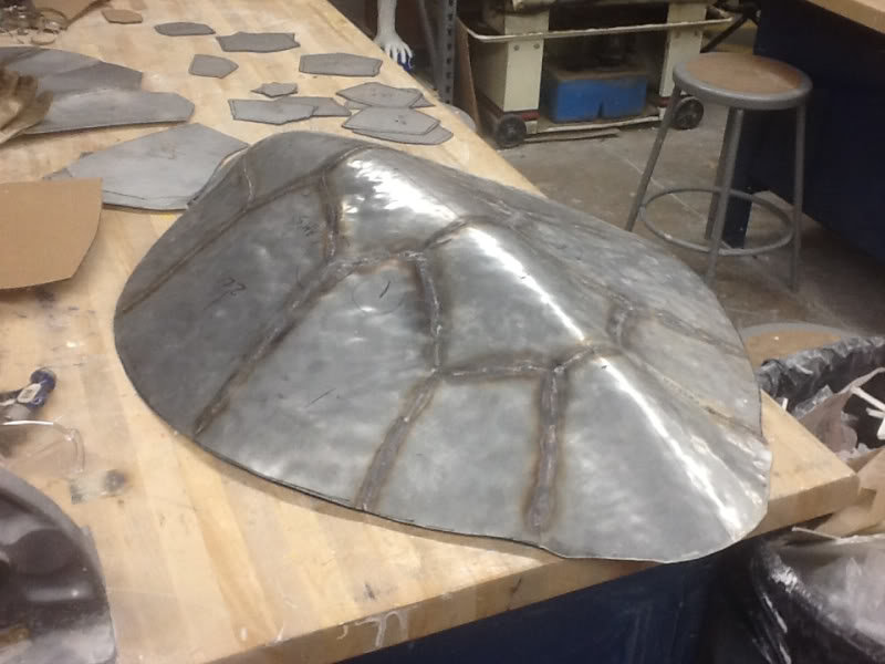

    This is what I am working on right now. I know it has nothing to do with the bumper, but oh well. Like previously stated it is a stainless steel green sea turtle (life size) I'm currently making. Welding 20 gauge stainless is a hoot! Anyhow, this is what I have to finish before I resume work on the bumper. :eek:

    Booooo:turtleride:

    the turtle has to be done in 3 days, I'm waiting to see the finished project. :D
    you've got one piece welded in since last week... progress has been kinda slow ... like turtle slow ...

    Oh lots of pieces cut out, shaping, tedious stuff. And I put the turtle off while I worked on the bumper. Forming stainless is hard. Compound curves are tricky as heck... But yes progress is slow. However the hard part is mostly over.

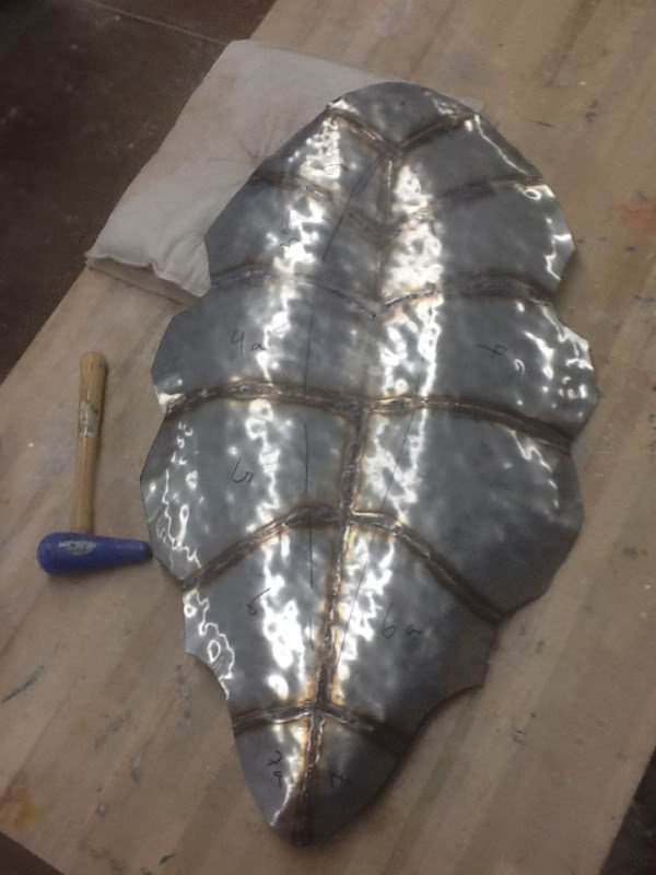

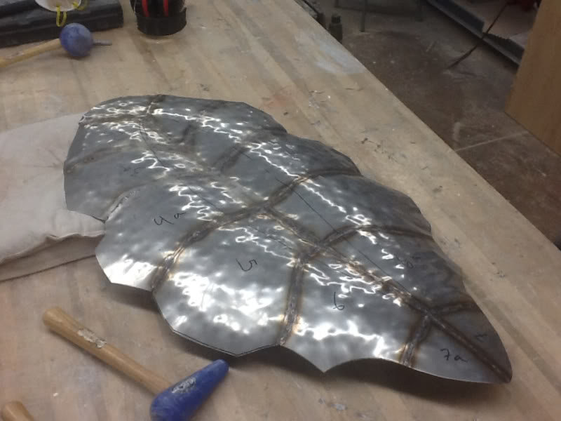

    Well this is what I made tonight, it's just been roughly shaped, and I'm going to weld on the next 10 pieces to this and call it for today. This is the bottom of the shell to the turtle.
    Progress is slow like a :turtleride:

    That does look cool though.I work with stainless every day and that looks like a pain in the ass
