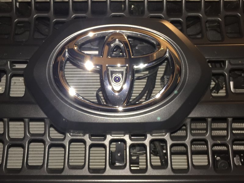

    I bought the toyota emblem camera and used a 8 inch monitor in the cab. DONT WASTE YOUR MONEY! Useless offroad. THe angle is super wide and makes everything look flat. Your perspective is screwed up and never once helped me over a crest or to place my tires. I was new to offroading and thought this could help.
    Bring a buddy to work as a spotter or get out and look. This camera was a huge waste of money.
    Now if I could mount a drone in the bed and fly in front of me on tricky sections......

    I agree! I did an experiment where I mounted a wifi enabled GoPro on the hood looking down (similar shot to what you get with the emblem camera). I used my phone as a monitor. I was shocked to discover it was WORTHLESS off road. I really thought it would be great, but the wide shot and top down angle sucked for giving any depth or any real feel for where my tires were going to end up.
    The wifi GoPro method is pretty simple to try out if folks are curious.
    I DO think the emblem camera would be useful for parking.

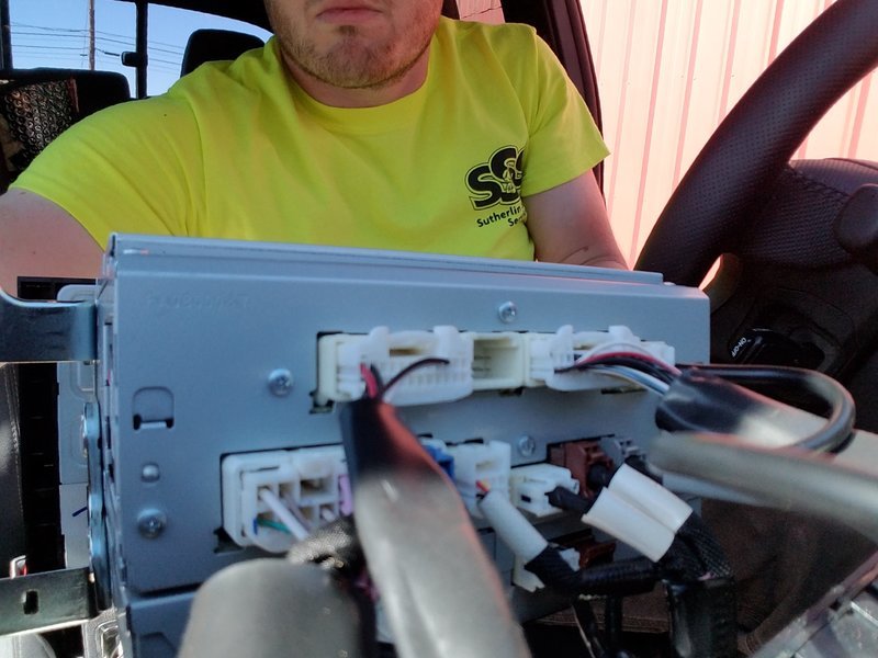

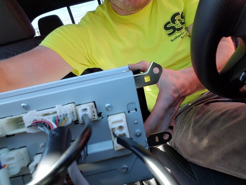

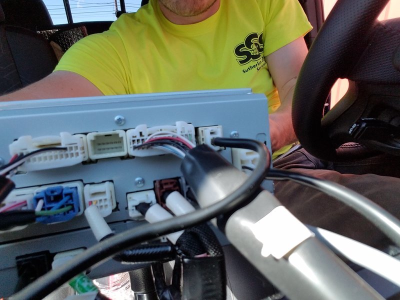

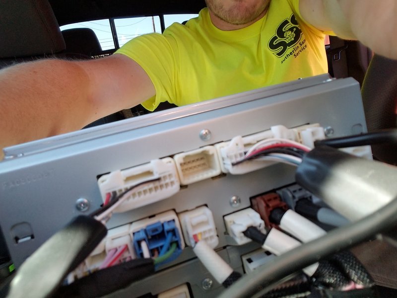

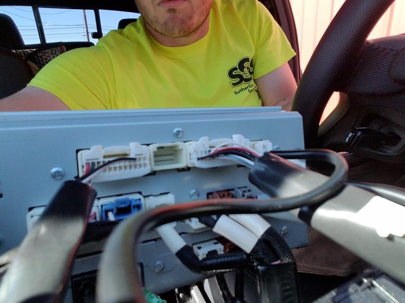

    i just did mine. Drilled a hole in the big license plate mount thing. It's pretty good. Can't see it unless you get on your hands and knees.
    I used the vitmy harness and an Amazon camera.

    Got this installed today and it works. Will be nice to see obstacles while offroad.
    On the head unit I have to select Source then AV Input. This was something I was not expecting. Then turn on/off the camera with the steering wheel controls. Once the AV source is selected no more music unit you reselect audio as the source. This was also something I was not expecting.
