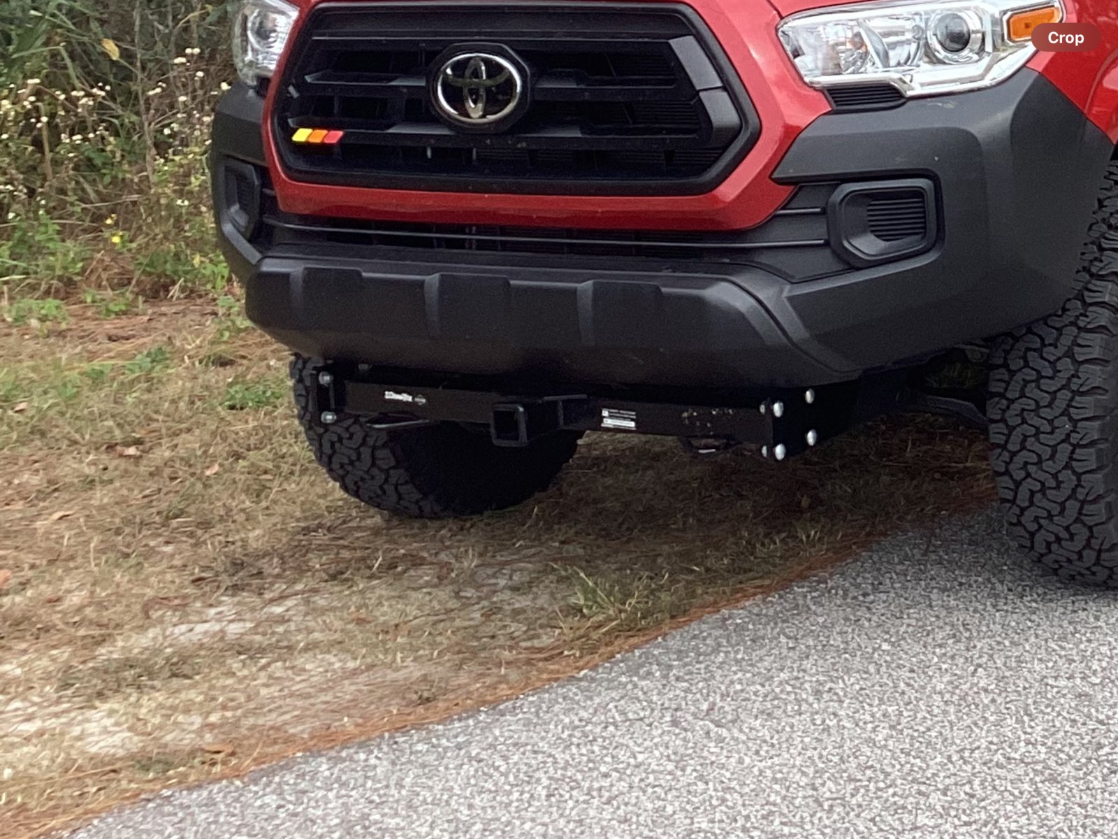

    I’ll take this over that front hitch basket that I see a lot of people sell when they realized the hit they have taken on their approach angle

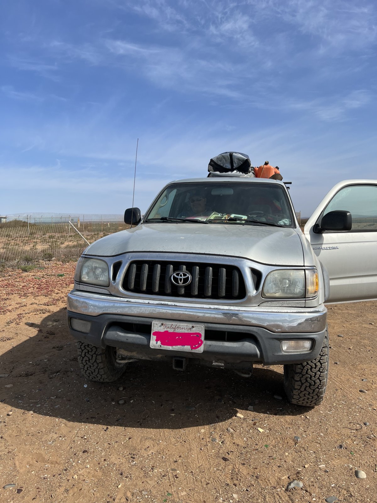

    DrawTite bolted up nicely.
