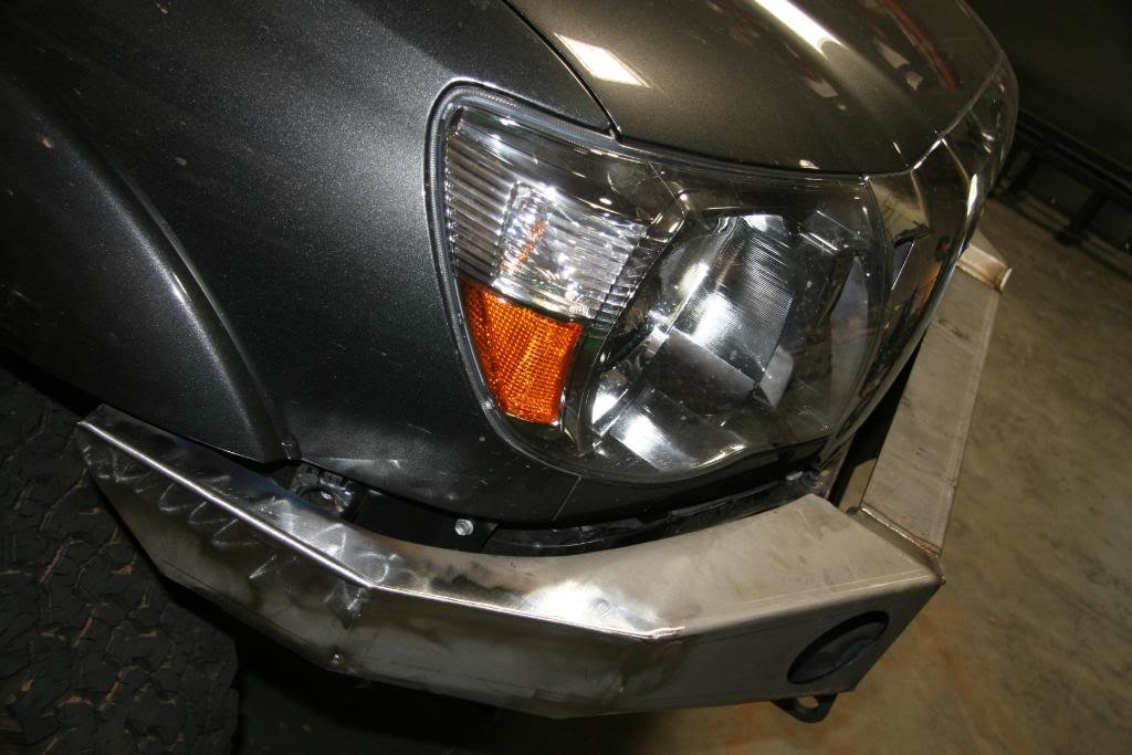

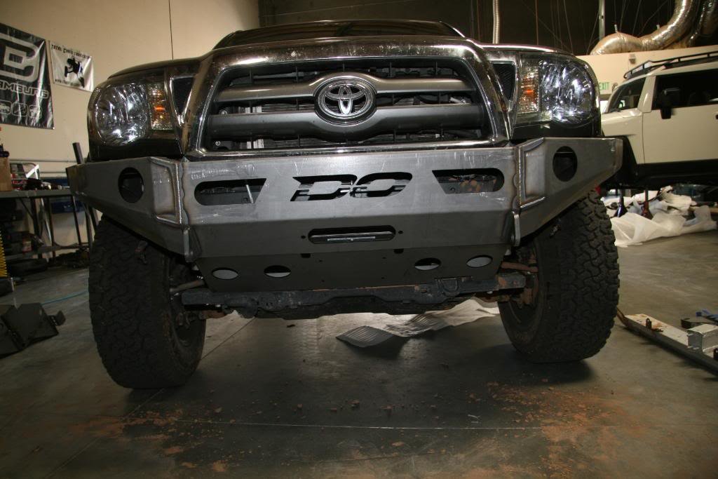

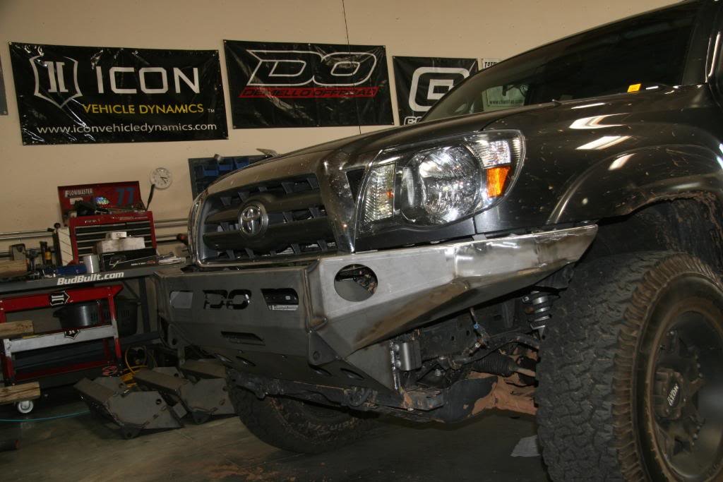

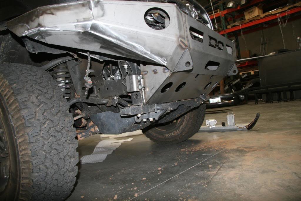

    Were putting together our first couple of Tacoma front bumpers. Here is a couple pics.
    These are all one piece front bumpers with the same option as any of our FJC or 4runner bumpers.
    We made the gap between the body and the bumpers about 3/4in to allow for body movement.
    Any questions please let us know.

    Wow that's gorgeous! Amazing work!

    Whats the weight of the bumper?

    what are the specs to set it apart from the others on here?
    Looks like a similar design.

    Thank you, were going to keep you guys posted when we get the first couple back. We should have these ready to sell here pretty soon.
    Right around 100lbs depending on options.
    It's built with a 1/4in framing and 1/8in skin. It's built very similar to our FJC bumper with 3/8in thick shackles, and a mounting point for a warn 8000m winch. We will take some more pictures of the rest of the bumper as we get them back from the powder coater.
