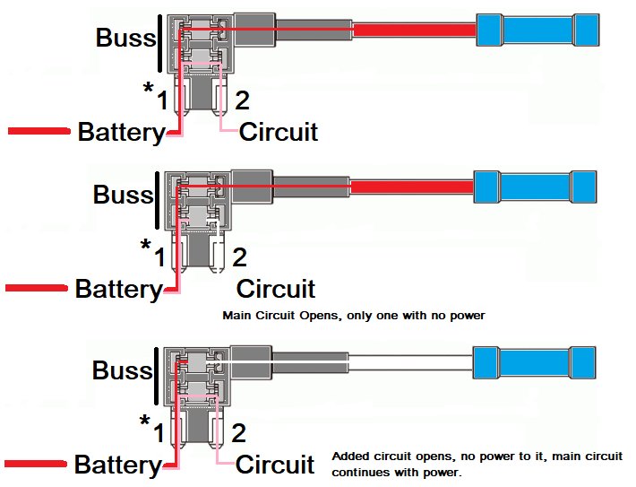

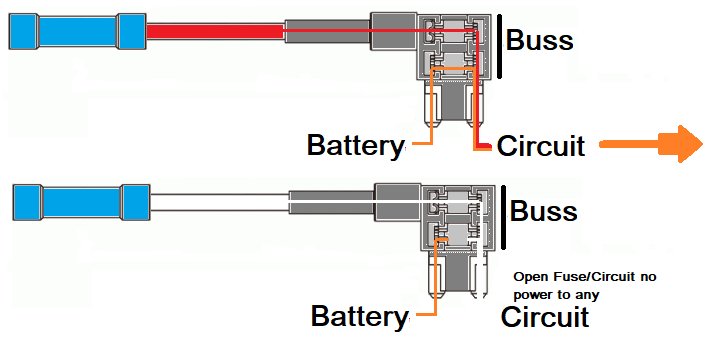

    As long as you identify which side of the fuse slot is from battery and which side is to circuit in the fuse location you choose, and place the add-a-fuse/circuit correctly you won't have that issue.

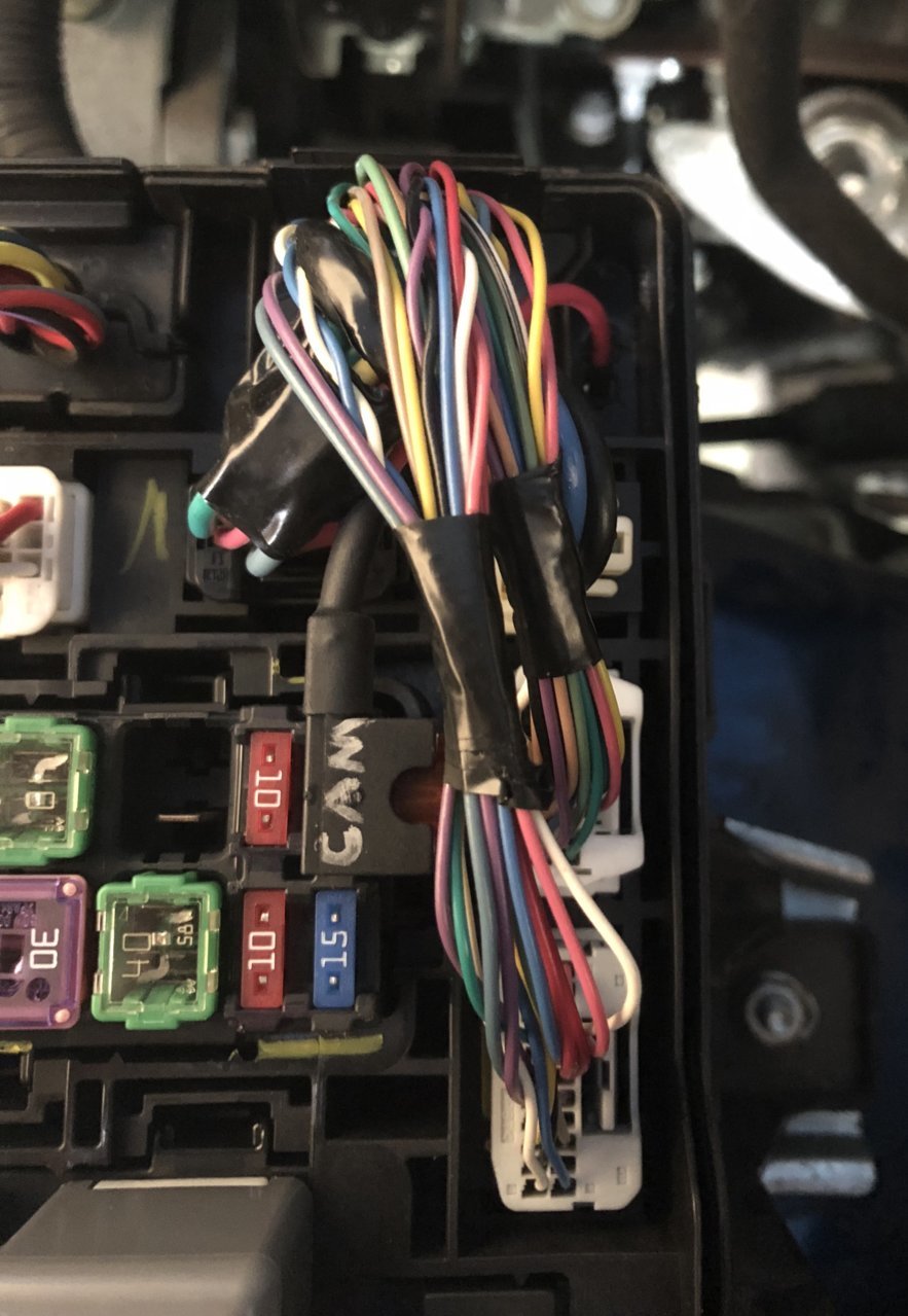

    Good stuff...I added my add a fuse to the AC slot (10amp on bottom/AC and 7.5 amp on top/Camera) and drilled a small hole in the bottom of the fuse box to run the wire so it wouldn't be compressed by the box cover. I also put a little silicon at the hole. I connected all the wiring with solder. The switch was installed at the left of the steering wheel into a shapeway's switch panel.

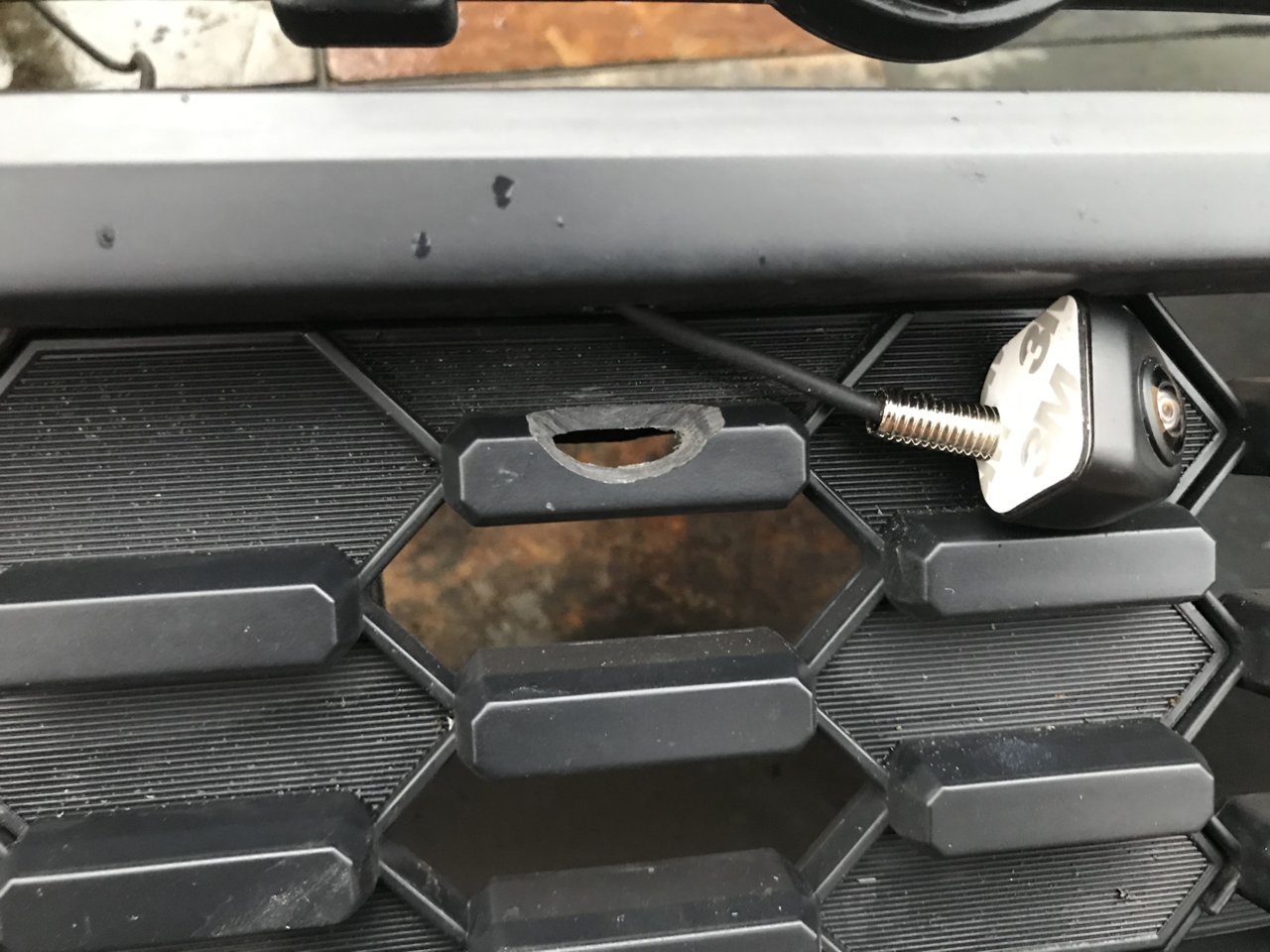

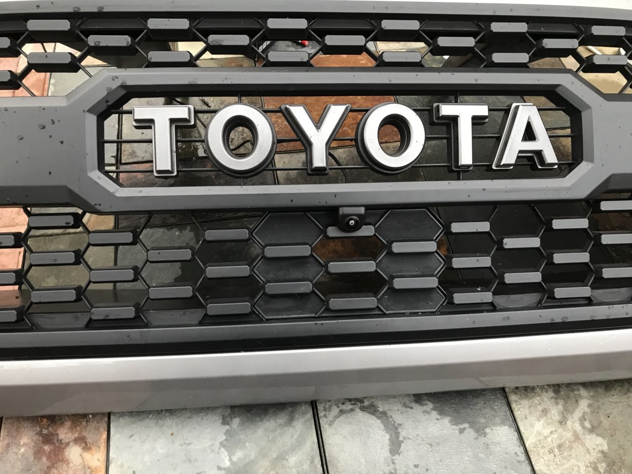

    This is how I mounted mine:
