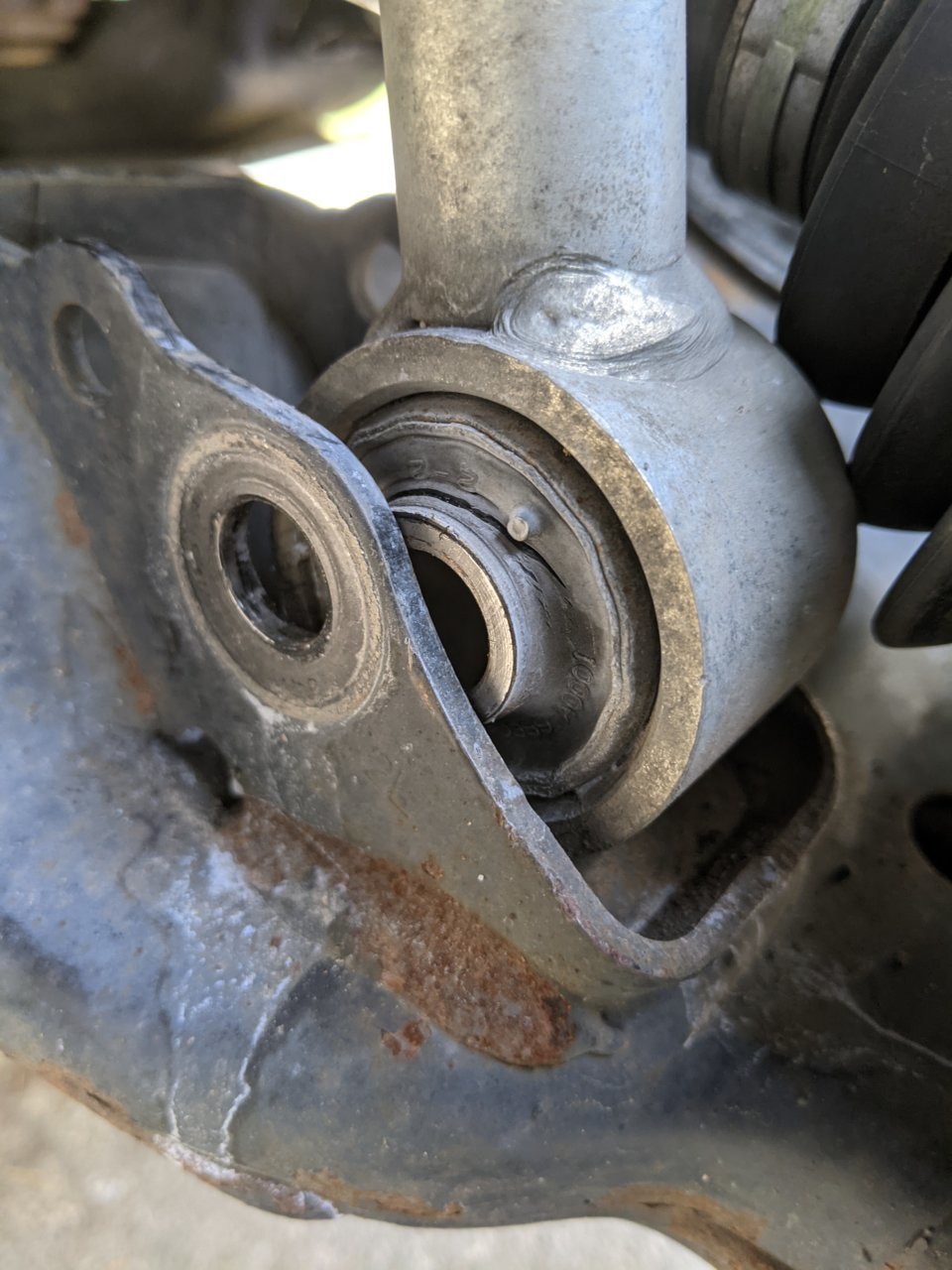

    Edit - turned out to be a worn front body mount (by the radiator). Body misaligned on frame from factory causing premature wear on mounts. Known issue according to the dealership.
    I recently started having weird noises coming from my front driver side suspension. It was almost always while turning right under compression. It made a very metallic clunk/pop/binding kind of noise.
    With words of wisdom from @Bertw192 and @msgs350 I loosened everything and re-torqued with the truck on the ground, no fix. I removed the sway bar, no fix. I ripped out my total chaos UCA and replaced with the OEM unit, no fix. So then I focused on the shock/coilover (Bilstein 6112) and I found this...
    I ordered a replacement and had it pressed in and the noise was gone. I am shocked that this bushing was able to cause such a ruckus. Anyways, if you are having a similar noise under similar conditions, inspect this bushing. Gotta love a $10 fix.

    I should have updated this....
    The noise came back and it turned out to be bad front body mounts (by the radiator). Lots of tacos are misaligned from the factory (known issue) and cause the front mounts to wear out very quick. If you have a noise like this have the dealership look at it. The front mounts have to be replaced and all body mounts have to be loosened and the cab re-aligned or it will happen again.
    Good luck!

    I brought my taco into the dealer for a loud clank in the front left (50k, I was surprised because it was pretty early). They said the body mounts were bad and replaced them but the clank is still there. Are you saying if they don't loosen and re align the cab the problem will persist? Or that the mounts will just wear out quicker?

    It should temporarily fix the issue but it will happen again if all mounts aren’t loosened and the cab aligned.
