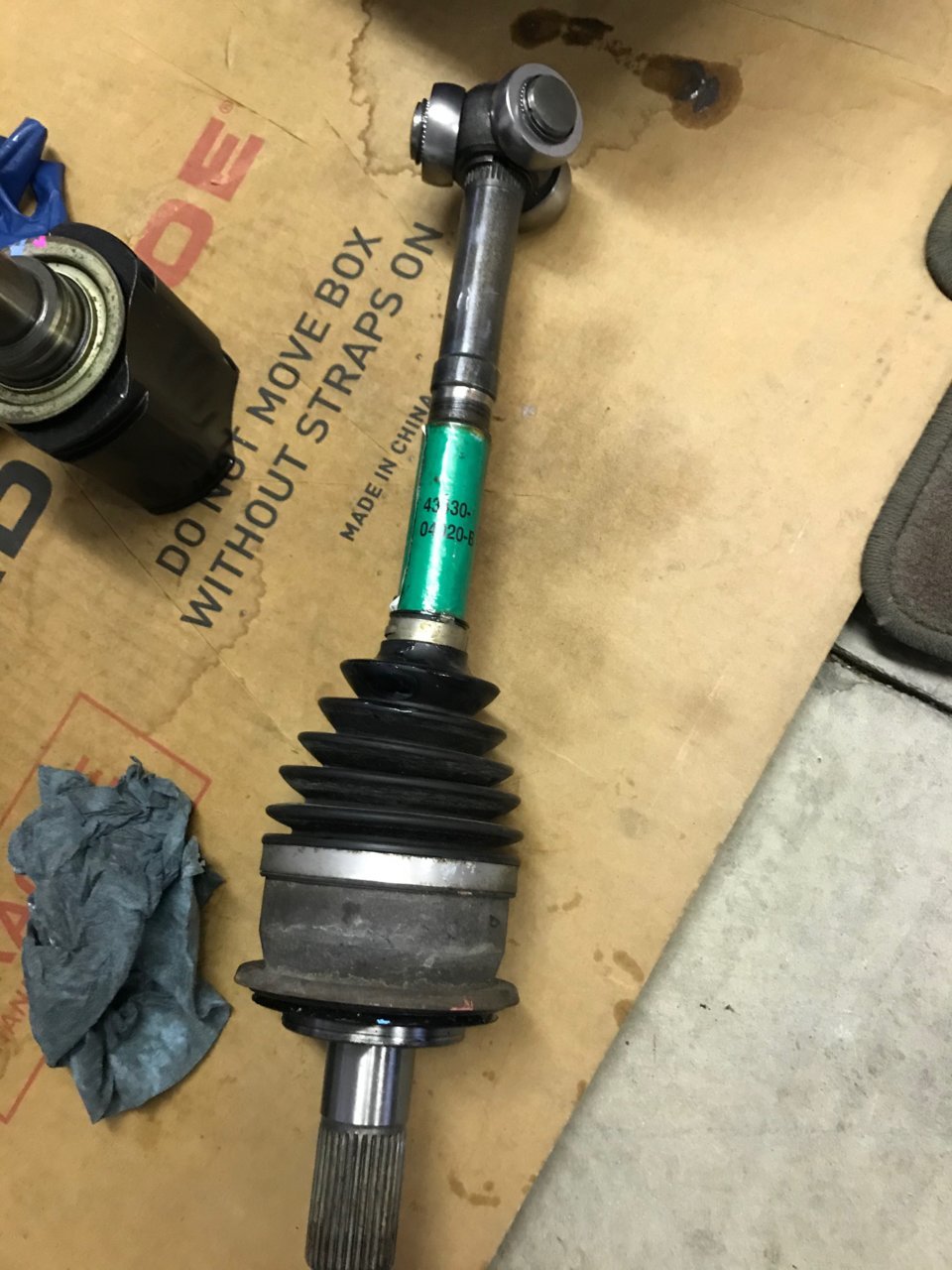

    So I did a front end rebuild/refresh on my 2000 Taco a few months back. Part of that refresh involved putting in new aftermarket CV Axels. For background I bought it used and don't know the previous maint./repair history, so as I find parts on sale, I pick them up and have slowly been refreshing the truck...BTW it's super rewarding to replace a few things here-n-there and then go..."oh wow, that's how its suppose to fell/drive.."
    Anyway back to my questions:

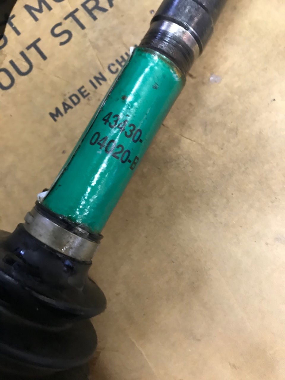

    1) Are these OEM Axels? If not then I won't even bother rebooting them.

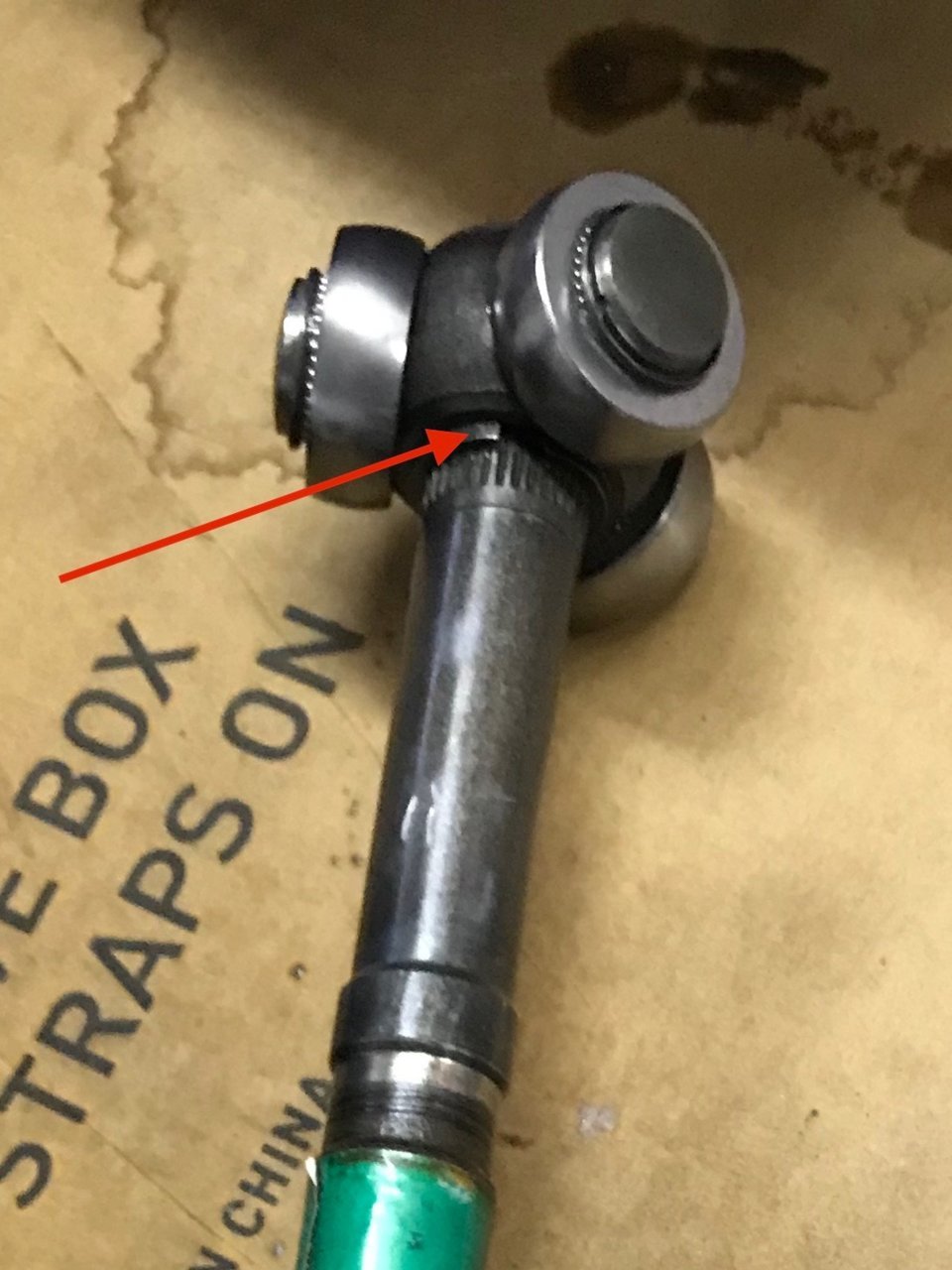

    2) If these are OEM why don't I have a snap-ring on/in front of the Inner Tripod Joint?
    2a) If this is normal, then how do I remove the tripod joint sans-snap ring?
    Thanks!

    Release and slide down the axle the exposed retaining clip. Then press down the tulip a little. This will expose a round wire ring clip that you then remove. Then the tulip will press off the end of the shaft.
    This ring clip isn't shown in the FSM...kind of a FSM typo.

    So if I'm understanding you correctly I need to release-n-slide down (NOT Remove?) this Clip?

    Also @btu44, when you reassembled did the tripod mount back on the axel flush like my (2nd photo 1st post) or should the snap ring be exposed upon reassembly?
    Hope that makes sense? Thanks!

    Those are OEM axles. If you are going to do the boot stretch mod, slide the clip down as that's what will restrain the boot from sliding up. If not, just mutilate that little shit, get it out of there and use the new one that comes with the boot kit.
    I lied, you still have to take the clip off if you do the mod. Otherwise, you won't be able to get the new boot on.
    You may have to tap the tulip down to expose the top clip. I had to anyway.

    Yes, the tulip is a light press fit so you could use a large socket to tap it down. The hardest part for me is get that damn clip expanded enough to slip over the splines. I've tried 3 different tools and it's always been difficult. Next time I may just carefully cut it off with a Dremel.

    This right here. FSM doesn't show it right. I just rebooted by cv axles last weekend and wasted 2 hours of my life fighting to slide that thing down the shaft with both cheap and expensive snap ring pliers (and everything else on hand) without mutilating the tulip and splines around it. I finally gave up and ordered the right tool. (https://www.amazon.com/Stanley-Proto-J250G-9-Inch-Horseshoe/dp/B00209ETSS)
    It's a lock ring, not a snap ring. And once I got those lock ring pliers in my hand, it took one entire second to liberate that son of a bitch.
    After, tapping the tulip down with a large socket to get the hidden snap ring off was a breeze, same with using a punch around the tulip base to tap it back up and off the splines.
