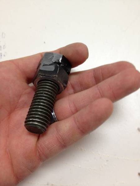

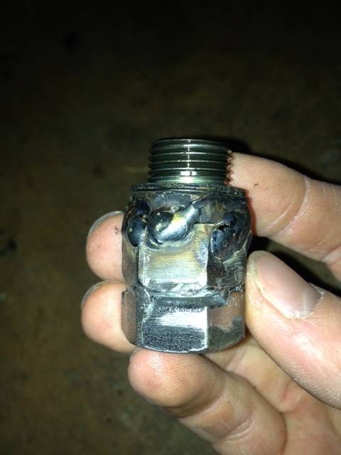

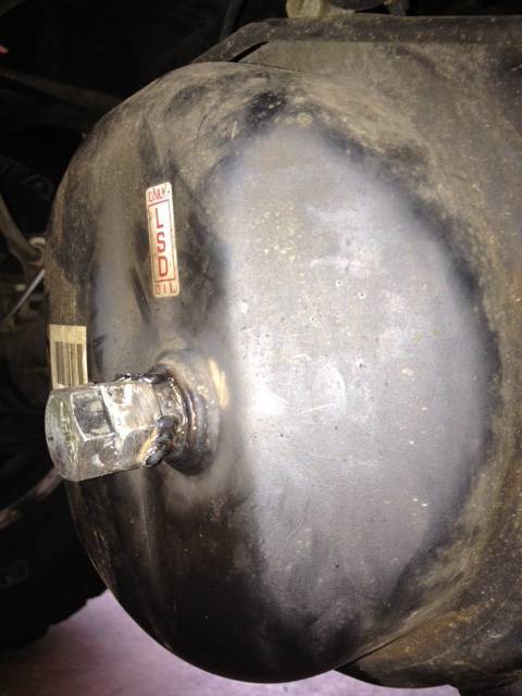

    Well I bought my truck with 40k, currently at 105k, never touched the rear diff or front or t-case. Bought all the oil and additive. Went to take the fill plug off and noticed it was a bit stripped but still had somethin to grab onto. So I ended up rounding the damn thing over completely. Thats when I got a good size bolt and welded a nut to it and then welded that to the original fill plug.
    Here is the Bolt/nut welded to the fill plug
    I noticed that the drain plug did not have a washer but the fill did. The rear diff fluid was really bad. Smelled horrible too. The magnet hardly had anything stuck to it. The other magnet was completely BARE. The front diff and t case fluids looked brand new as well.
