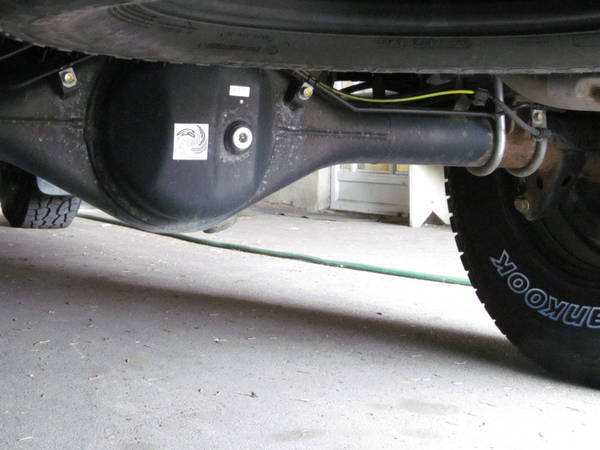

    This can get caught and rip if you go off road. I bought a front diff fill plug with the internal hex pattern and installed it in the rear diff:
