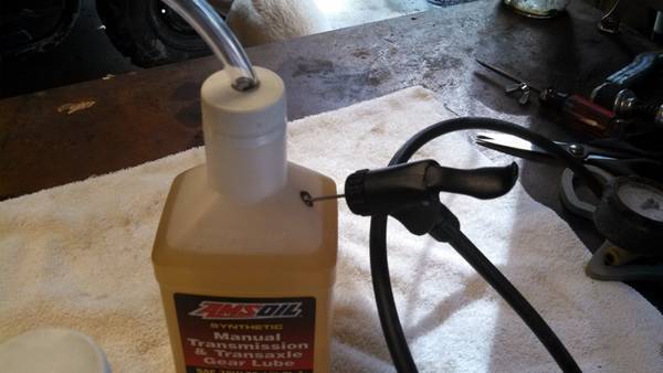

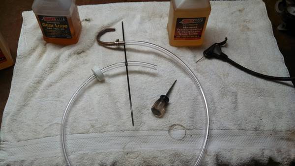

    Hey guys. Just wanted to show a cheap, easy, disposable fill rig for your gear /manual trans oil fills. It works really well. You will need a 1/2" drill bit, 2 or 3 feet of 1/2" OD tubing, 2 cable ties, a ball inflation needle and pump, and something sharp to poke a small hole in your bottles. ***Disregard the copper hook and hose clamp. The sharpness of the fill hole threads will keep the tubing in place while filling*** Setup looks like this:
    Amsoil tops are really big, so the hole size was no problem. Adapt tubing size as necessary. Punch a small hole above the fluid line in the bottle, and use hand pump to pressurize the bottle and drive the fluid out. I would be careful using a compressor for obvious reasons, not to mention the wife will go to that *ss if you ruin a load of laundry with a gear oil soaked shirt. Ready to go, it looks like this:
    Some learning points that I frigged up the first time:
    1) Clean fill and drain plugs really well the day before to eliminate foreign material issues.
    2) As mentioned earlier, leave off the copper hook. 1/2" OD tubing will stay in on it's own.
    3) Poke a very small hole in the bottle and force needle into it. You can empty the bottle with a very few pumps if you have no leakage at the needle. Maybe vise grips and tiny finishing nail. The awl that I used could make the hole too big if pushed too far in.
    4) Don't use regular gear lube in the manual transmission...It shifted like crap when I did. Had to refill with Manual Transmission lube (GL-4). 30 or so extra bucks whizzed away, but it's okay now.
    5) Use an empty bottle to put the fill hose in as you move between the diffs/transfer case.
    6) Fits well in a gallon freezer bag if you want to reuse it.
    7) Use two cable ties attached together under the cap so tubing leaves the bottle straight. Chop the hose on the bottle end at an angle and leave it plenty long to get all the way down into the corner of the bottle.
    8) Transfer cap/hose to full bottle and punch when previous bottle empties.
    9) Be prepared to pull needle out of the bottle when you think you are getting close to full to instantly depressurize the hose.
    Good luck!
