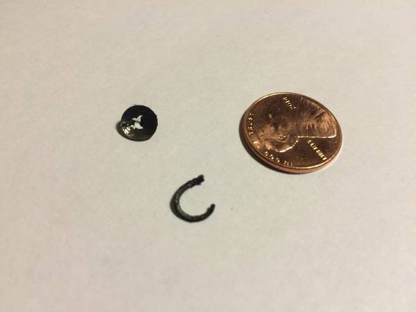

    Did my transfer, front and rear today. Front was milky/black with moderate metal on the drain plug (consistency of muck), transfer was clean as a whistle (like new oil), and rear was black with more muck on the plug like the front. BUT the rear drain plug also had two large metal shavings on it (see picture). Is this normal?
    Truck has 31k miles, first gear oil change. I've only owned it since 28k miles.
