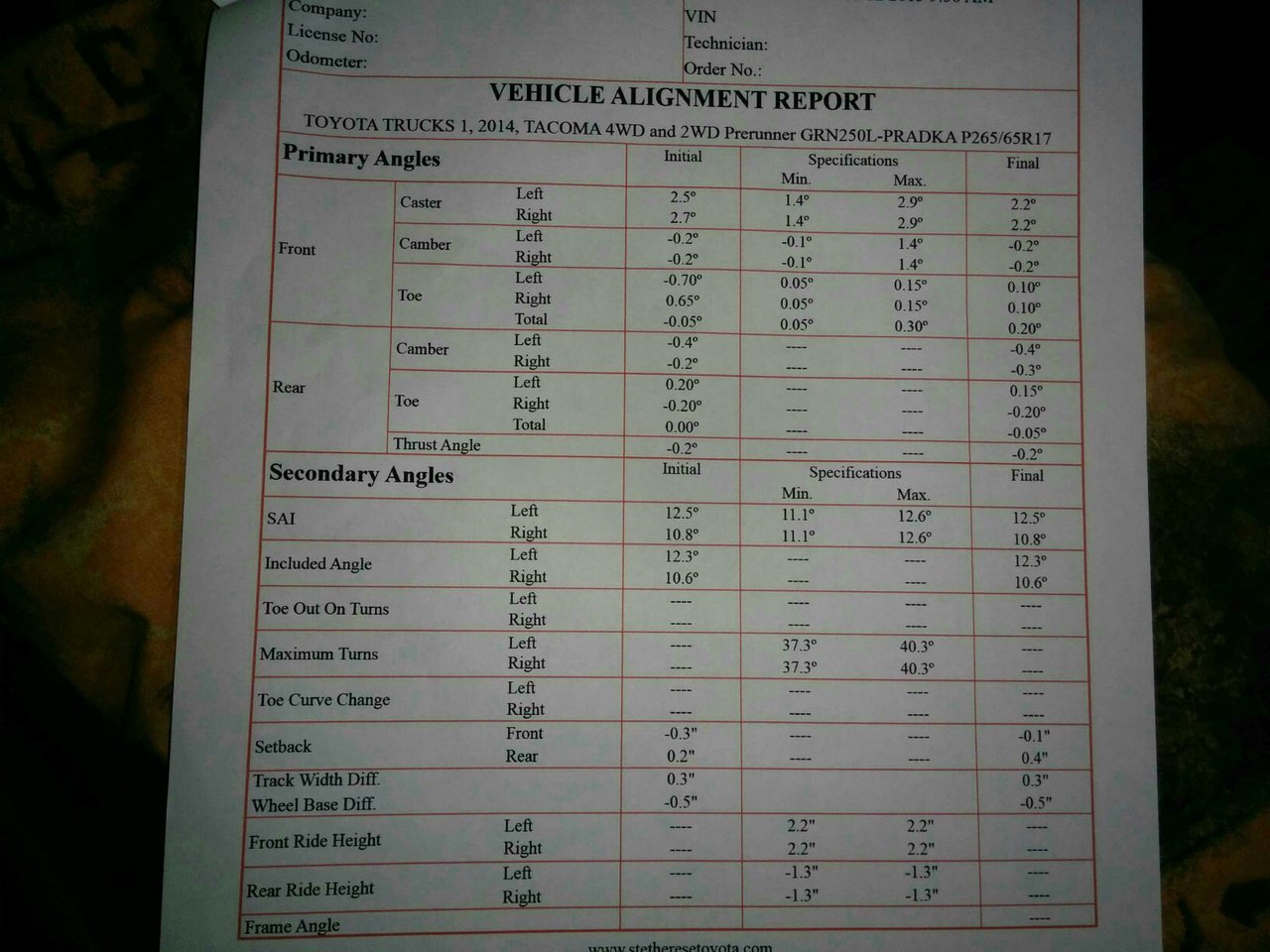

    On an another note, my alignment wasn't off by much.
    But damn it, I'm so much happy now that my steering wheel is straight, almost like having a new truck.
    The steering was off centered by, maybe 3/16th of an inch, but still I feel so so good.
    Am I the only one like this ?

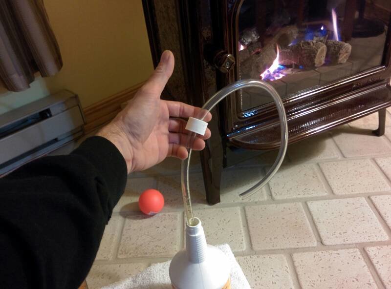

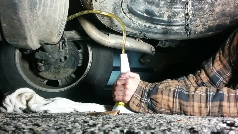

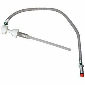

    I only did the rear diff today but my trouble could be helpful here also, I think.
    My pump 163ed065123e3a1495779569233f883b_b11a720ce038995510168d5ff96dd2b96dce16bd.jpg
    Takes somewhere around 150 to 200 pumps for 1 quart, and you have to give it the time to fill back up between each pump.

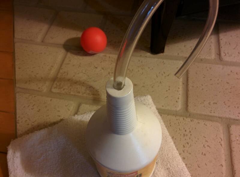

    My arm hurt after one quart, so I drilled a 5/16th hole in the original cap from the bottle, warmed the cap in boiling water, and sliped a 5/16th gas line, with a 7/16th outer diameter. Far enough to reach the bottom of the bottle, and let it cool.
    ac12bc88e9ff76b8a1937cd528d7790c_5cfc33aaeecbcc156f009b20372f1ad95adac84c.jpgb8a353c481b8ab6200076fbddfcf0127_e2e0e81a1a17590425ae919b284067a9907dbf6e.jpg
    It took me 4 bottle squeeze to empty it with 2 at the end with air to empty almost everything.
    Aside from that, it went very well !

    Good to know for next time. I bought a cheap penzoil pump at walmart while I was there and it leaked like a mo fo. I quickly hit the f it stage and just let it leak all over my hands while I pumped it in and threw it away when I was done. Luckily I bought a little extra oil.

    For about $30 at Napa or northern tool you can get a lever action pump that fits on a five gallon pail, about 4 ounces a stroke.
