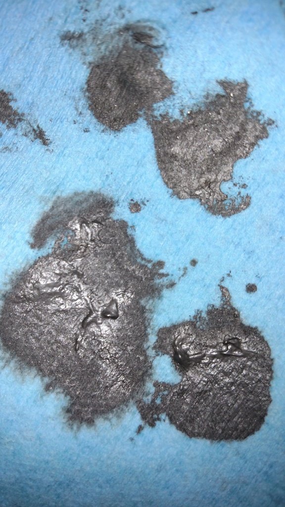

    This was on my front diff magnet at 12k miles... oil has long since spread out since I did the front diff about 2.5 months ago.. mostly metallic particles.
    Will be doing transfer case and rear axle in the next few weeks. Red Line 75-90 for replacement oil all around.

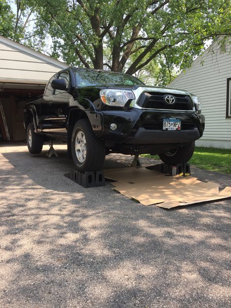

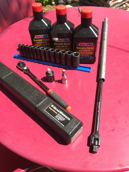

    Big thank you to the OP.

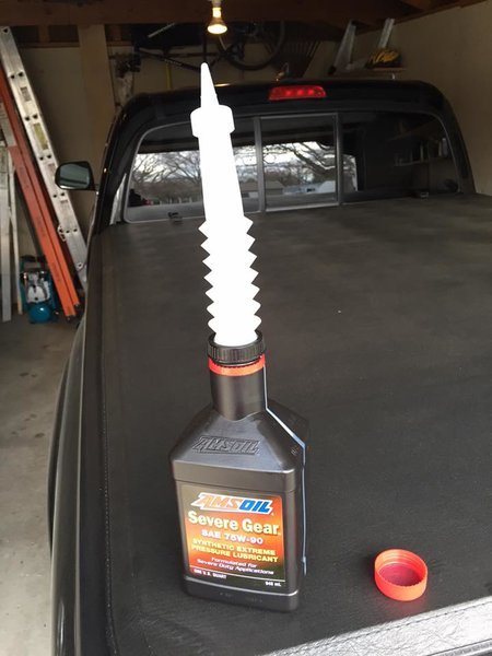

    I started the job without a pump. Thankfully, in anticipation of changing out the rear diff, I had ordered one of these Amsoil bendable spouts that are fitted for their gear oil bottles. I was able to fill the front diff with it while holding the bottle in the wheel well, while lying underneath the truck between the diff and wheel well. But because the bottle was level with the fill hole, I only managed to fill just over half a bottle's worth at a time by squeezing it in. Not a big deal, doing the first half of the first bottle, then the first half of a second new bottle, and then filling half of one into the other, and doing half of that one.
