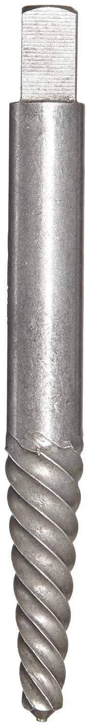

    So im gonna get a replacement on the plug on Amazon, and then to get it out, I need to drill a hole and then put that bolt extractor in and it comes out eh???

    You only want to drill enough for the screw extractor to get a grip on the bolt. There's a magnet on the back of the bolt that you don't want to pop off and get stuck in your diff somewhere.
    Don't forget to use oil/heat/tapping the threads BEFORE you try and use the extractor - or you may end up with a broken screw extractor stuck in your stripped drain plug.

    So what would be the correct size to get (screw extractor)

    M10-M12
    See the link last page. 3/8" / M10 should do the trick.

    CAREFUL with the extractor!
    You do not want to snap it off as it is very hard steel and will require a very hard drill bit to even dent it!

    LIFE.. I drilled the hole, then put in the screw extractor. And put maybe 40 pounds of force? Not a ton and bam! the thing broke right in half...

    about the only way to get a broken extractor out is EDM (electro-discharge-machining), which would require removing the whole assembly and bringing it to an EDM capable machine shop.

    Can you screw out the extractor? or did it break at or below the surface? if below and you can get in there with a drill, drill around the easy out and see if you can pop it out. A carbide bit will punch through it too.
    To properly use an easy out you have to drill out 90% of the bolt, almost just threads. Little late...sorry.
    Do you have the replacement bolt/plug? If so make note of its depth and width of threads. You want to avoid introducing shavings into your diff. Use lots of lube and maybe a couple sizes of carbide bits to enlarge the hole without punching through. Also don't want to mess up the threads on the diff....!
    Your easy out should be 75-90% of the width of the threads. Closer to 90% in your situation with a seized bolt.

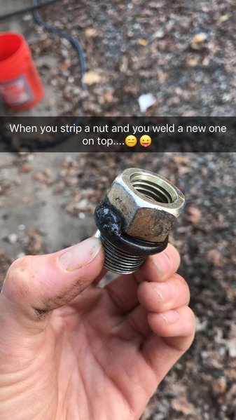

    UPDATE!
    Craigslist success, called this local welder who does fences etc.. He welded this 1" nut on for me and the heat plus the weld made it easy to come off! Came off, put on the new plug and bam! Life goes on.. $30 to the welder not too bad considering the shop said itd be 60-100 per hour to do it, which may have been more? Anyways just glad to be done with it.. Thanks guys
