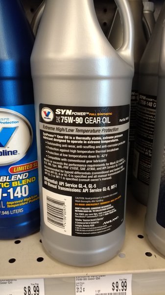

  7. Apr 7, 2017 at 11:12 AM
    #967
    skatebass1958
    skatebass1958 Member
    Oct 22, 2012
    #89537
    16
    09 Tacoma SR5 Speedway Blue
    SHHHHHHH
    The lucas is similar to this one, on the bottle they claim gl4 and gl5. I guess the question is if is it safe to ise it since it is claiming to meet the gl4.
  8. Apr 7, 2017 at 11:21 AM
    #968
    LeftCoastNerd
    LeftCoastNerd Old 'nuff to know betta
    Mar 27, 2016
    #182459
    1,890
    John
    Santa Cruz, California
    08 AC 4x4 OR 6sp
    yeah, that article I linked said not to use those hybrid oils in synchromesh manual transmissions.
