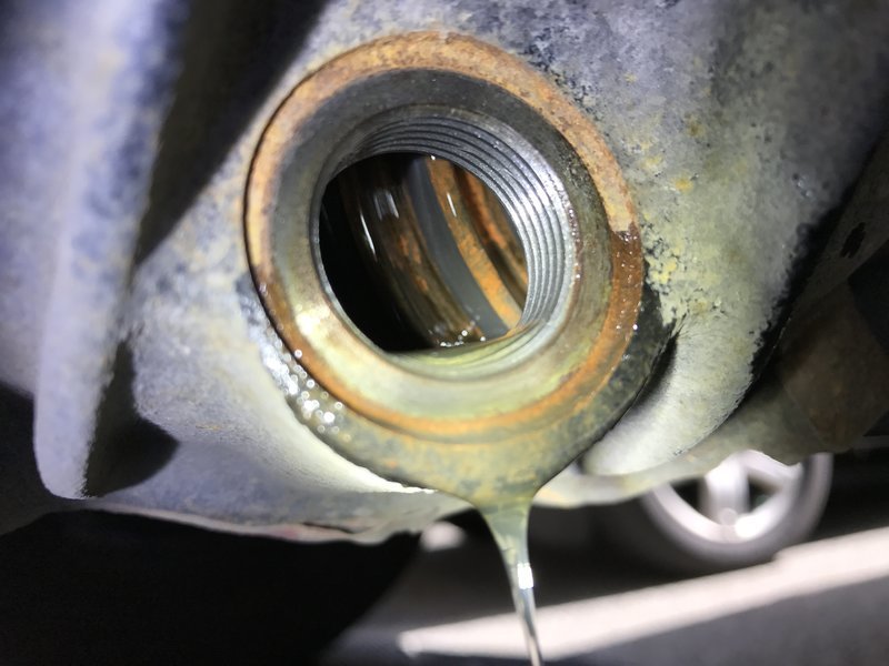

    I just did my 3rd diff oil change (90k). These threads always help and I keep referring back to them when I do maintenance to check torques and what not. While draining the rear and front diffs I looked at the gears and saw something concerning. There is rust forming. It isn't forming on the contact surface of the teeth but it still concerns me.
    I don't do water crossings. Could it be from condensing moisture forming inside? I tried to look around the web and found that this happens. Not sure why.
  11. May 7, 2017 at 5:35 AM
    #991
    Blockhead
    Blockhead Well-Known Member
    Jun 6, 2015
    #156849
    1,986
    Pittsburgh, Pa.
    2024 Silver SR5 DCLB
    I wouldn't worry about it...Also, that fluid coming out looks pretty clean. I changed mine at 30,000 a few times and the fluid coming out was clean too. I'm now waiting until closer to 50,000 to change it out from now on.

    Interesting as that is the drain and many of those parts would be under the gear oil. I looked at mine on Friday and everything was bright and clean inside. The surface rust probably won't kill anything though.
