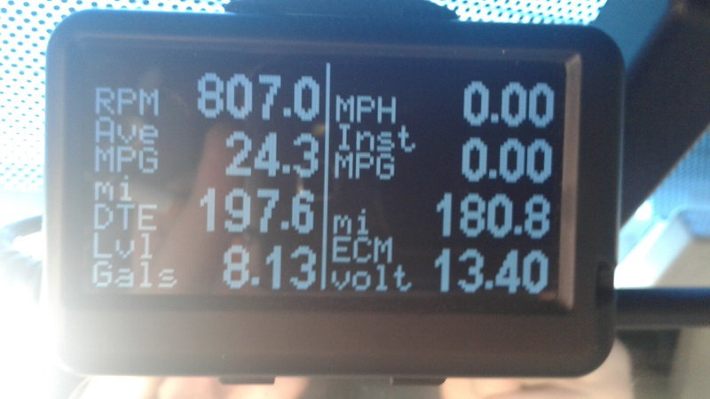

    So, at 110l miles I changed the transmission, transfer case, and front + rear differential fluids. Mobile 1 75w90 in everything except for the transmission (royal purple 75w90).
    This thread was very informative. Since changing the gear fluids, my mpg has been significantly better. I've gone from getting around 20 mpg to around 23 mpg doing the same commutes and routine driving.
    Over the last 180 miles i've been getting 24+ mpg.
    I should mention that I also changed my spark plugs in the last 2000 miles and have been running my tires at 34 psi (G265/70 general grabber AT2s)
    However, I do have a cap and over 250 lbs of stuff in the bed of my truck at all times.
    So, if your thinking of doing this maintenance but have been putting it off... go for it. Your truck may need it as bad as mine apparently did.

    wow, i've never gotten anything *close* to 24mpg from my 08 V6 stickshift 4x4.
    my average is 14 mpg, my best tank ever was 19 mpg.

    I have to ask, since I also got unusually high MPG readings on my UG, until I calibrated it. You calibrated yours for the actual gas used, not just what it thinks it reads, right?

    yeah, do those readings correlate to your actual gas consumption, miles driven divided by gallons to refill ?

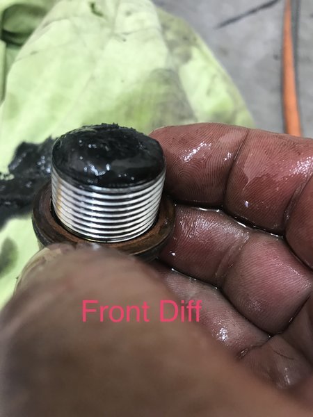

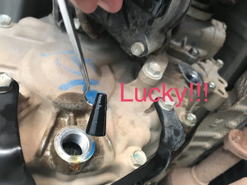

    I work at a nuclear energy plant and have been trained to work methodically and I went against it today. I cut the tips off the bottles of new oil and placed the caps back on. I got under the truck with everything and had both the drain and fill ports open. I placed the bottle tip in the fill port to see what kind of room I had and pulled it out. Not long after removing the tip I realized that the cap was no longer on the tip. Yep, it went in as I pulled it out! I got a flashlight and inspection mirror and no sight of it. I was about to cry. I decided I'd get the old oil and fill the bottles up and try to flush it down to a visible spot through the drain port. After flushing two bottles down I was able to see the end of the cap thankfully! 10 minutes later with a dental pick I was able to extract it. I got lucky! I did the transfer case, transmission flush, front and rear diff. I'm gonna spill the beans... first time @ 140k... yeah, shame one me. The majority of my miles are on road so it didn't surprise me when I saw the condition of the front diff and transfer case.
