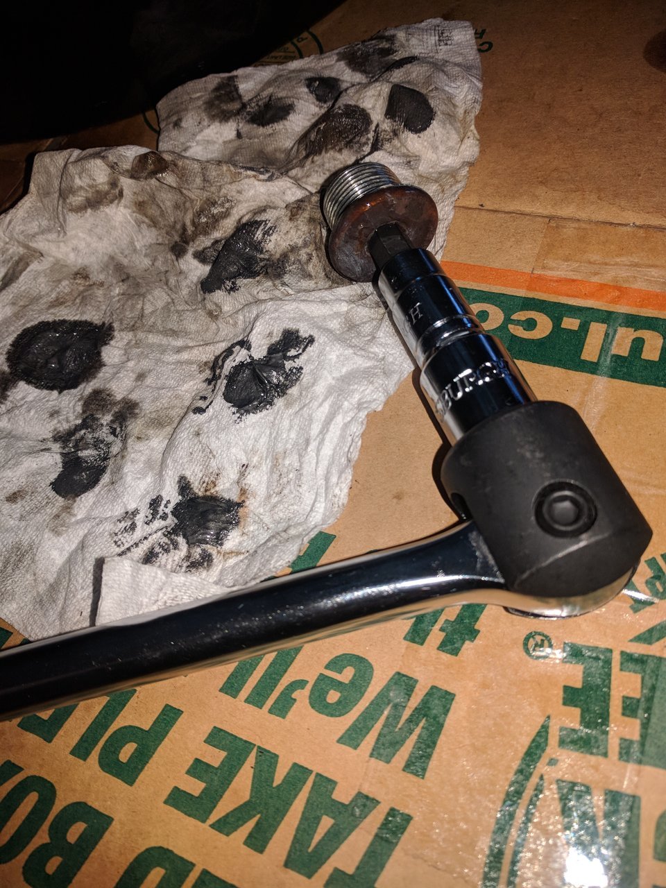

    Oh my God I almost gave up with the front diff. Also broke a 3/8 ratchet. It was crap anyway. Used a breaker bar, socket adapter, and the 10 mm hex. Finally came off!! The leverage helped alot.

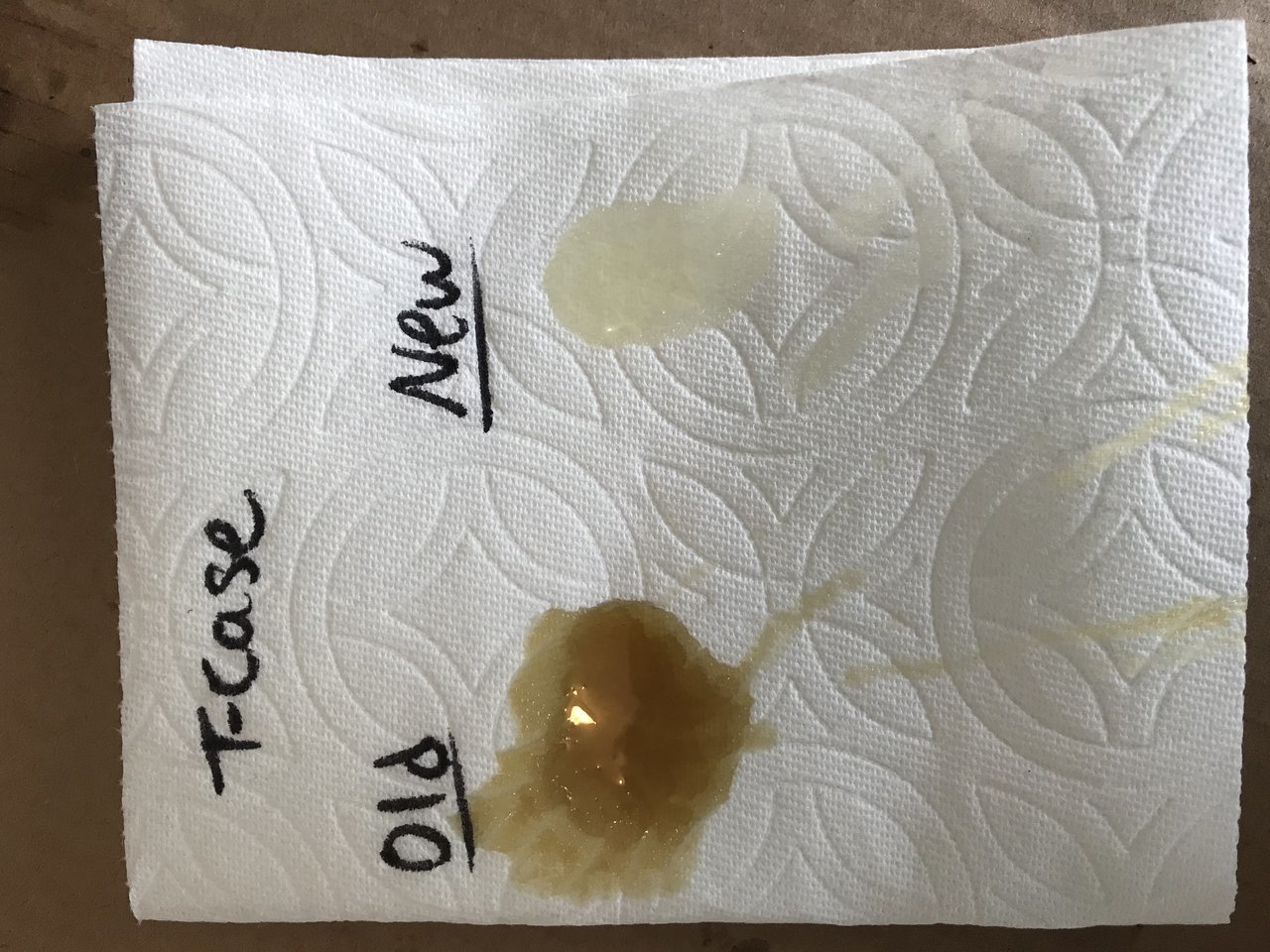

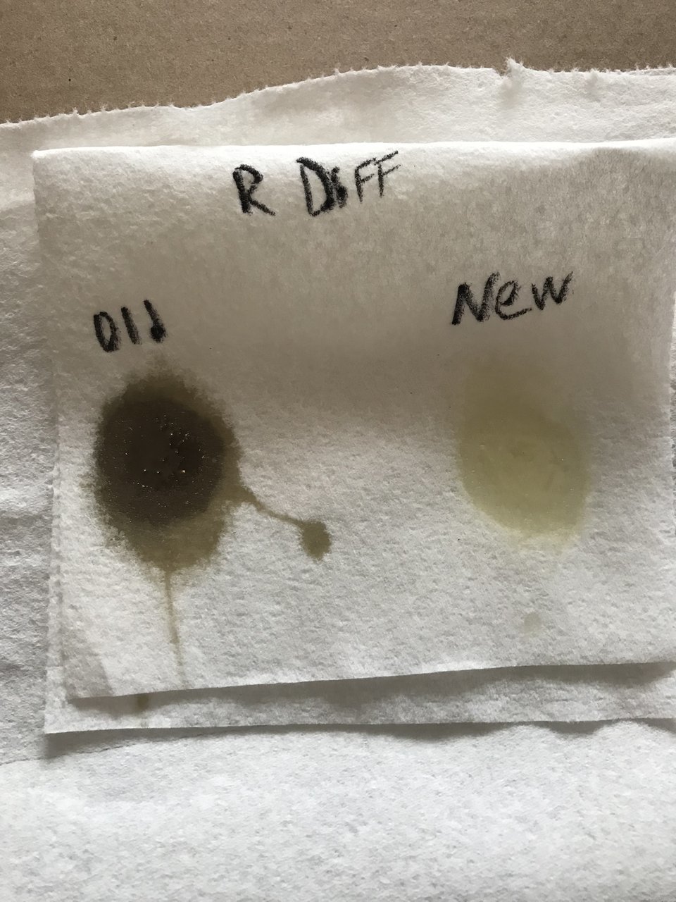

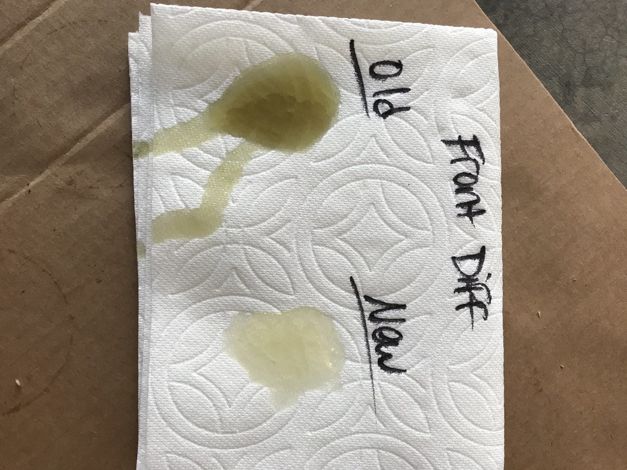

    So after finishing all three gearboxes today, It went pretty well. Front diff drain plug was a bitch to get off but it eventually gave. Looking at the comparisons, it almost seems as though I didn’t need to change them in the first place. But piece of mind is good I suppose. Let me know what you guys think..
    Also noticed some rust on the gears in the front diff.. is this normal?
    Thanks in advance for any input!

    Front diff was defintely the darkest and milky grey. Highly recommend the 1/2 in 10mm hex bit and breaker bar to help get this sucker off. The weird angle and not much room makes it the most difficult out of the three. My 2014 was tough so i know You older models are on thier good. Great thread thanks for the info.
