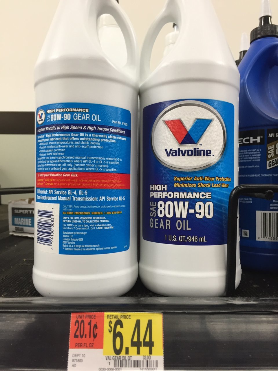

    Yeah.
    I've used the Valvoline as well as the Walmart brand you can see a part of in the right side of your pic, 80W-90 in all three. Never an issue, not that big of a difference between the weights and the brands.

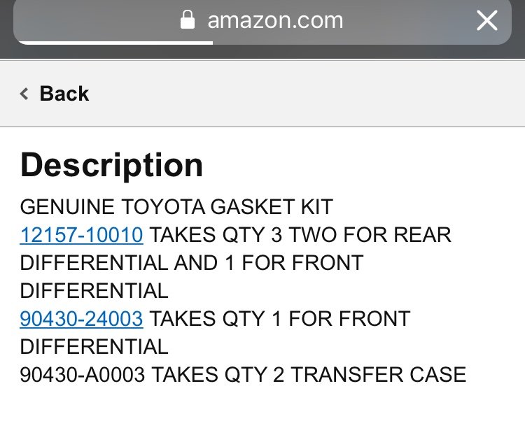

    Anyone buy this in bulk? Gotta do front and rear diff and transfer cases on my 05 Taco and 07 4runner. Looks like all take the same oil. 75w-90 or 80w-90. Was looking at Super tech Walmart brand but didn't know if it was garbage or not. They sell it in gallon. Also anyone use the AutoZone/harbor freight transfer pump?
  14. Apr 25, 2018 at 8:42 AM
    #1134
    TacomaMike37
    TacomaMike37 Well-Known Member
    Aug 12, 2013
    #110316
    5,085
    13' DCLB MGM
    I bought supertech 80w90 , 2 gallons. Will do differentials and transfer case..if I ever get around to it.
    I also picked these up https://www.amazon.com/dp/B017V4BAXI
    Benny123[QUOTED] likes this.
