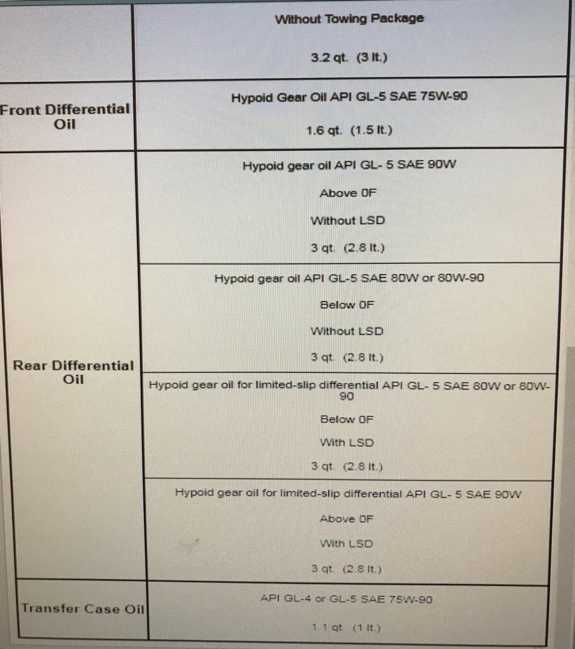

    60 pages of reading hurts my eyes.. Toyota parts counter guy gives me """uhhhh uhhh" answers and the service guys are to busy to pick up the phone. I don't want to ask auto zone because they don't care....... but I need to do my truck at 62k and don't know much about prior service on this vehicle. But im having a hard time picking oil to use.
    I understand 75w - 90 and 3 quarts should take care of TC and Front Diff, but is it ok to run synthetic?
    I have a LSD differential rear and doing straight conventional and LSD additive, I was going to buy 6 quarts of the same, but if I can run synthetic in my driveline somewhere I will be happy.
    2014 Tacoma sport.
  4. May 30, 2018 at 8:38 AM
    #1164
    1E7DCSB
    1E7DCSB Well-Known Member
    Jan 22, 2018
    #242056
    308
    NH
    Ignore the weights in the photo. 75w90 is fine for everything, but yes you’ll be good with 6qt.
    I’d change the gaskets too, they’re cheap.
    Austinguy and (deleted member) like this.

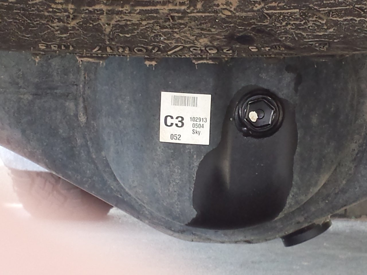

    grubburg
    grubburg Well-Known Member
    Jan 13, 2014
    #120579
    2,329
    2019 TRD OR MT
    K & N Intake, Gibson Catback (chopped), Weathertech floormats, 285/70/17 Ridge Grapplers, Black Rhino Glamis wheels, Kicker Key, Kicker Hideaway, Infiniti Speakers, OV Tune, 888's, 5100s X 4, HS 3-leaf, LR SPC UCAs, Diff Drop, Carrier Bearing Drop, OEM Bed Mat, Morimoto HID low beams, Morimoto LED 2 Stroke High Beams, KC 336 LED bar, KC C3 LED pods for rear, KC LED 6'' SlimLites ditch lights, N-Fab Steps, Auxbeam Interior Blue Lights, 7r41lbr34k3r Shift Knob, Wet Okole Seat Covers, Diode Dynamics SAE Pro Fogs, Cali Raised ditch light brackets, hidden light bar brackets, tailgate light brackets.
    diff.jpg diff.jpg here is a pic of my diff. The door jamb says A04A, which I think means open (i.e. non-slip). So, I think the a$$ at O'Reillys misinformed me about the limited slip supplemental liquid and I don't need it...
