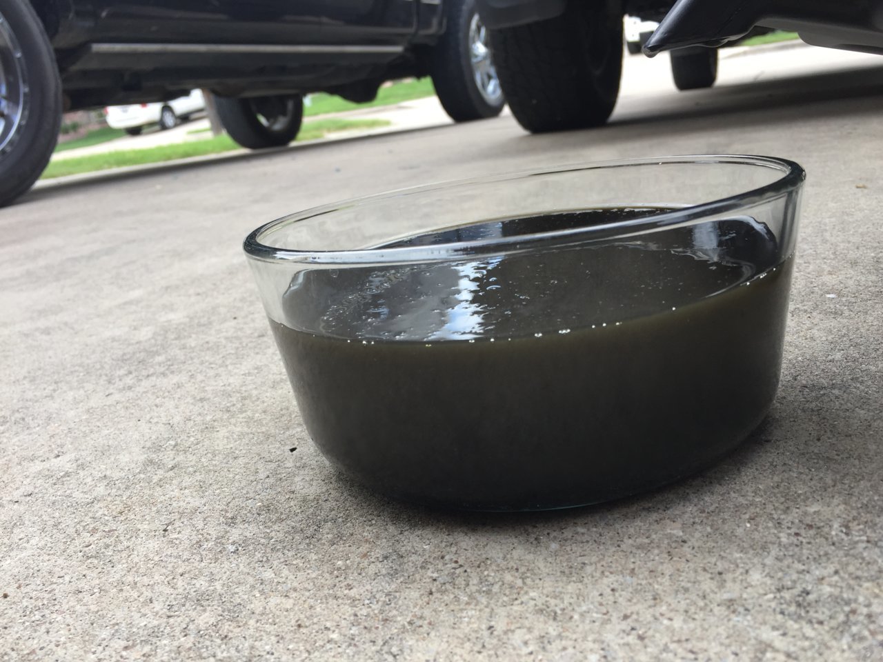

    I did mine today for first time at 45k. Front had a bunch of sludge and was really black. Rear and transfer case were just cloudy.
    This is the final mix.

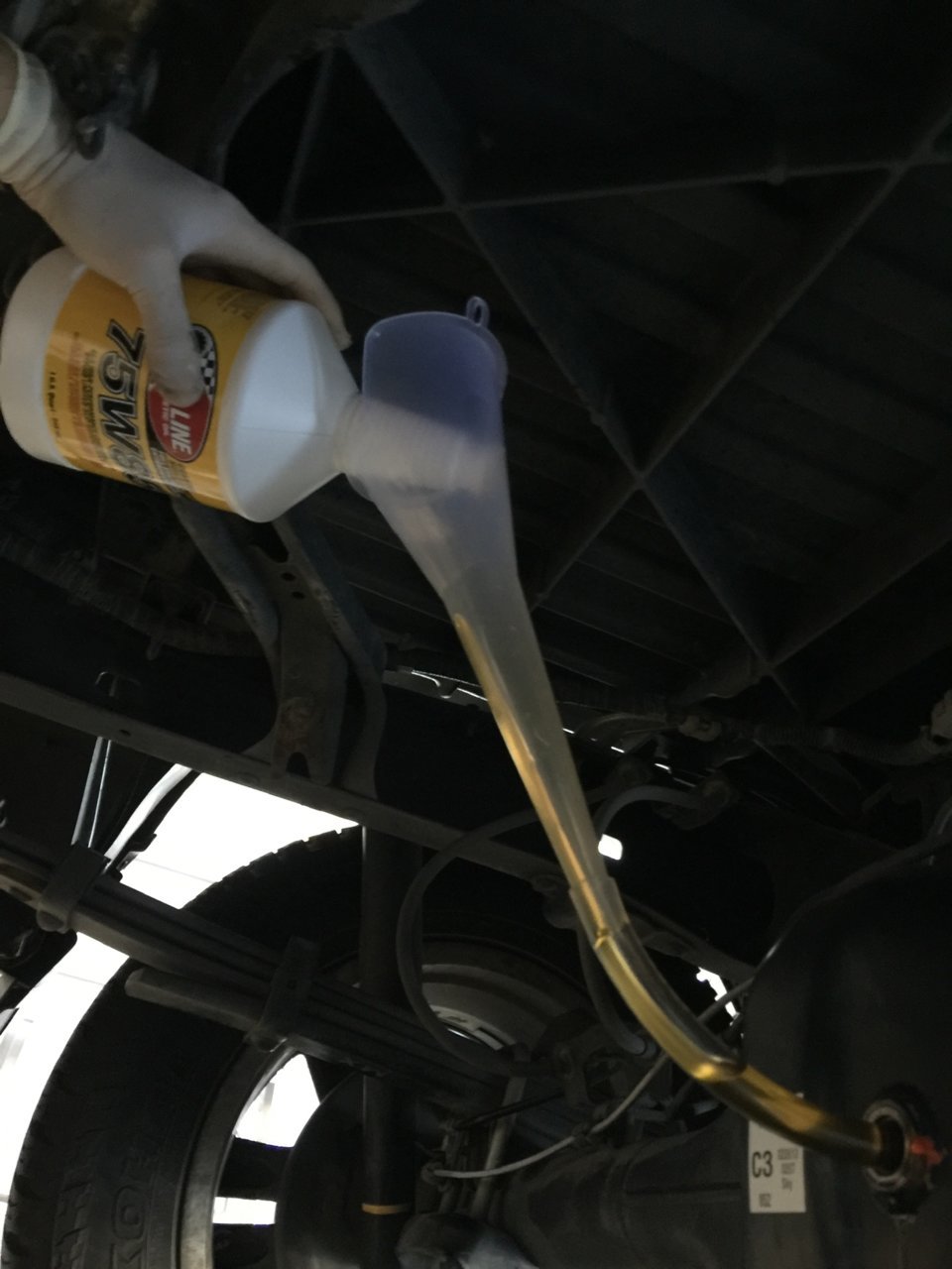

    Just changed rear differential oil - it didn’t look too bad - kind of light brown. Approx 85k miles. Filled it with Redline 75w-85. Removed the spare tire to wash - it was super dirty. A plenty of room without a spare tire there.
    GonzoQuick, Rick_Taco, gulzeb and 5 others like this.
