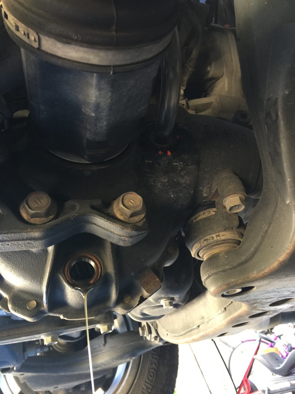

    That drain plug on front diff is a whore, I stripped it out almost completely trying to loosen it. Stop what you are doing and get a new plug. PB blaster twice 2 days before. Its just a crap design with dissimilar metals, and a little 10mm hex key and a huge plug. So if you have a little left to grip the trick is to lightly tap the back of the head of the breaker bar with a very small 6 oz ballpien hammer while slowly gently loosening it. Then after a few minutes it breaks the seal you smash your knuckles but you did it. It got a little nickel anti seize before being reinstalled and torqued to spec.
    Kpatt9, robssol, Rick_Taco and 2 others like this.

    What I found is that my brand new 10mm hex socket was wanting to pop out of the plug under the force of the breaker bar because the centre of moment was too far away. So what I did was slip a 10mm wrench over the hex right close to the diff and used a 24mm wrench (biggest I have lol) for extra leverage. Bent my 10mm but it was worth it :p
    And yeah, lots of pb blaster.

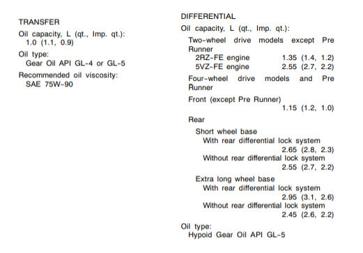

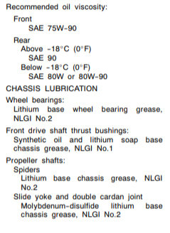

    What are peoples thoughts on using synthetic grease for the differential? I would prefer to go with the type of grease that was manufactured with my vehicle and stick to OEM specs. I think the Toyota engineers did a good job and I don't want to change it.
    Here is info from my manual with specifications for all 2001 Tacoma:
    24g906q_e02833665313e99eedf07fdea8b02582c9f849b1.jpg rm1yt3_429b2aa113cff36e3f7b89d0f44a69551a59e3eb.jpg
    Also with the type of grease I found it has a type of squeeze type top with a nimple. Do I really need a hand pump if I can just squeeze it in?
    Thanks
    - Jonathan
