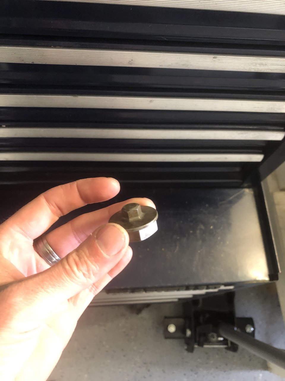

    Got a new drain plug tool for a stripped out front I'll see how it works in the morning pretty hopeful for this one. I think this thing may be a must have for yoda owners

    Also get a new plug with a 24mm like it should have had in the first place like all the other ones on the truck.CF83805A-8216-4E2C-A93C-6DB211152C87.jpg
