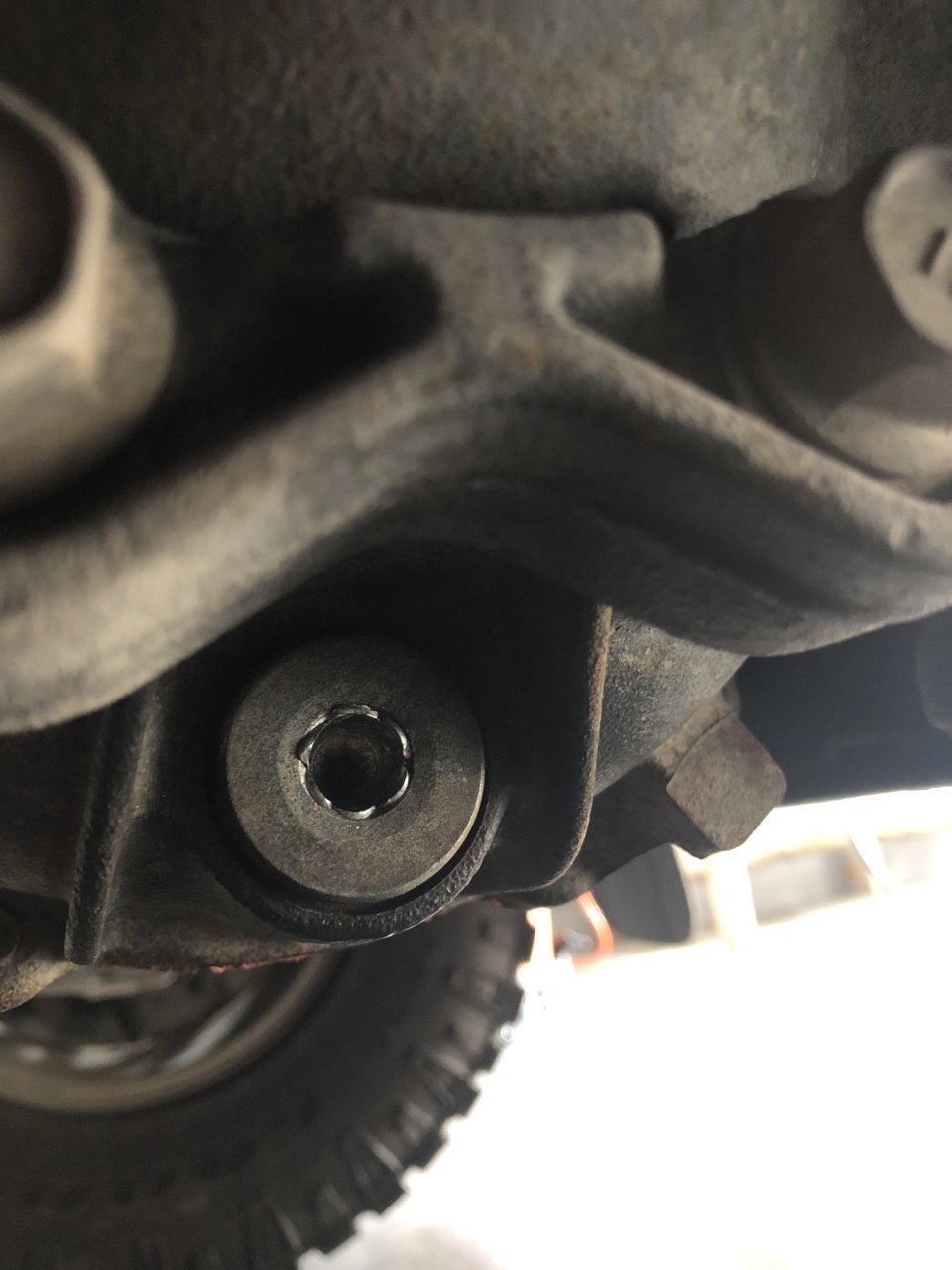

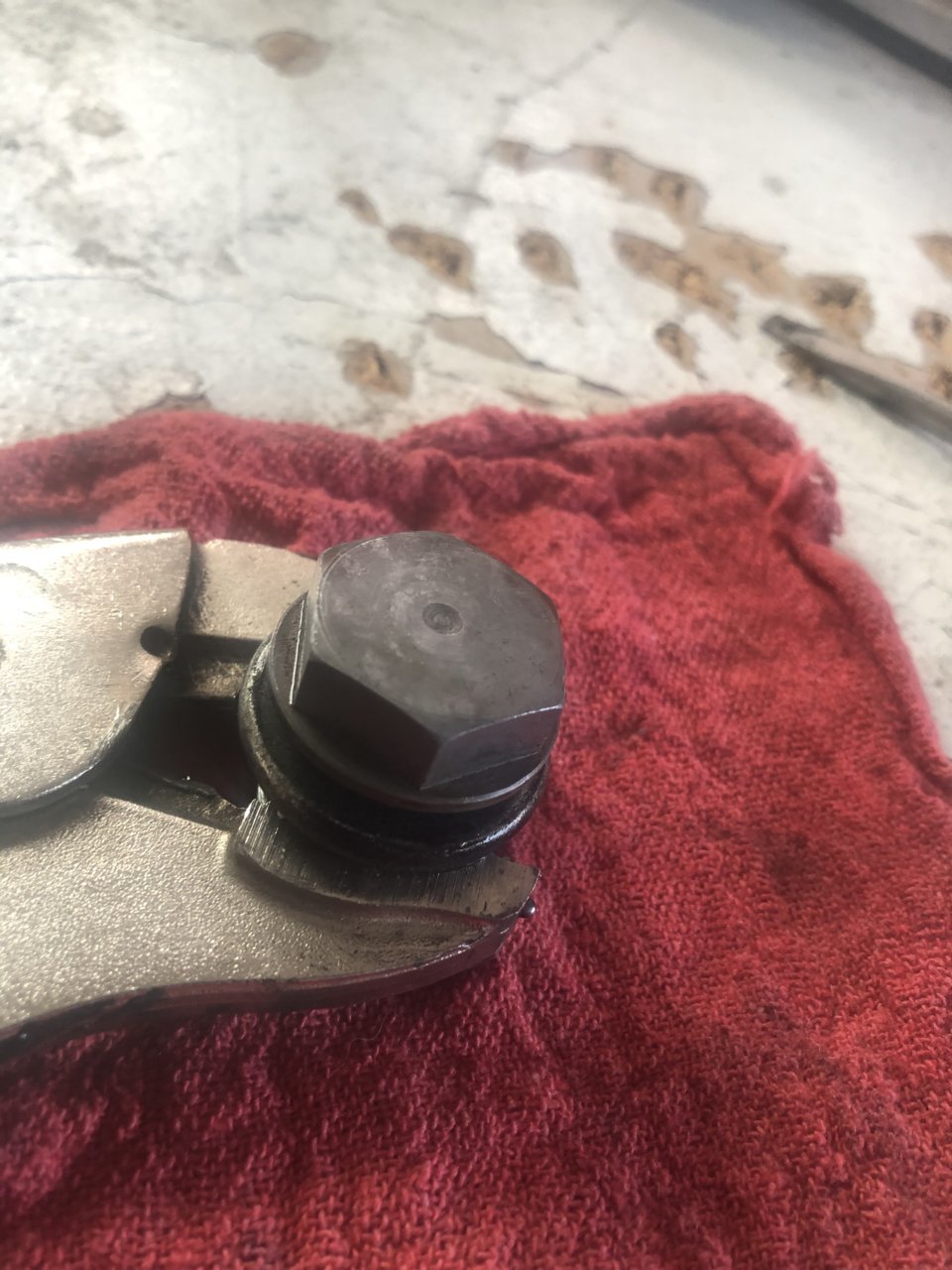

    Not enough room to get a 24mm socket on it.
  2. Jul 7, 2019 at 7:38 AM
    #1262
    $yoda$
    $yoda$ Well-Known Member
    Jun 11, 2019
    #296087
    1,946
    Tom
    2007 Tacoma 4.0
    2.5 inch lift, 285/75r16s, upgraded stereo system, Magnuson mp90 supercharger system.

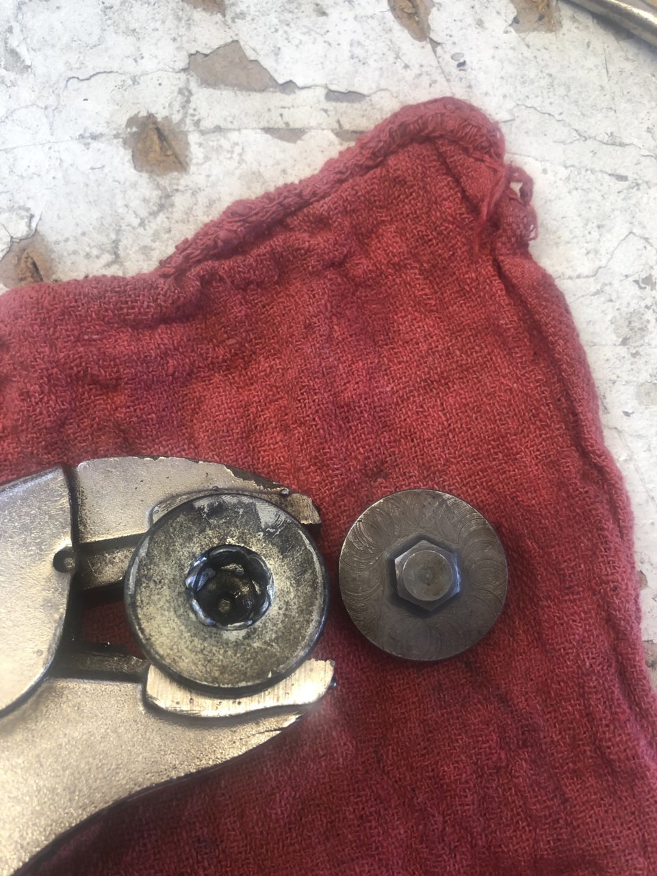

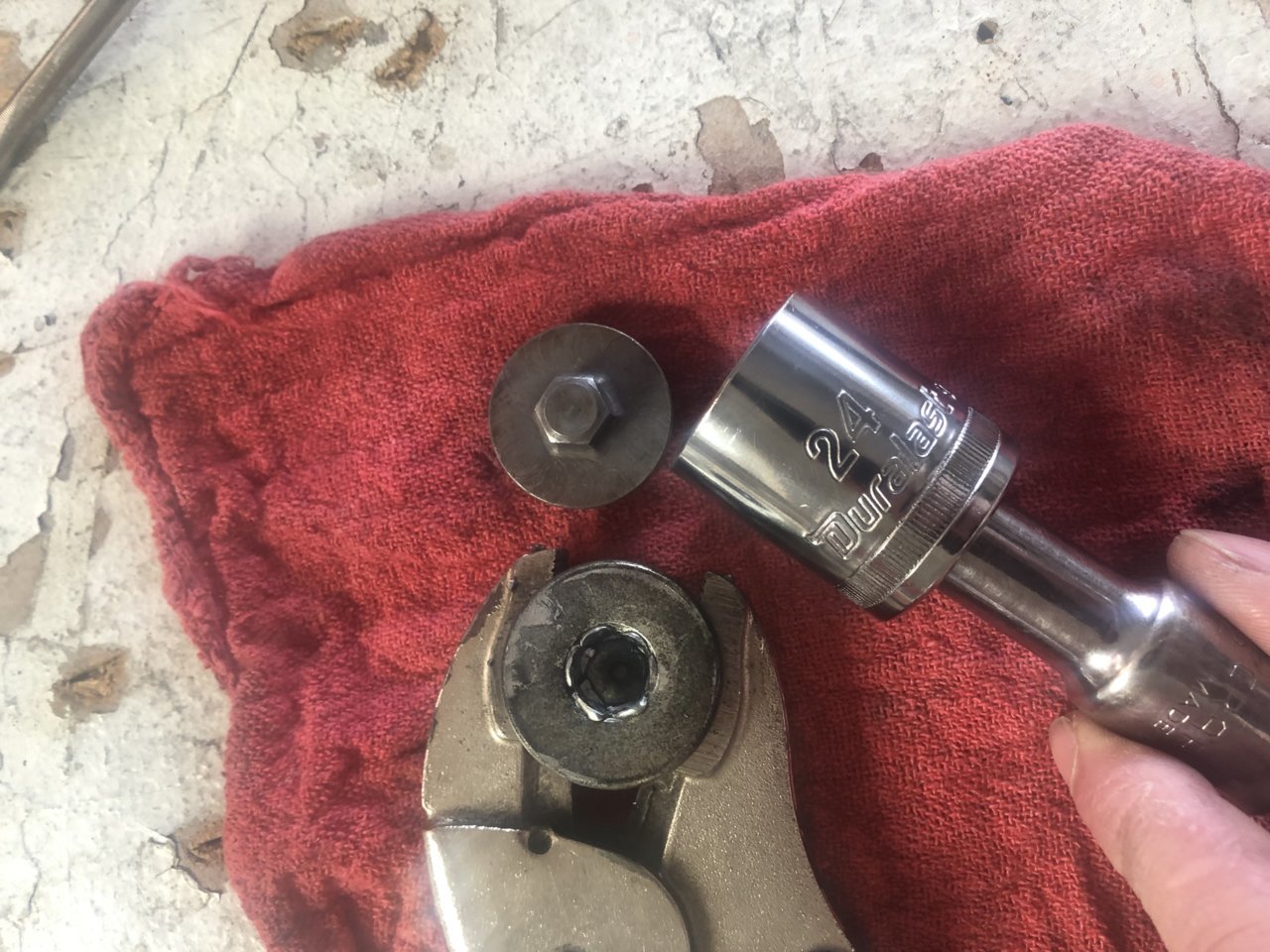

    It's made a little larger to be hammered in to the damaged holeEC70A2D0-6437-4C45-9AE6-E139E173D660.jpg
