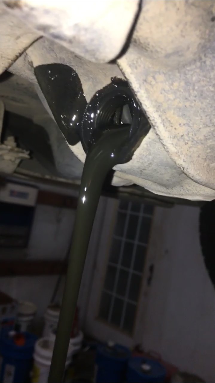

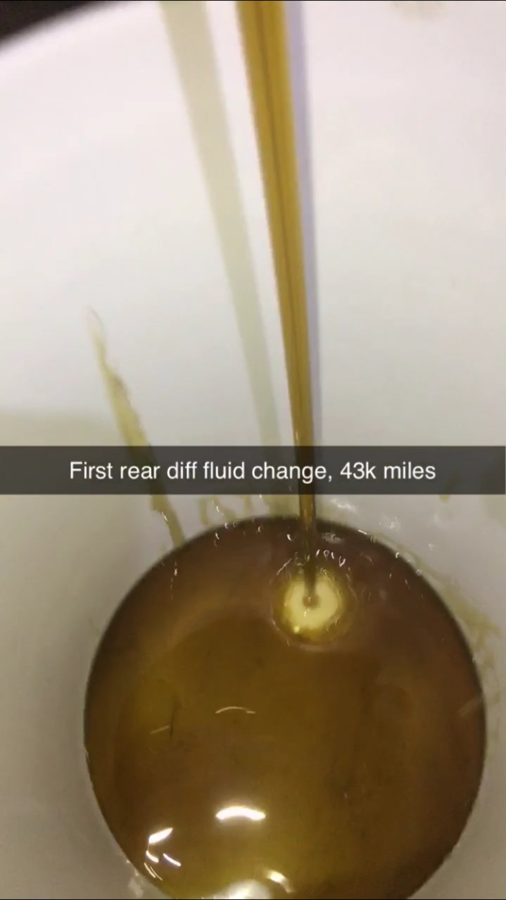

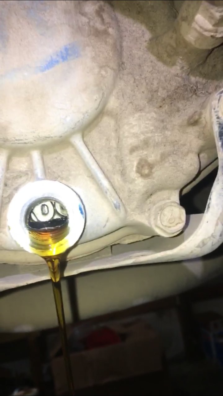

    I changed the front diff, transfer case and rear diff fluids on my brothers 2010 Tacoma today. All the fluids were the factory fill with 42,909 miles on them.

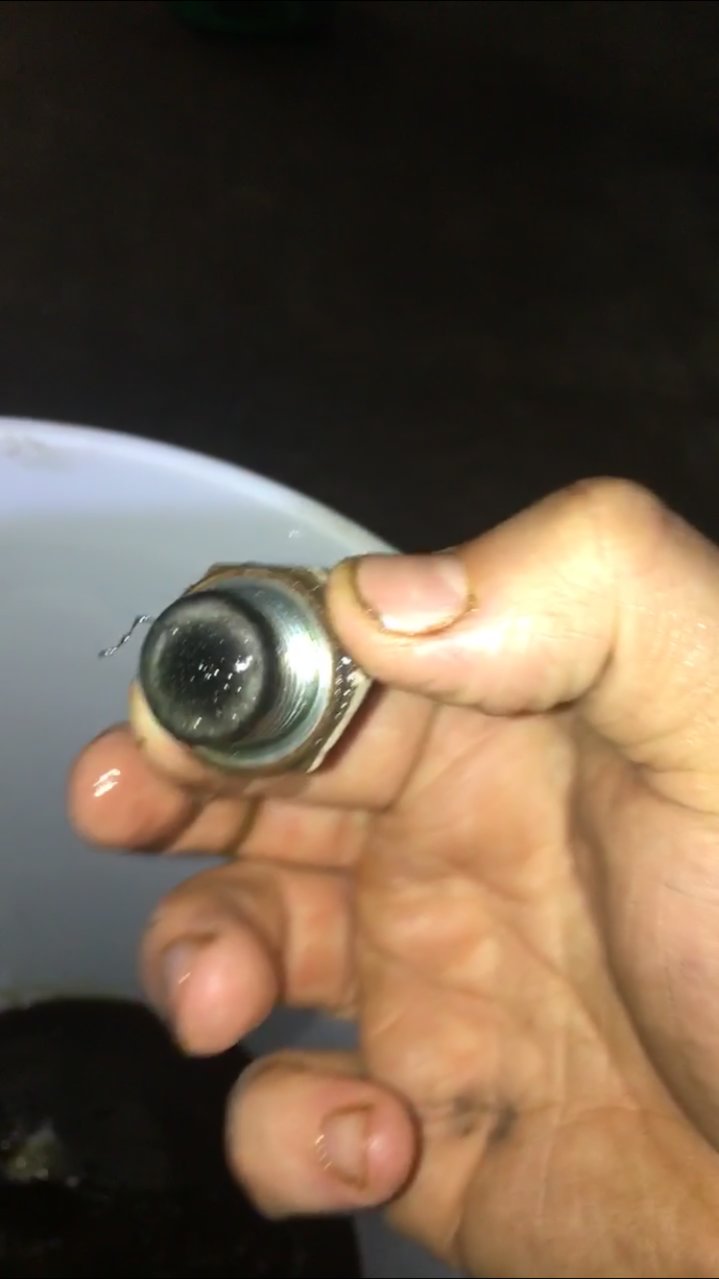

    The rear diff and transfer case fluids looked good, almost new. The rear diff magnet did have one long funny looking sliver on it, but I’m not super worried about it, the drain plug looked ok otherwise and the fluid was clean.
    The front diff fluid was nasty, I refilled it with some cheap 80w90. I’m gonna run that until the next oil change and drain it again, if it looks good I’ll put some synthetic 75w90 in it.
    I used Starfire full synthetic 75w90 in the rear diff, Amsoil 75w90 (GL-4) in the transfer case and Starfire 80w90 in the front differential. The 80w90 is only $3.50/quart so I thought I’d flush the front diff out with it. I’ll probably leave it in there for 3-5k miles and dump it.

    I wonder why the front diff is so much dirtier?

    I’ve seen a lot of people saying that was the case. Not sure why though.

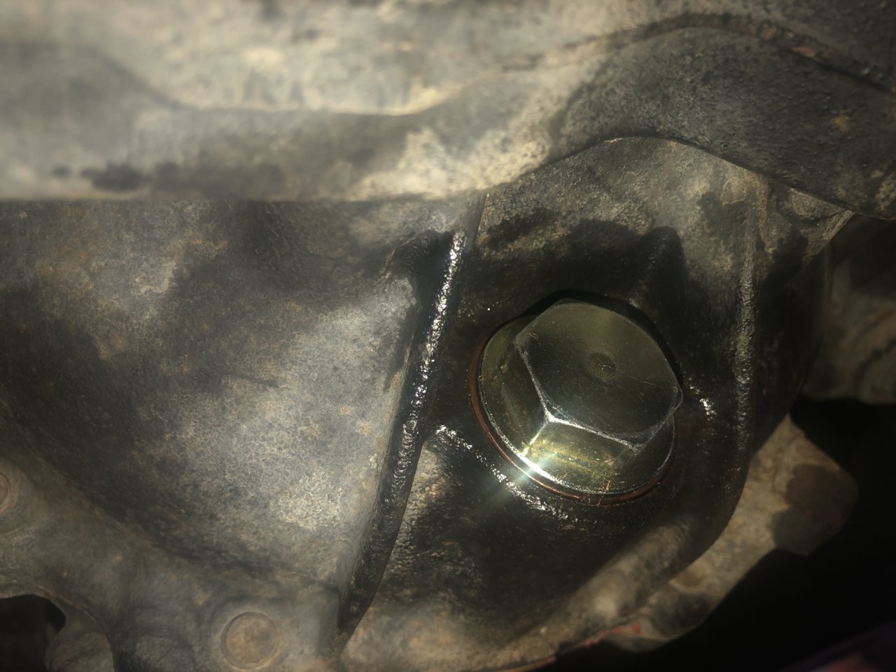

    C745B93D-ECA8-4D3E-8CB3-05CE2AF1B91B.jpg Just did this over the weekend plus one other day because I didn’t have the hex bolt and needed Amazon to ship one. Very easy. I didn’t replace the washers but plan to next time I do the fluid change. I used Valvoline 75 90 synthetic for all three and have placed cardboard under the three over night to ensure they were not leaking. Thanks for all the information. Picture is my front differential fluid. :thumbsup:

    My 07 Tacoma that I used to have was like that, the first front diff fluid change was pretty bad and then the following changes looked a lot better. I guess these front diffs break in a little harder or something.
