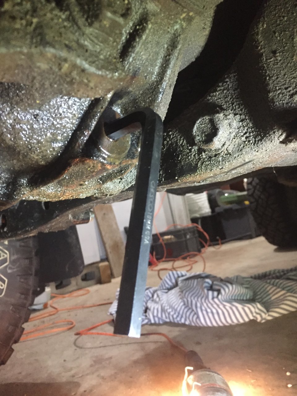

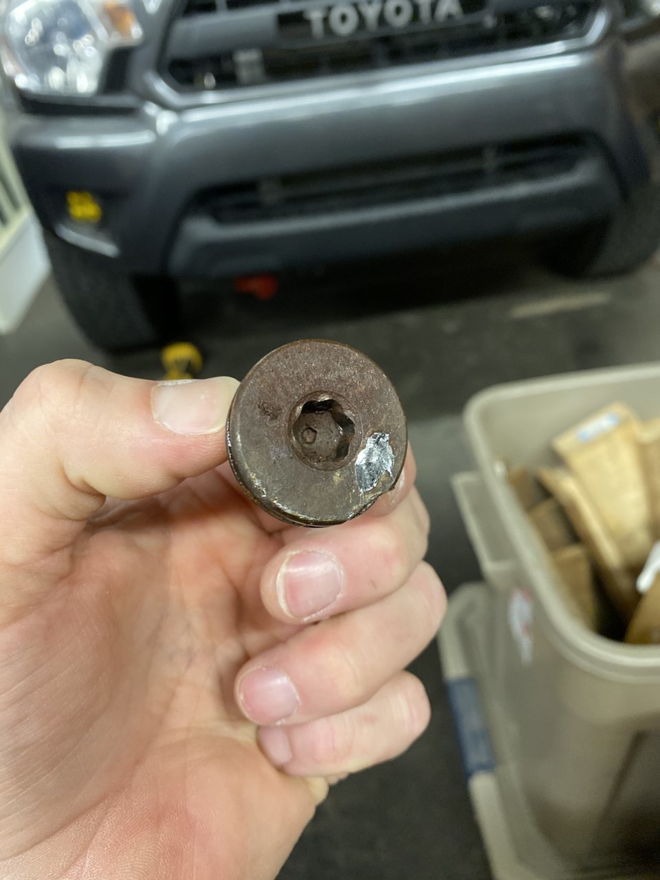

    Yep, it went great. :(

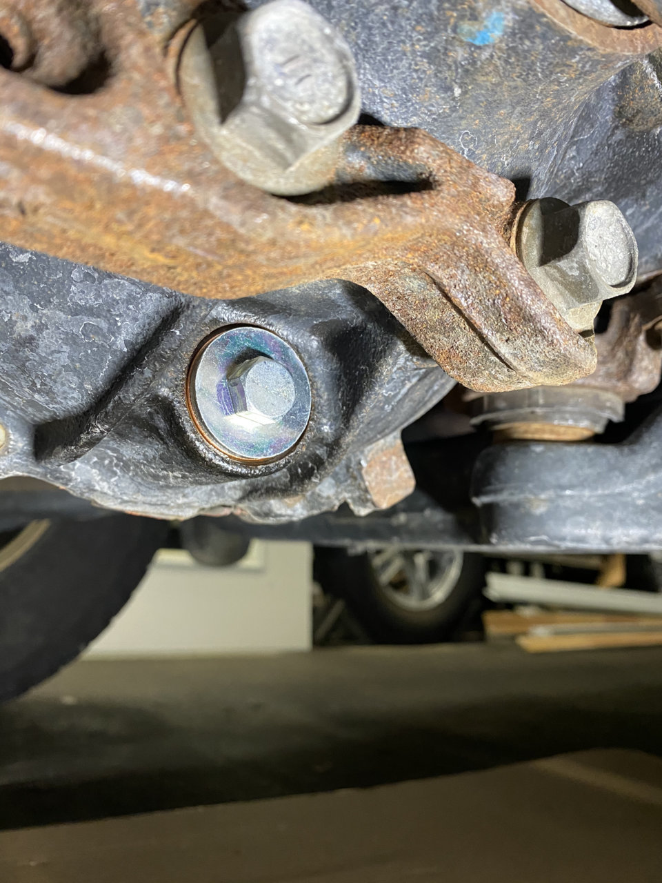

    I’m glad I bought the Lexus bolt to replace it.

    Ouch... yeah mine took a breaker bar with a pipe extension to break. Surprised I didn't damage mine like you did...

    Yeah, I tried everything I had. The chisel method was going right through it so I bailed on that idea. Breaker bar with a pipe couldn't get enough leverage under the truck. I finally used a car jack to push on the breaker bar and it finally broke it free.

    I know exactly what you're talking about. The breaker/pipe I used flexed so much it almost took up all the leverage space between the truck and ground. I ended up removing the skid plate and managed to get just a few more inches of leverage to break it.

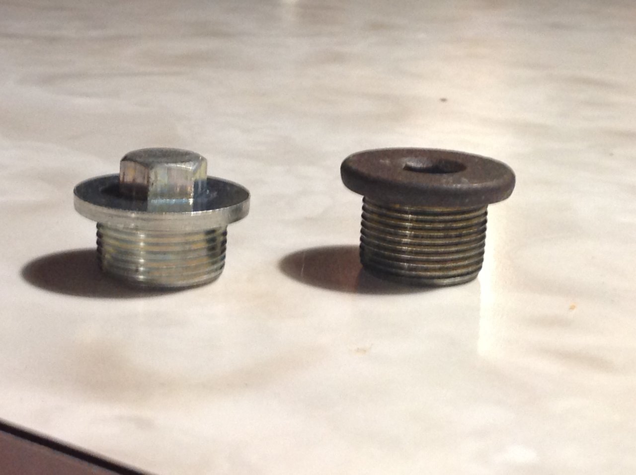

    I know what you mean breaking the torque was scary but I just put a little pipe on the Allen key and it worked. I did purchase the Lexus plug but it is interesting to note the thread depth was quite different.

    The depth shouldn’t matter. I mean I guess you could argue that the magnet doesn’t get as much exposure.

    Could I bother any of you for the P/N of the lexus plug?
  20. Apr 14, 2021 at 6:13 PM
    #1360
    Norton
    Norton Senior Member
    Mar 10, 2011
    #52729
    4,659
    Steve
    Colorado Springs, CO
    2013 Access Cab 4x4 V6 6MT, TRD OR & Tow Packages
    Magnuson S/C w/12TRDTacoma's Qwikchange Hub & 2.5" RIP-Modded Pulley, Roostfactor's Pulley Wrap Mod; FPR Mod; JustDSM Tune via HPT MPVI2; mightytacoman Intercooler Tank; aFe POWER Magnum FLOW Pro DRY S Air Filter; OME Suspension Lift (885 Coils, Dakar Leafs, NitroCharger Sports); TRD Quickshifter w/TRD 6-Spd Knob; TRD Exhaust; NSB-AGM27F Battery w/HKB Adjustable Voltage Booster & Coupe's TRD Battery Hold Down; Goodridge SS Brake Lines; Trident904's MT ADM; BFG All-Terrain T/A KO2s on FJ SE Anthracite Rims; N-Fab 6-Step Nerf Bars; BPF TRD Skid, Tow Hook, & Cooling Panel; jsi's Locker Anytime, Up2NoGood's 2Lo Module; ramonortiz55's Always on Power Outlet Relay, ND4's Fog Light Anytime, & Crom's Speed Bleeder Mods; crashnburn80's Ultimate Headlight & Fog Light Upgrades; ThreatLevelMidnight's Wireless Charger; 4Runner 4X4 & FJ Fog Light Switches; redtaco2007-inspired LED License Plate Lights; AudioControl LC2i LOC, JL Audio XD200/2v2 Amp, Focal PS165V1 Spkrs, Sound Ordnance B-8PTD Sub, Hushmat & Noico Sound Insulation; loginfailed-inspired Speedhut Boost & AFR Gauges in a Lotek Pillar Pod; Ltd Auto-Dim/Compass/Temp/Backup Camera/Homelink mirror on ImMrYo's Mirror Lift Bracket; TacomaBeast Glove Box & Console Organizers; Husky Floor Liners; UltraGauge EM; mesojdm's Ultimate LED Dome & Map Lights & GASSHOLE; Redline Tuning QuickLIFT Elite; Mobtown Offroad Locking Bed Storage Doors; Toyota Bed Mat; Cali Raised Led Bed Stiffeners; Pop & Lock Power Tailgate Lock w/TacomaTruckParts Support Bracket; ARE Z-Series Cap, SolarGard Tint; BlendMounted & MirrorTapped Uniden R3; CravenSpeed Stubby Antenna; Amsoil Lubricants; Adam's Detailing Supplies
    It's been a while since I bought one, but I THINK it's 90341-24016.
