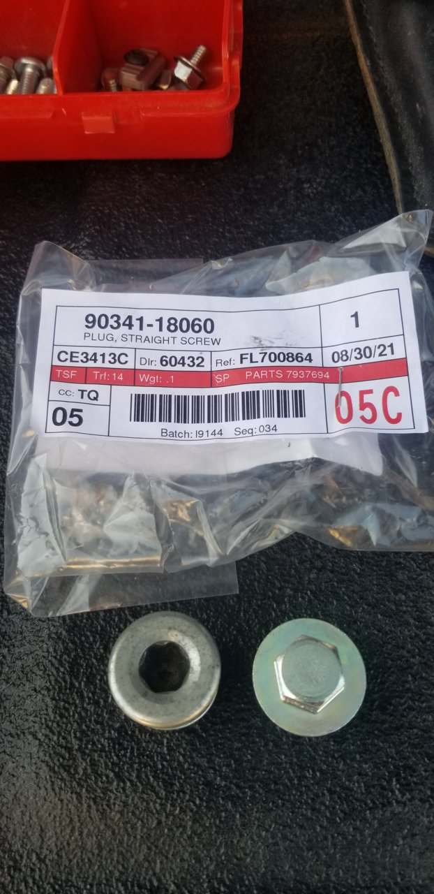

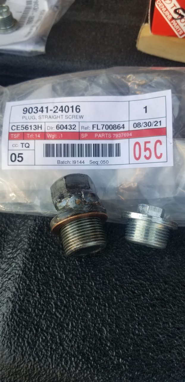

    This was a very helpful thread. I just changed all my fluids again but this time the front diff drain plug gave me fits. Tried every trick I know to get it out. Replaced both front diff plugs and hopefully will never have that problem again.
    * these were Lexus part #s

    Just ordered the Lexus drain plug 90341-24016 and 90341-A0002 for the fill plug. Someone above posted a different fill plug P/N. Did I get the wrong one?
    Edit: crap i think the other P/N is for the rear housing. Hopefully I can update my order.

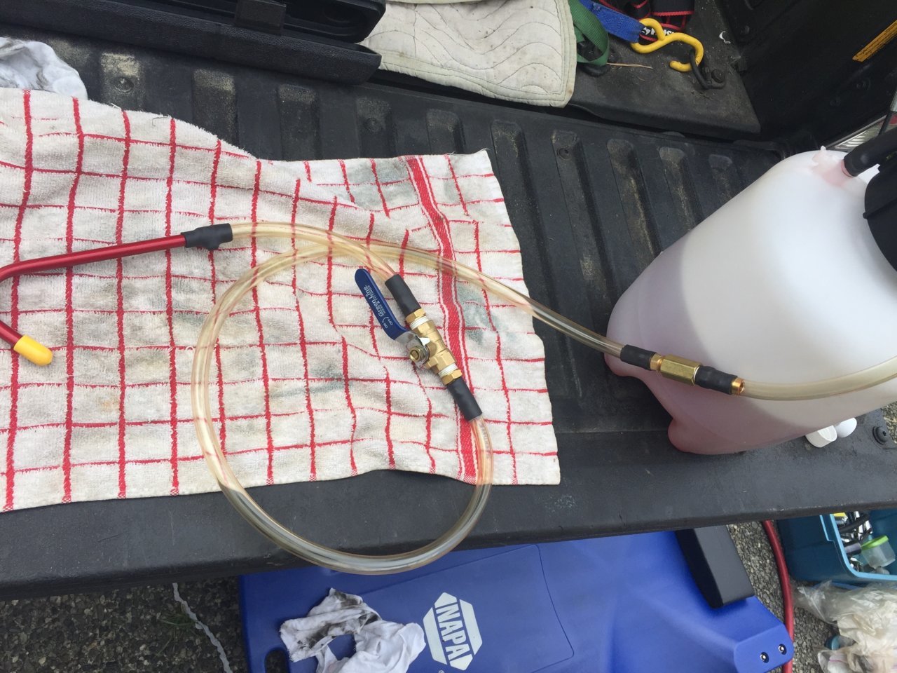

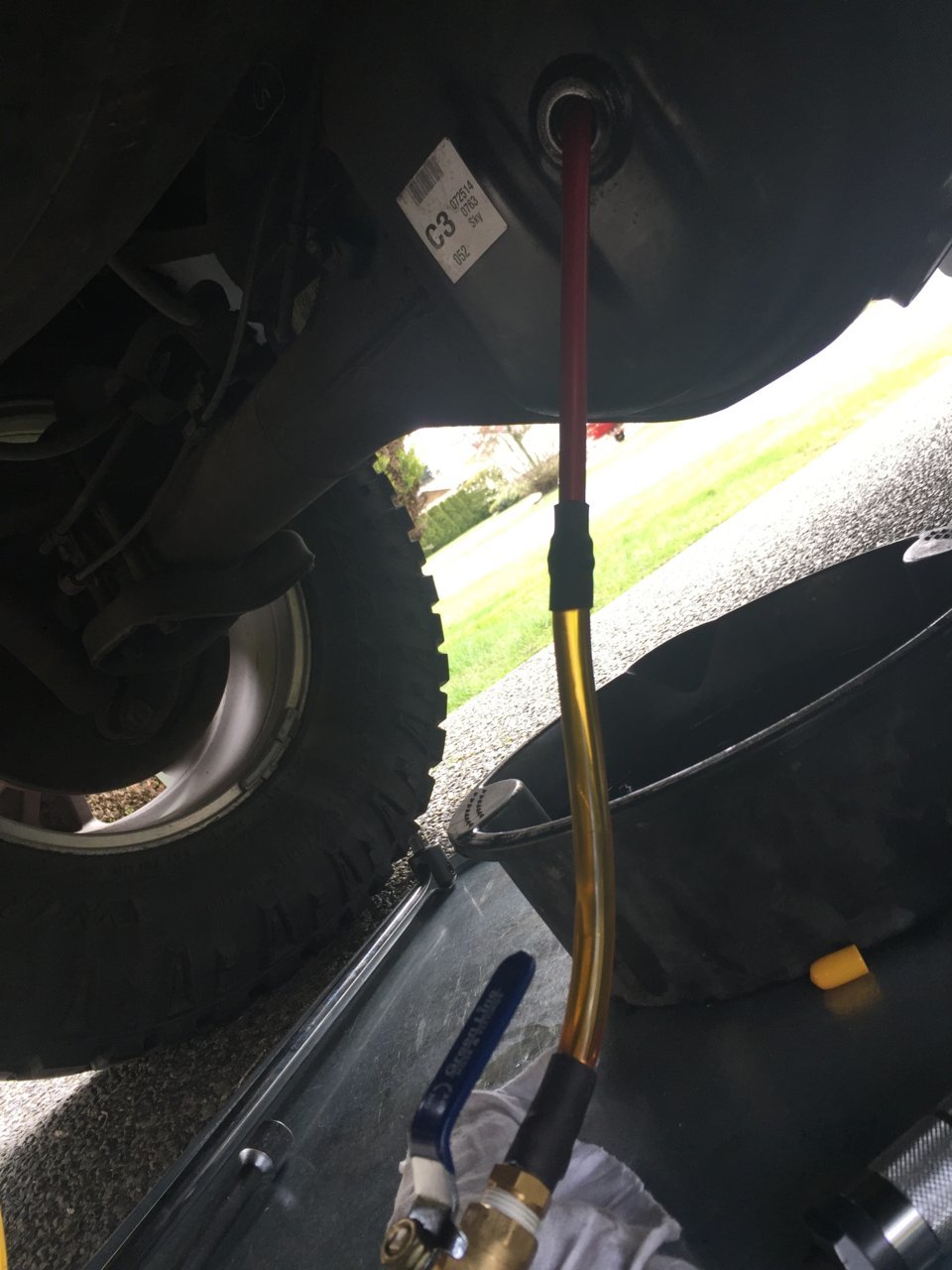

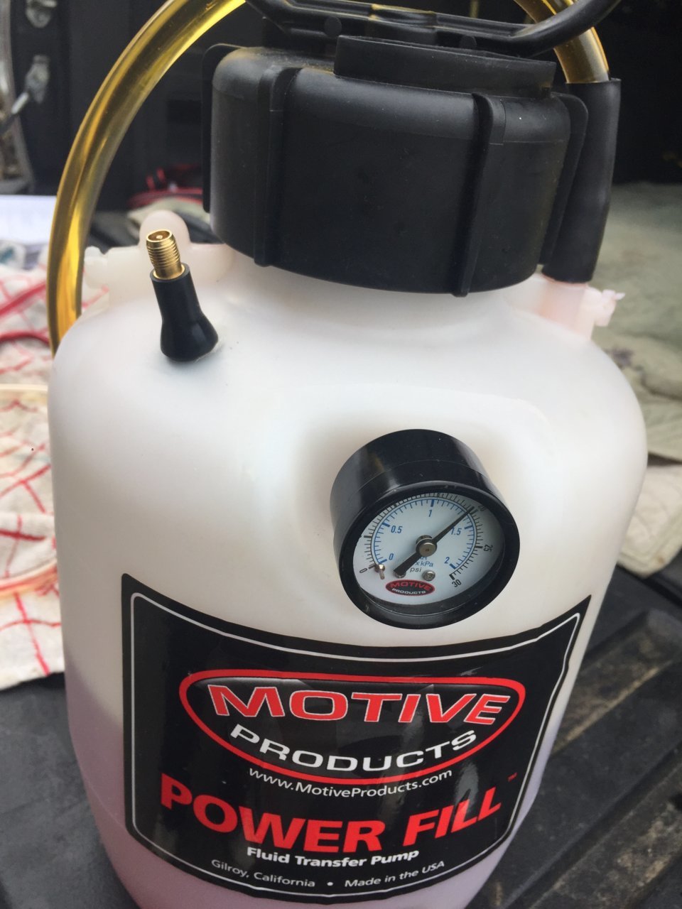

    Good Day Everyone - Hoping everyone is well.
    Thought I would share some ideas on how to fill the Differentials and Transfer Case on our Tacomas but also can be used to fill the Transmission and help bleed breaks. Came up with the idea sometime ago and I've since used it several times. Full disclosure, I tried using the pump and found it somewhat difficult and challenging to use so I tried made this up ....enjoy.
