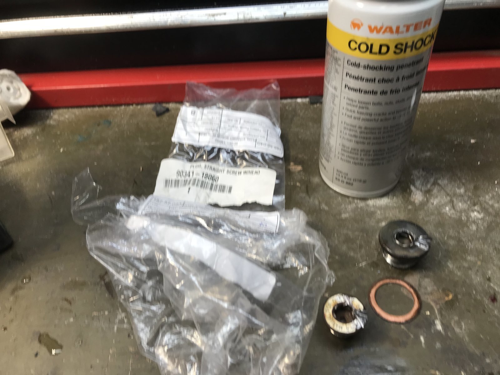

    Just did my fronts, Makita 1/2" impact gun would not budge them.
    Used 2 hours soak of WD 40,
    then I tried this , used a chisel, they loosened easily .
    Hope it helps someone along the way, had the MAP torch ready,,,.
    1st time trying the cold spray.
    Replaced plugs with the Lexus model, 14mm hex head.
    O'DubhGhaill[QUOTED] and 007fodo like this.
