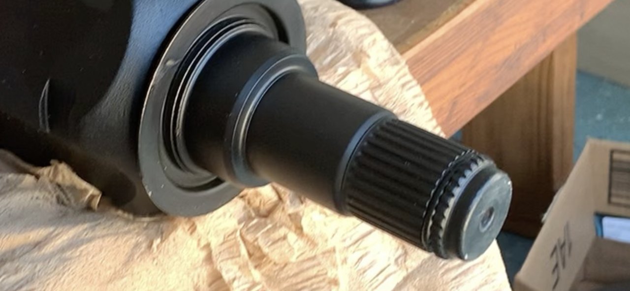

    Hello TW, i'm jumping in this thread with this sort of off topic but related question: Does the painted (bearing/ bushing) surface of this new remanufactured axel (from CVJ Axel -Denver CO) give any concern? Obviously the old CV's wear surface is shinny smooth bear metal from 237k miles of use.... OR am I overthinking this?

    CVJ has a great reputation and I have to assume they know what they are doing, but I am surprised like you at this. I wouldn't have expected it either. I guess we will see what anyone else says. Maybe wait till Tuesday and ask them directly?

    another in another thread said they had installed 2 axels from CVJ that looked like this.... so... it's going in after lunch....
