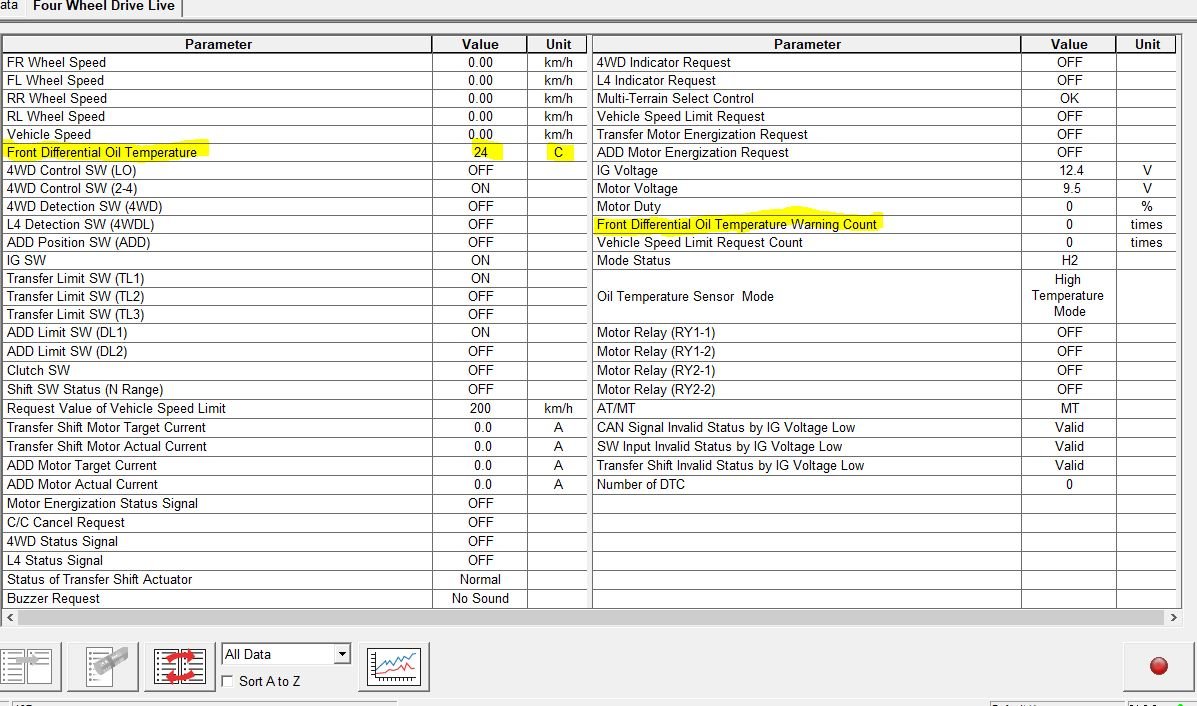

    Seems my truck has the sensor..
    Skydvrr and Stocklocker[QUOTED] like this.
  10. Aug 30, 2021 at 4:02 PM
    #30
    MOC221_
    MOC221_ 3 pedal metal
    Feb 20, 2016
    #178858
    7,850
    Frank
    2019 DCSB Sport M/T Barcelona Red
    vF Tuned; ADM; Core SS
    Well, this seems pretty convincing..
    ..also read from my truck using techstream.

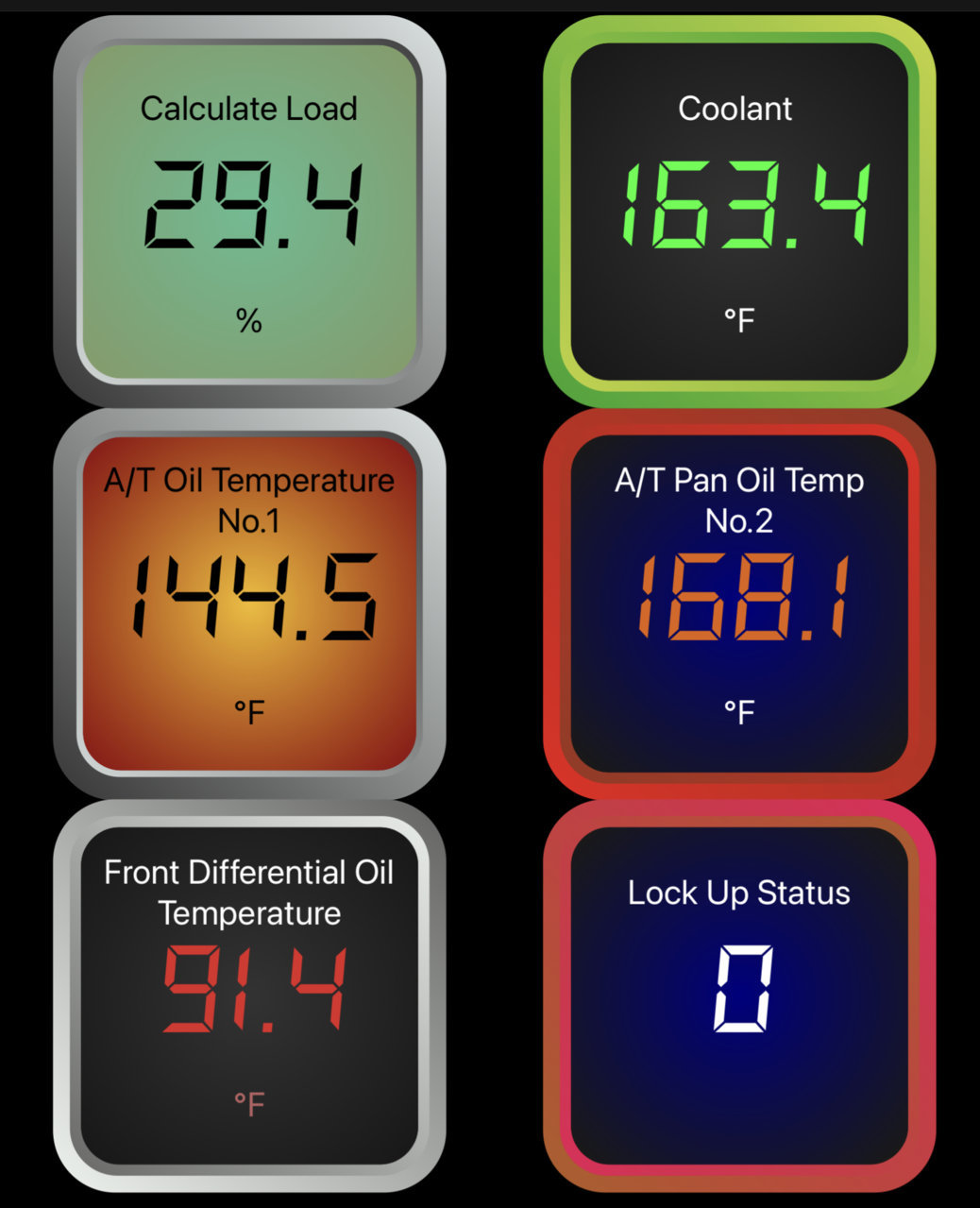

    I notice in the available Toyota monitor points in OBD Fusion it has the Front diff temperature, as well as a point for the number of times it’s exceeded alarm value.
    Maybe the second item gives the dealer some leverage if you grenade your from diff and they see it’s been in alarm 20 times etc.
