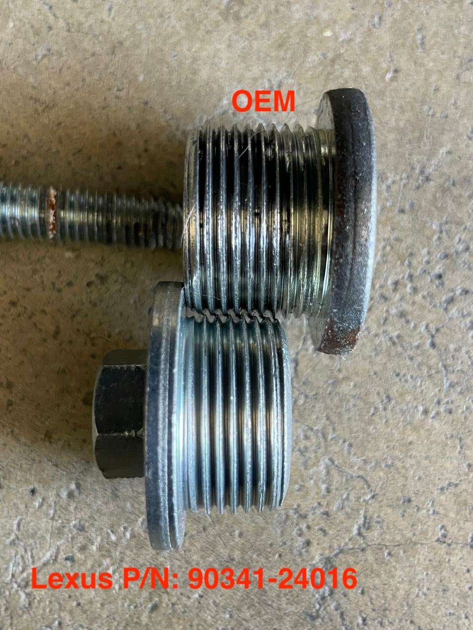

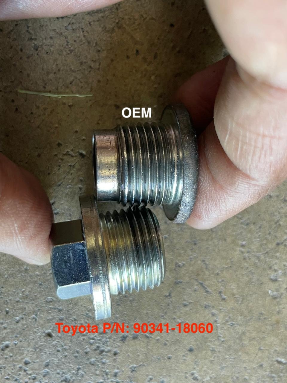

    Hello all,
    I am changing all the fluids on my 2019 Tacoma Off Road. I am going through several threads on this and other forums and read about stripping of front differential bolt(s). I successfully removed the dangerous infamous front diff drain and fill bolts. I may not be lucky next time. So thinking about changing both drain and fill plugs.
    So far I gathered Lexus part number 90341-24016 can be used as an alternative for 10mm HEX OEM drain plug. My question is - Can the Toyota part number 90341-18060 be used as fill plug instead of the 10mm HEX OEM fill plug on third gen Tacoma? Any help is greatly appreciated. Thank you all!
    Reference: https://www.tacomaworld.com/threads/front-diff-drain-plug-alternate-oem-part.604989/page-6

    I replaced the OEM drain and fill plugs of the infamous front differential. Threading pattern looked the same. Length of the replaced plugs are lesser than OEM's which made me feel safe - that they won't be hitting anything inside the FD. I put 2 images for comparison of both plugs. Took for a spin. Ride felt fine. Now going to top off the FD fluid and going to update all about Ravenol fluids, after driving at least 200-300 miles. Hopefully there won't be any issues! Thank you all for the replies!
    Purchased both the parts from https://www.ssl-parts.com/
