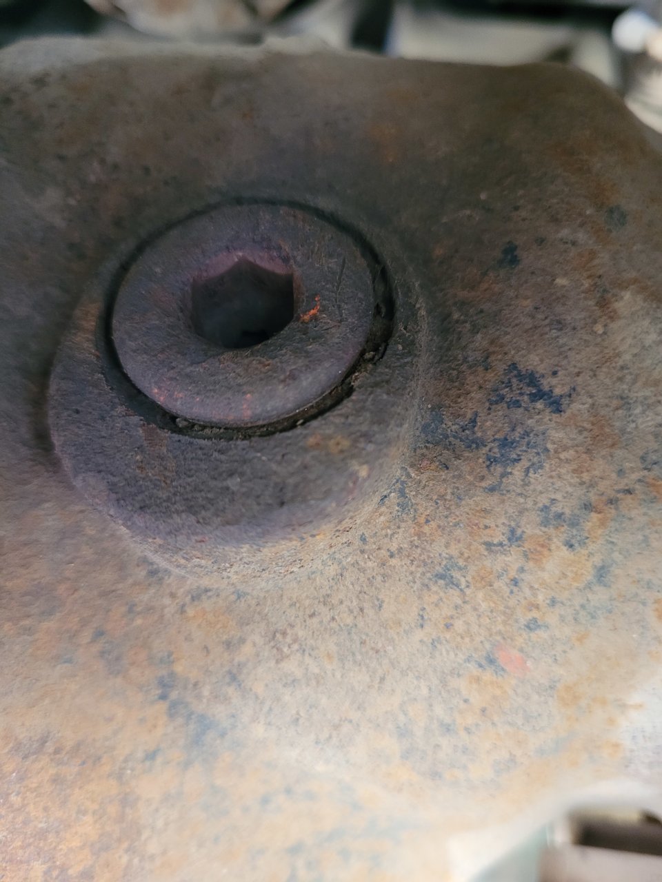

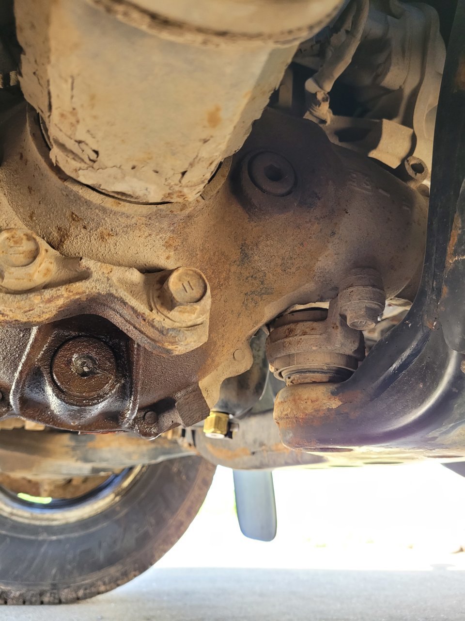

    It's had pb blaster sprayed for the last 4 nights and let sit. Got nothing out of a 2 foot breaker bar. Ran the impact on it (cordless craftsman 1/2 in), and that stripped the bolt. Tried a chisel counterclockwise and nothing. Most of these attempts got some heat from the torch but nothing excessive. I guess my next move is hammer an 11mm hex head in there?? The fill plug is good to go, just getting whooped by the drain plug. Any suggestions
    Drain plug:
    Fill plug:

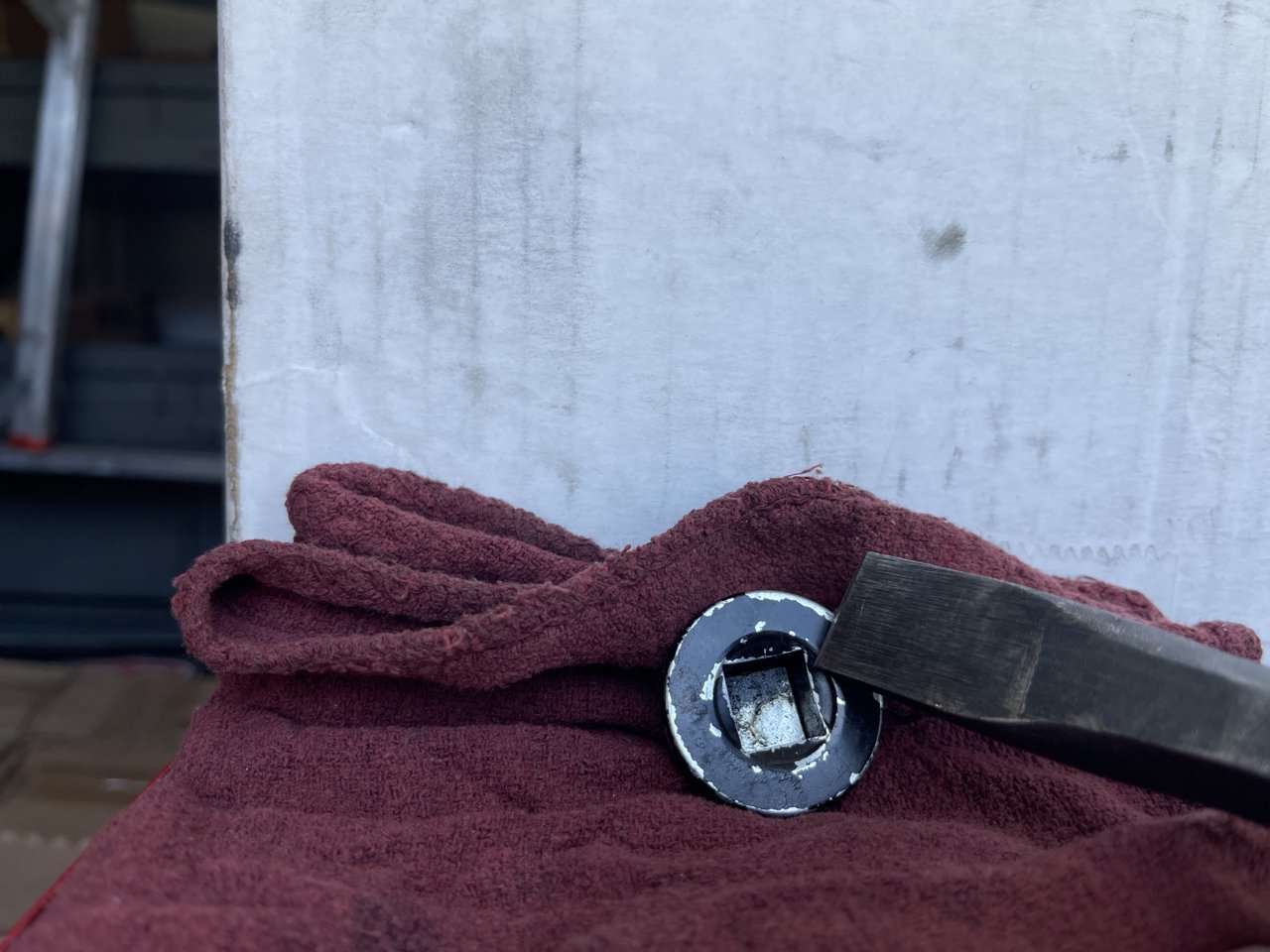

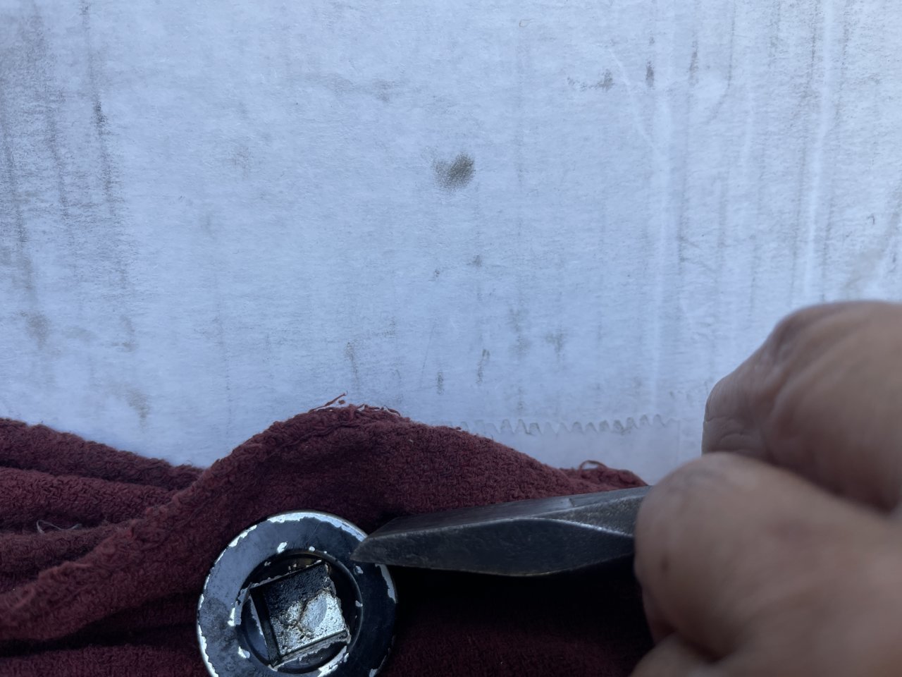

    Looks like the the hex bit part is already stripped out, bummer.
    Welding a nut on will most likely be the only way.
    One more attempt before you do that. Looking at you picture, try going at it with the chisel but with a different angle of attack.
    2 pictures, first your angle of attack. Second, try that being careful not to hit the differential, just hit the plug.

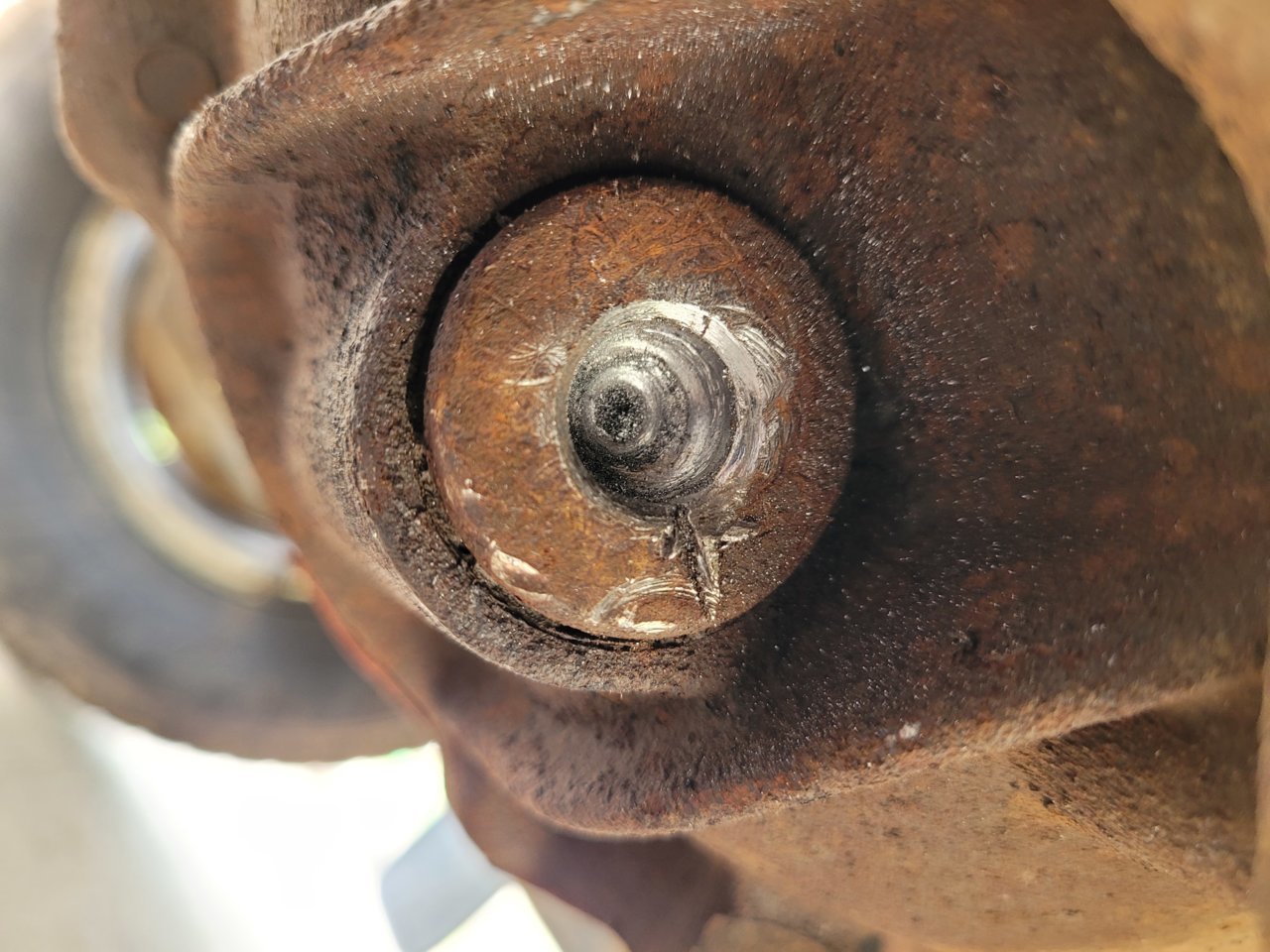

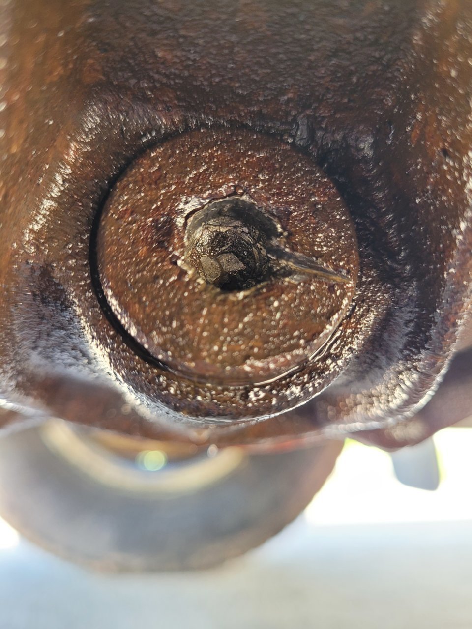

    Tried the extractor, made a pretty circle. Think I'm gonna find someone who welds now.20220330_082149.jpg 20220330_094355.jpg

    Use a bigger extractor on a screw knocker in an air hammer. It would have been easier if you initially used the proper hex in the screw knocker, and I was going to suggest pounding a bigger hex in using a screw knocker, but it looks like it's too late for that.
    Screw knockers (sometimes called "old man" (I don't know why)) have been used in the aviation industry for decades when it comes to stuck fasteners. They are quite readily available these days.

    I'm gonna say welding a nut on is the only way left to get that off. the metal of the plug is just too soft for anything to actually grip it and hold
