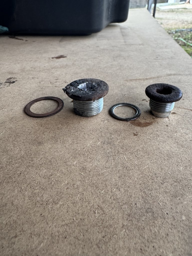

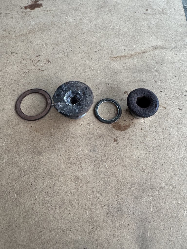

    My front differential drain plug was stripped bad. (left - drain plug, right - fill plug).
    I was able to remove it with ease using an air chisel/hammer in just a couple of minutes. First I made a notch in the drain plug using a chisel and hammer so the air chisel was guaranteed to bite. Then I just tapped the trigger on the air chisel and it broke free.

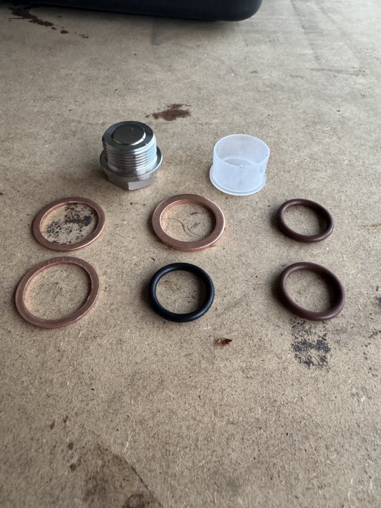

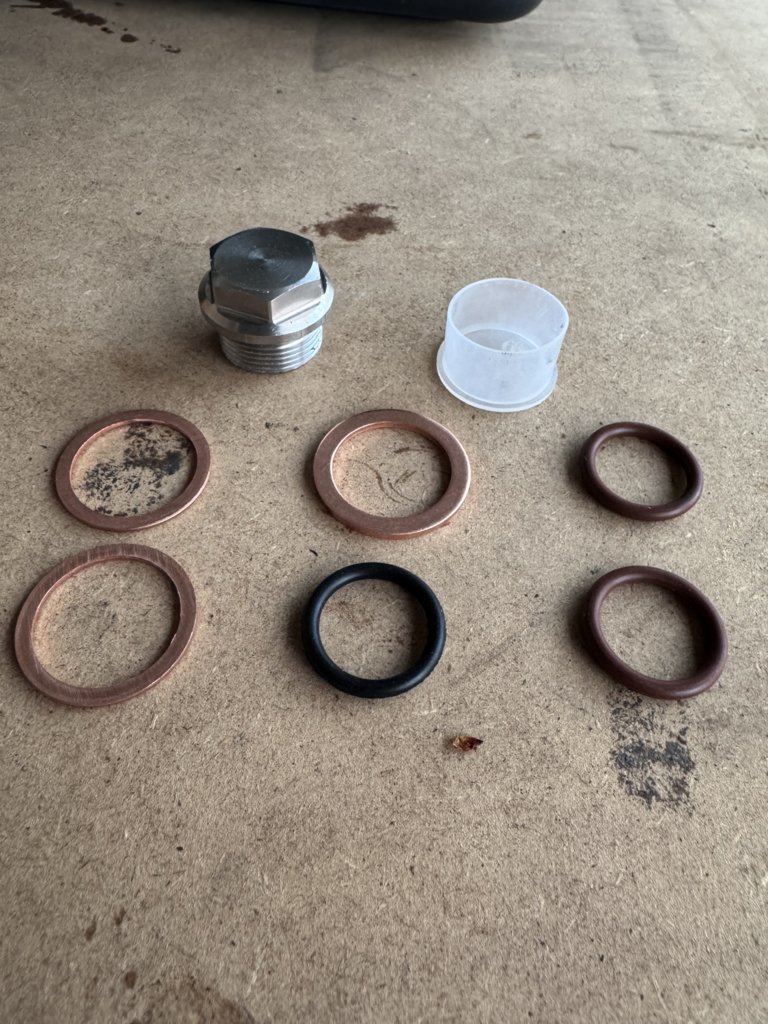

    I replaced the drain plug using this one from Amazon (https://www.amazon.com/dp/B0BDR7F6SF) using one of the included copper washers. The drain plug is a 22 mm Hex head.

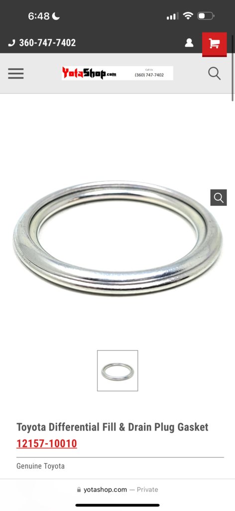

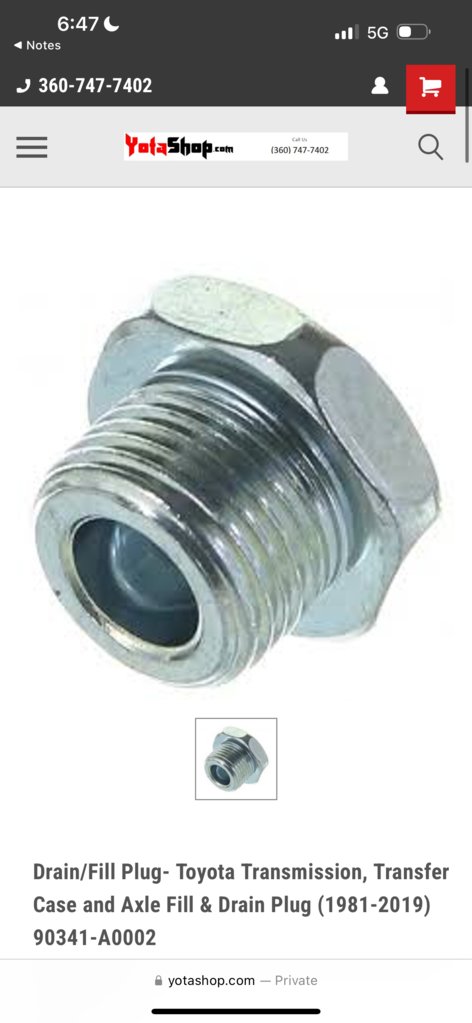

    I also replaced the fill plug using this one from YotaShop. It is a 24 mm Hex head.
    Using one of these crush washers:
