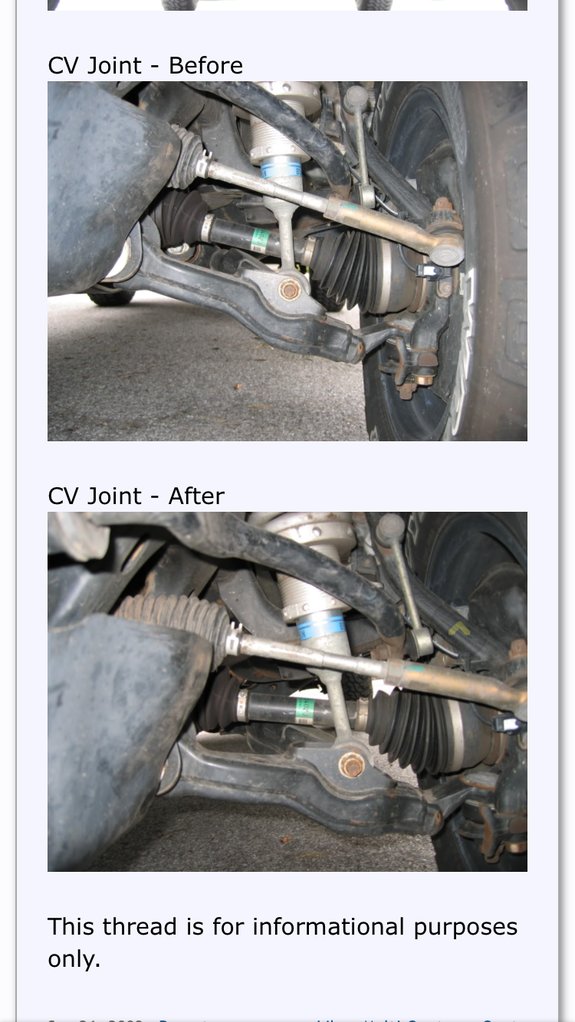

    I still can't believe one guy had a problem like 8 years ago on his race truck where he crashed into a boulder during a race and since he was running a modified skid plate that pretty much made the mounts a huge bullseye, it did major damage.
    This was the one and only guy to have ever had any kind of problem running a diff drop and yet a large group of folks have made them out to be the devils product :rofl:
    One guy. o_O
    https://www.tacomaworld.com/threads/diy-how-to-install-a-toytec-diff-drop-pics.53991/

    I thought people were also concerned because it's not really a Diff Drop, but it rotates the diff? The new angle *could* prevent oil from properly lubing up the diff or something..

    Lol since nobody has ever had that issue I can't see it being a problem.
    If that were true(and the oil sat in the diff perfectly still) we would all have issues driving up or downhill for extended periods of time. :thumbsup:
