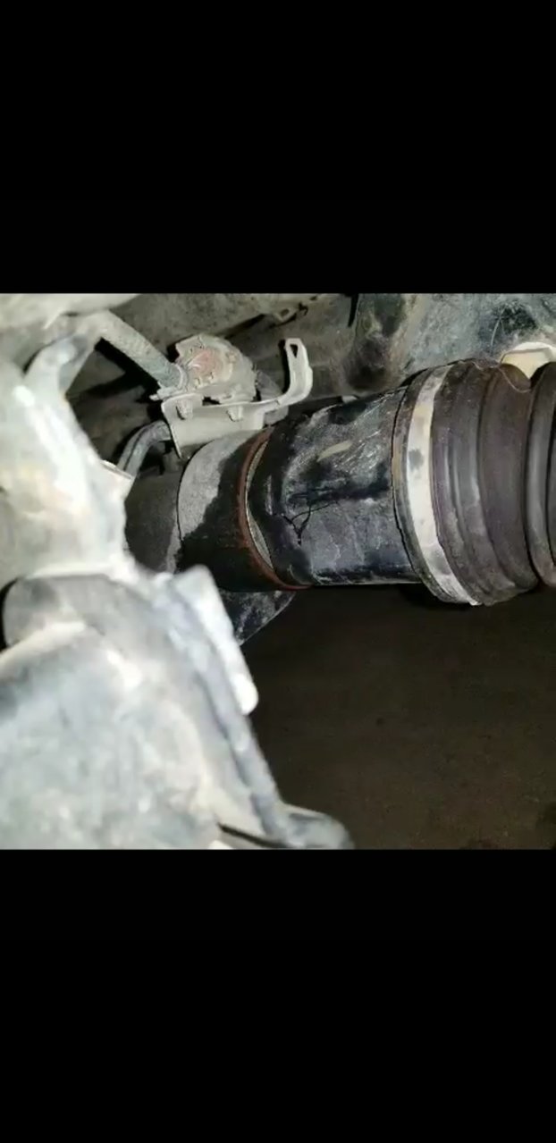

  12. May 24, 2020 at 11:40 AM
    #32
    Mxzach100
    Mxzach100 Member
    Jan 24, 2020
    #317119
    9
    Zach
    2018 Dblcab L bed &89pickup
    Lift.
    My passengerside seal just started leaking out of the diff. I heard maybe the brother tub getting clogged can creat pressure and push glued out the seal. Anyone Screenshot_20200524-113812_Video Player.jpg Resized_20200514_123145.jpg else experience this?
