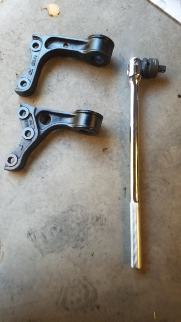

    Finally got mine done today. Mine were shot.
    Pretty straight forward.
    Three things to consider.
    1)Make sure you have a 2 foot breaker bar for the bolts, mine were hard to break loose.

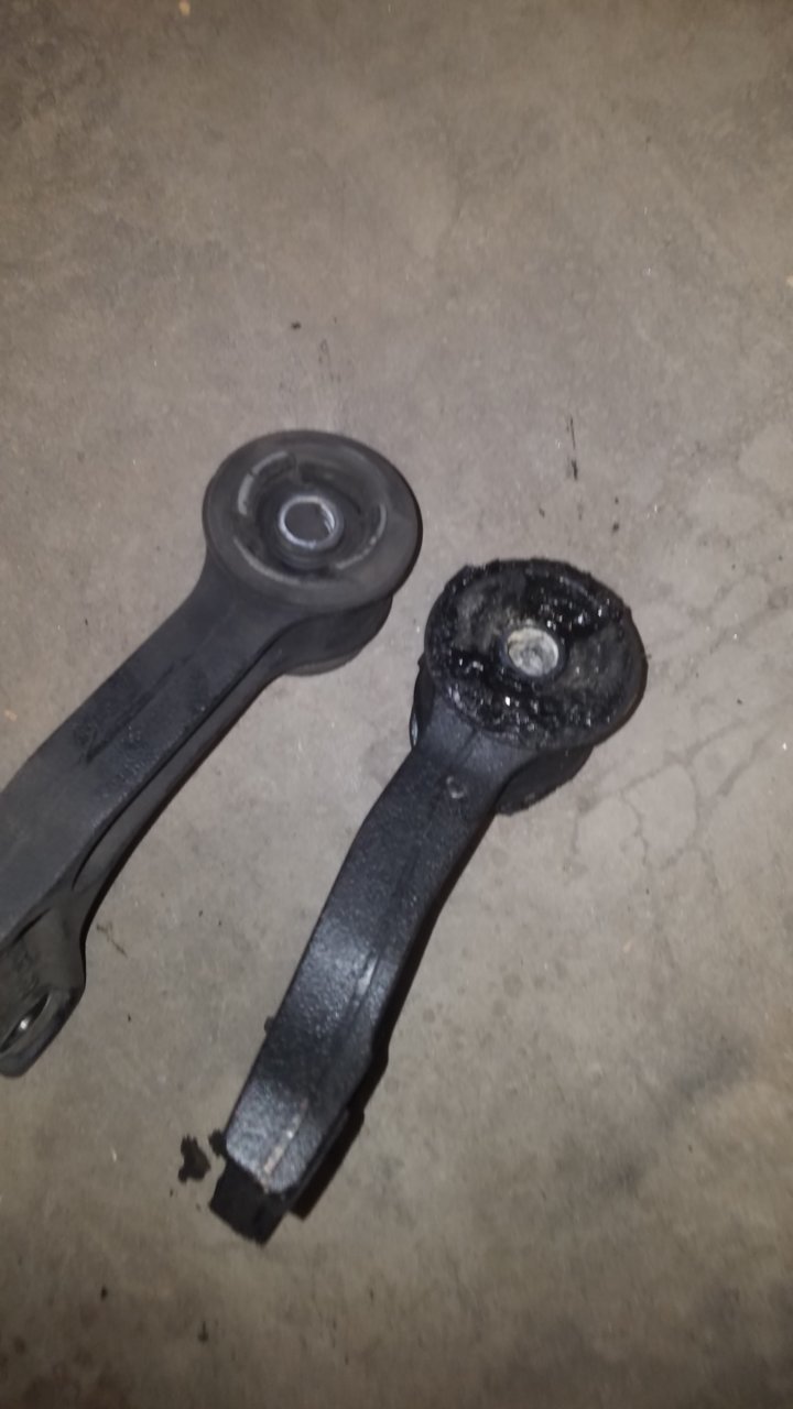

    2)use an acetylene torch not a propane if possible to heat up the bracket to remove the rubber inset.
    I used the propane torch on the first one and it took quite a while 15 minutes to get it out and made a mess.
    I then used the acetylene torch and it popped out in 3 minutes and a few minutes to burn out the inside clean.

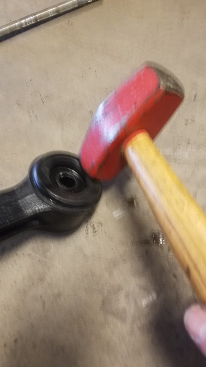

    3) I used the channel locks to get the new bushings in, took a while going back and forth from side to side.
    The 2nd bushing I used a large hammer and went in with two hits useing antifreeze as the lube.
    Great product

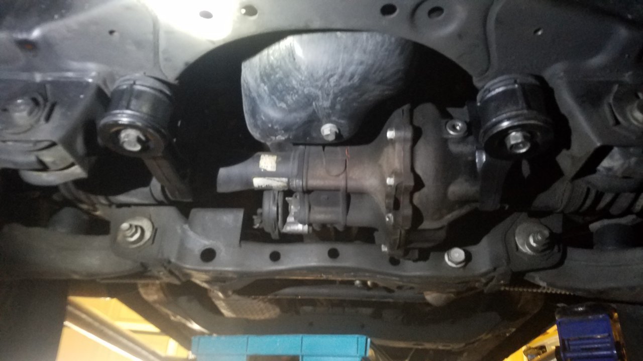

    Front ends feels tighter, one of my diff bushings was totally shot and not holding anything.
    Easy job to do.

    I took the remaining bits out with a nylon brush on a drill. I couldn’t seem to get the rest of it out with my propane torch. Once it’s all out they just slide in and don’t need a press.
