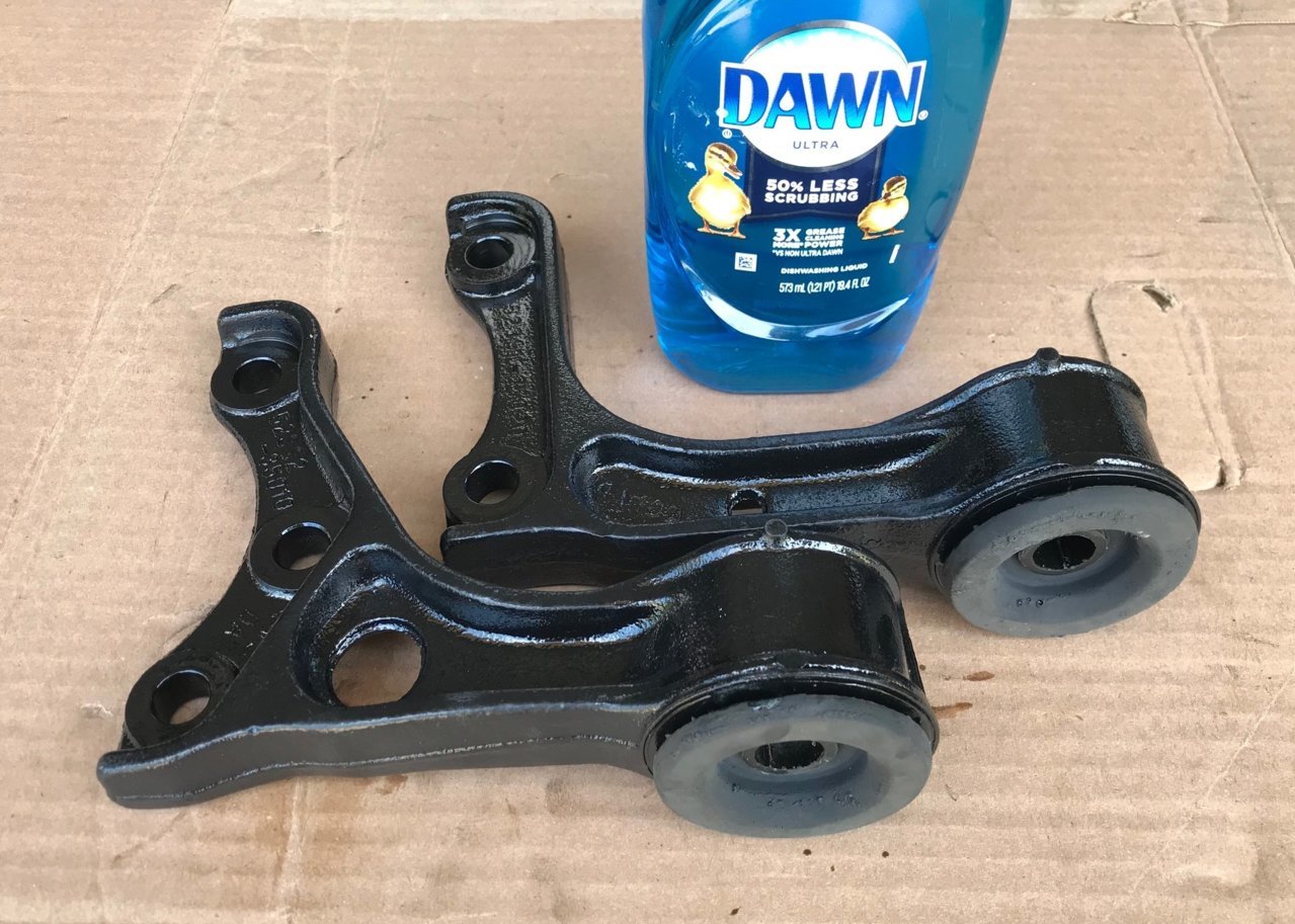

    Ordered for 1st Gen '97 Taco. My OEM diff. mount bushings are definitely showing their age. Plastics Guy emailed that they are about 2 weeks out right now.

    word of advice - keep the torch going evenly and take your time until you hear it pop a bit (separating itself). Pry before you hear it start to pop its just going to be a huge mess. Also, don't let the bushing catch on fire.

    Appreciate the advice! As you suggested, lots of even heat was the trick to getting the old bushings out. Mount brackets were cleaned up then repainted. A good bit of Dawn made for quick installation of the new bushings. They pushed right in by hand. Easy-peasy!
    EDIT: Ordered on Aug 22nd and received on Sept. 1. Excellent service and communications!
