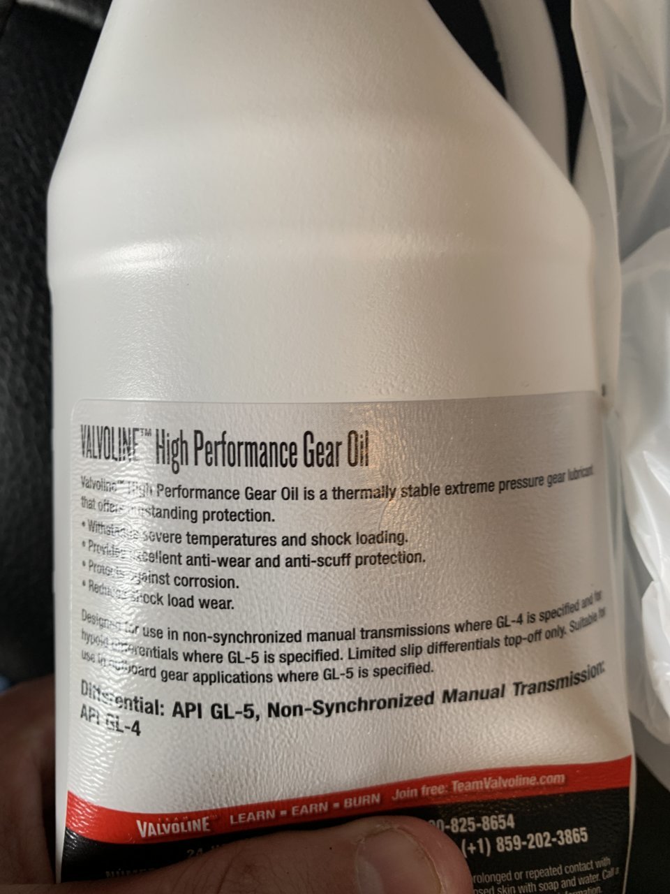

    This is the 80w-90 that they were recommending. It says only for top off for limited slip. This shit is so annoying. I wish the manual just told you.

    That should be fine, you put in about 3 qts right? You did a full drain and fill? I typically will put in about 2.5 qts, then wait about 10 min or so before I put in the last half qt to allow the thicker gear oil to run down the axle shafts before it starts dribbling out the fill hole. If you were to add your LSD additive, I would suggest adding it after the 1st qt to help mix it up when you're adding the additional qts.

    ThTs what I did. I did 2.5 and now letting sit. Added the LSD additive after first quart. Thanks. I’ll let y’all know how it goes and if it fixes it.

    '05-08 Sport have the mechanical LSD. The clutch packs will chatter if you don't put the full tube of additives in. Brand doesn't matter.
    Either way is fine. With leaf springs, the axle doesn't rotate much when drooped, so your fluid level should not change.

    Ok, the diff additive was the solution! The bottles lie haha. They say it includes additive, but it is not enough if you have LSD. Thank you all so much. I was so worried I would ruin my diff.
