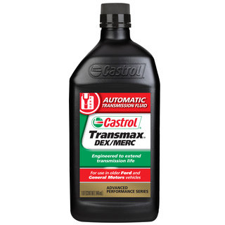

    The only other thing I could think of would be the steering rack oil I used. But I doubt it.

    As far as the steering rack goes. I put it in because the old one was leaking. I also put the brand new Moog inner and outer on.
    What do you mean by void or pocket in the rack? Like not bleed correctly? It drove fine for 500 miles. Nothing was unusual. What do I need to look for?

    Which Dex version is that ATF? The steering on these is very specific about wanting Dex III.
    I think low front diff fluid is a red herring, this is something steering specific.

    Ok so I googled that particular product and it looks OK to me.
    How much fluid is in the power steering reservoir? It could be that its leaking and spraying to where it looks like you've got a diff leak.
