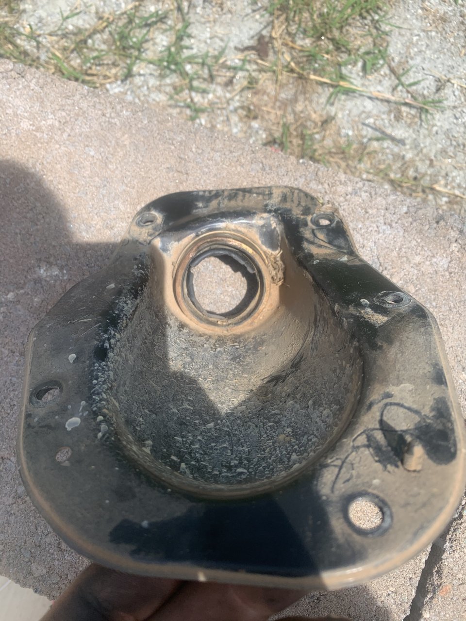

    Thanks for the help guys, spent most of the day trying to get stuff sorted.
    Drained the diff and it had 0.5 quarts. Capacity is 1.4 quarts. Used Valvoline 75-90 dino. Bought 5 quarts. Came back, filled it and it was leaking worse than ever. Called around to a couple places so see if anyone could do CV seals and none in a timely manner and none that I want to pay an arm and leg to do, especially since Im capable of doing it on my own, I just need to get to my destination. Really wishing these had manual hubs.
    Looked around and found this product called "BlueDevil Stop Leak" They say it should work on diffs. Its supposed to swell the rubber seals. So I bought it and put it in to see what happens.
    Checked everything with the rack. Everything is tight and nothing has changed.
    Its still doing the thing where it keeps going the direction I turn and not returning to center. I took a look at the wheels and the passenger side has negative camber and the driver side has positive camber (hmm). Symptoms of off camber can make the wheel not return to center.
    Decided to take it to a shop to check alignment to rule it out and the guy talked me out of putting it on the rack even though I was telling him I can see with my bare eyes that the drivers side camber is positive. So I leave and then Im thinking maybe I should let go of the wheel and just slam on the brakes to see what happens. As soon as I slam on the brakes it pulls hard to the left. Then Im like, fuck I knew it was off. I turn around and go back and the guy is gone for the day. No wonder he talked me out of checking it.
    It could be the rack but Im thinking not. When I turn the wheel at a stop, it moves normal. Its not dragging or underpowered. And when I take the cap off the pump its swirling pretty damn good.
    Going to a shop in the morning and demanding it be put on a rack. Ill get back with the results. As far as the diff leak goes, Im gonna keep my skid plates off and check/top it off every 500 miles. We shall see if that BlueDevil Stop Leak does anything. They say it takes 100-200 mile for it to take effect. So far I put 50 on it.

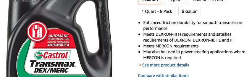

    Looks like its rated for it
    0xDEADBEEF[QUOTED] likes this.
