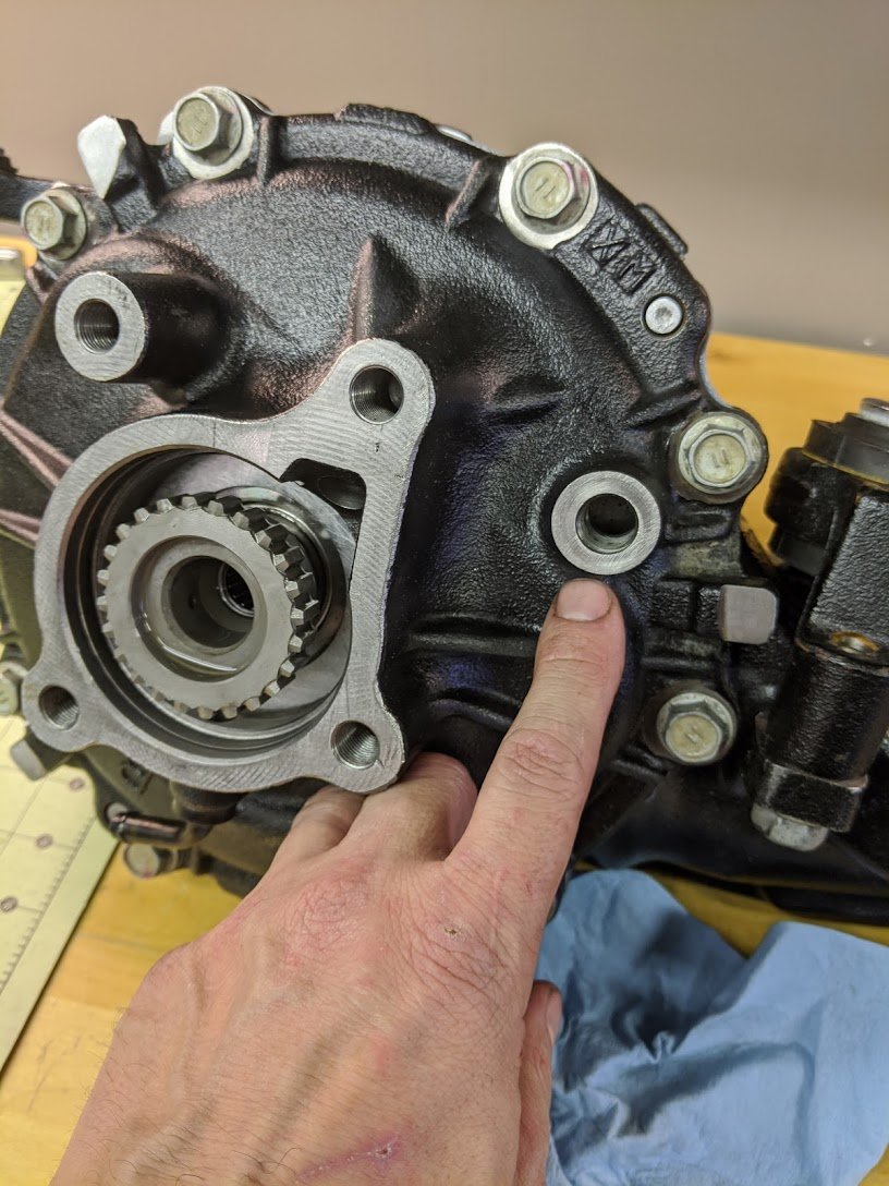

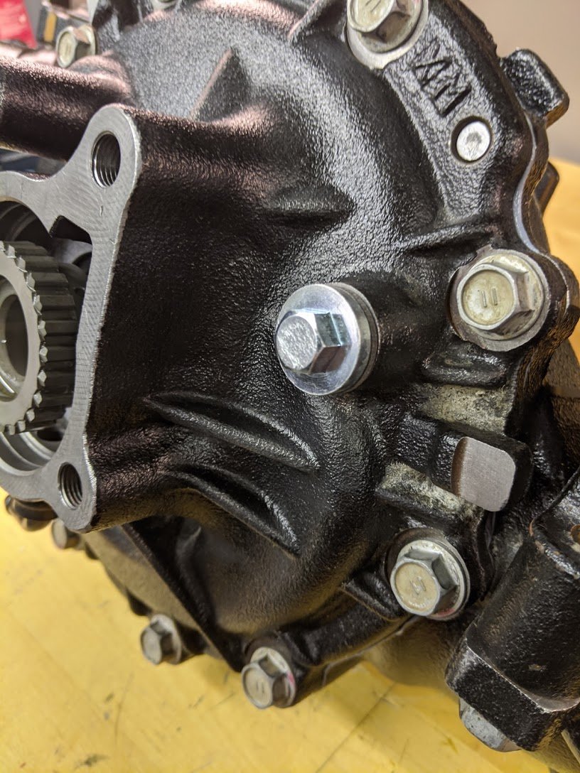

    I have a 2020 TRD OR Auto in an Access Cab... When installing my gears and front clamshell from ECGS I unfortunately had an extra hole in the EGCS one and didn't have it in my factory 2020... After a panic moment and some research I found out it was for the temp sensor and was also the same thread pitch as an oil pan plug.. A quick trip to the auto parts store and I was back on track.
    I contacted ECGS the next day and they had no idea some of the 2020's didn't have the temp sensor. I would have assumed that anyone ordering from them with a 2020 would have to clarify before they send you a front clamshell...

    Left is my stock 2020 TRD OR Auto Access Cab - Right is the shell from ECGS with the temp sensor hole... I'm guessing an access cab thing...
    My Fix - - I've got 13K on the gears now and no leaks... used Gasket Sealer as well...

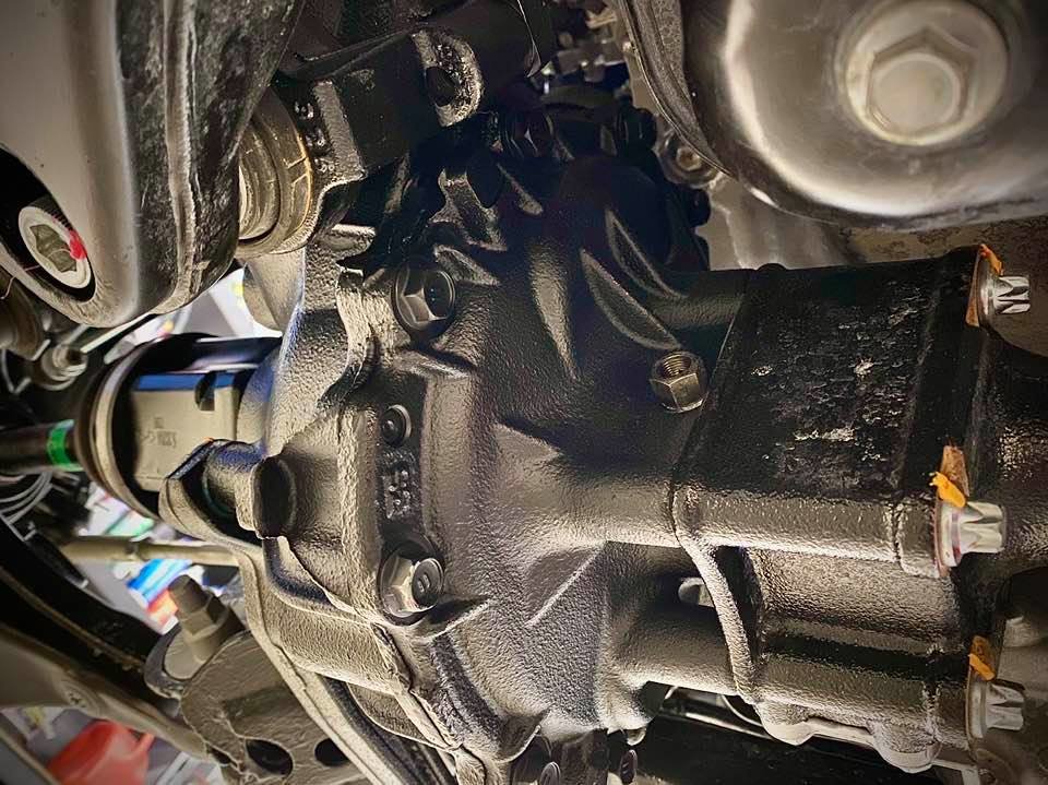

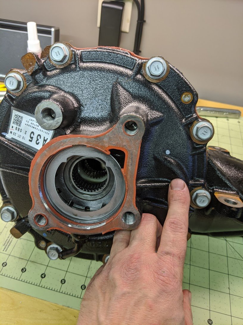

    Diff is back in the truck, can confirm, no harness for a temp sensor exists.
