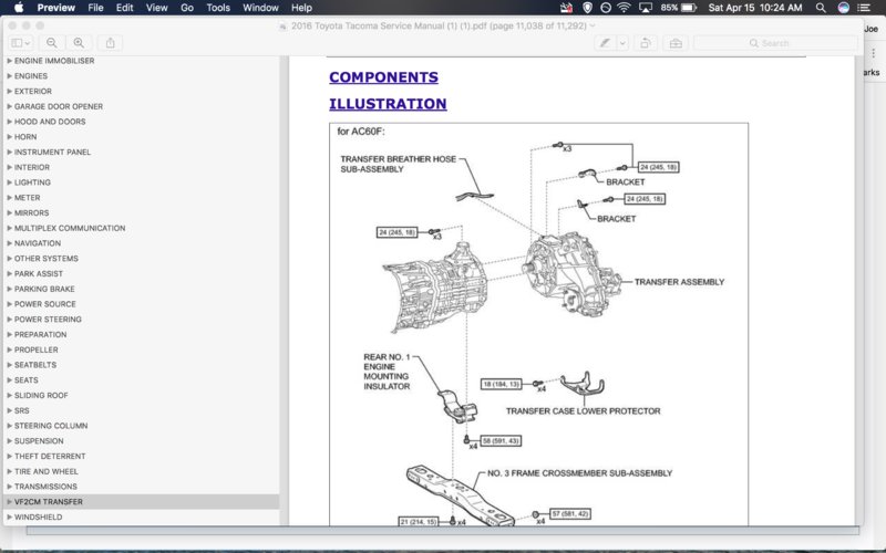

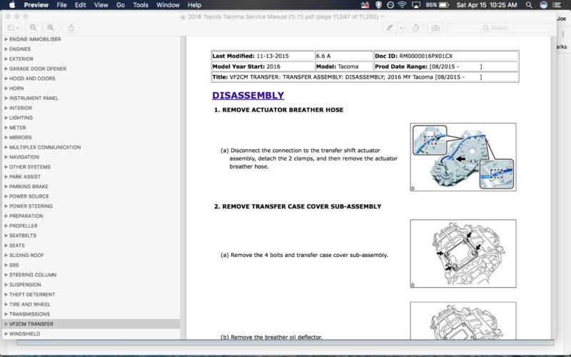

    what I can find
    Screen Shot 2017-04-15 at 10.24.23 AM.jpg Screen Shot 2017-04-15 at 10.25.32 AM.jpg

    I already found them...I made a video of it. Where did you get those diagrams?

    not sure if that's transmission
    either that or these vehicles are all fuckin different.
    From what I've heard in other threads these two are my front diff and transmission breathers. Right beside the fuse box in the engine bay
    one day soon when its no longer raining like it has been every weekend I'm just going to go under and find each one and follow where it goes.

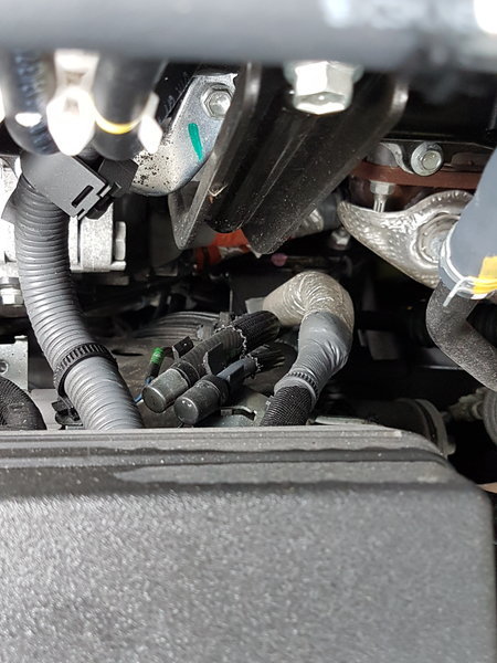

    Well I just looked in the area that @Steventura86 had on the video and we'll I have 3 of them. So I have 2 at the fuse panel and 3 at the rear of motor/ front of fire wall?? I he no idea what that tells you.

    it tells us that this car has too many fuckin breathers lol.
    I haven't checked the location from the video yet so who knows I probably have them too then.

    service repair manual
