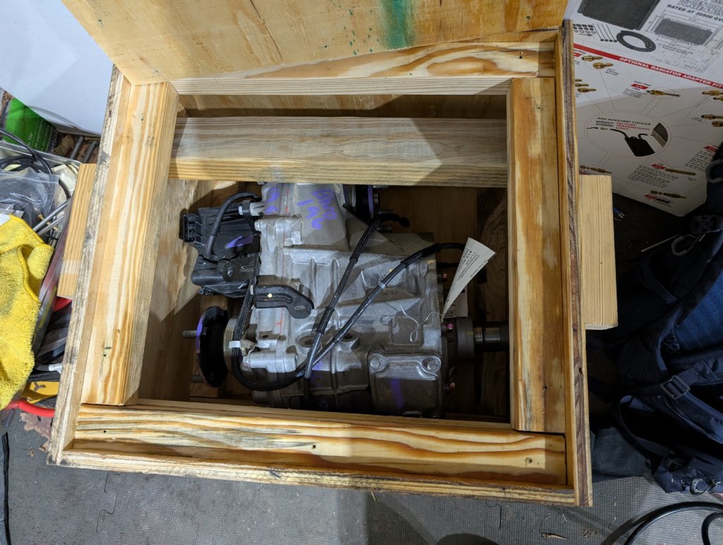

    Nope it didn't, I have a few options first I'm going to clean it and pull a few case half bolts and put some sealant on the bolts. I suspiciously saw drops coming from a few bolts and it makes sense since that's the least thick sealing surface. 2nd option if that doesn't work is pulling the actuator. Dropping the rear drive shaft and pulling the case back, cleaning and resealing the surface.
    3rd option came in the mail this morning

    Yes $300 shipped from a salvage yard 49k miles SR5
